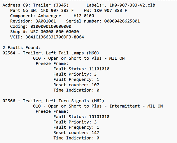

  4. The Yeti saw the towbar specialist. His diagnostics did not identify any issues! I did not manage to speak with the person who did the checking. I checked it on 2 trailers, our caravan and a light bar. This time all lights and indicators worked except for the left sidelights on all but the Light bar where the right sidelights did not work. A quick investigation identified that on the lightbar the side lights had been wired to the wrong side i.e. brown wire to the left sidelight. So at least i have a consistent issue with the Black wire (left sidelights). Car booked in at specialist again, this time i am taking the light bar so that they can see the black wire (normally) left sidelight does not work.

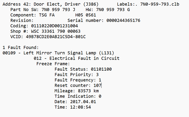

  5. Many thanks to everyone who has responded. I tried 2 additional trailers with similar results. What I also noted that when the indicators are on the caravan the side lights do not work on that side and if the indicators are put to the other side, the side light on that side goes off and works on the opposite side. Although the left turn error code does return each time a trailer/caravan/lightbar is attached, the indicator in the left mirror continues to operate. Though it dd not work when I tested it using VCDS! It is being seen by a well thought of local towbar fitter tomorrow. I will let you know how it goes. I would have liked to have checked the earth pin but the appointment has just been brought forward to 9am.
  6. We have just bought a second-hand 2017 Yeti 4x4 replacing our 2010 version. This was not advertised as having a towbar. However, there was a detachable bar in the boot and it has dedicated wiring (VAG). We have now checked the towbar electrics using our and caravan although they respond correctly - lights, indicators and recognition of the trailer when reversing, the repeater click was very fast when indicating left indicator and a message "Trailer check left turn signal" was displayed. I then tried a trailer light bar and again the lights worked but neither of the indicators worked and the same message (I have checked that the light bar works, using my Superb with non-dedicated towbar wiring.) I ran a VCDS scan and the following errors were noted These could both be reset when the caravan was disconnected and did not recur until either the caravan or my trailer lightbar was attached. I have booked the car to go to a local towbar fitter to be checked (both detachable towbar and the electrics). Any thoughts regarding what the issue could be would be appreciated? Could it be a Coding issue? Many thanks
