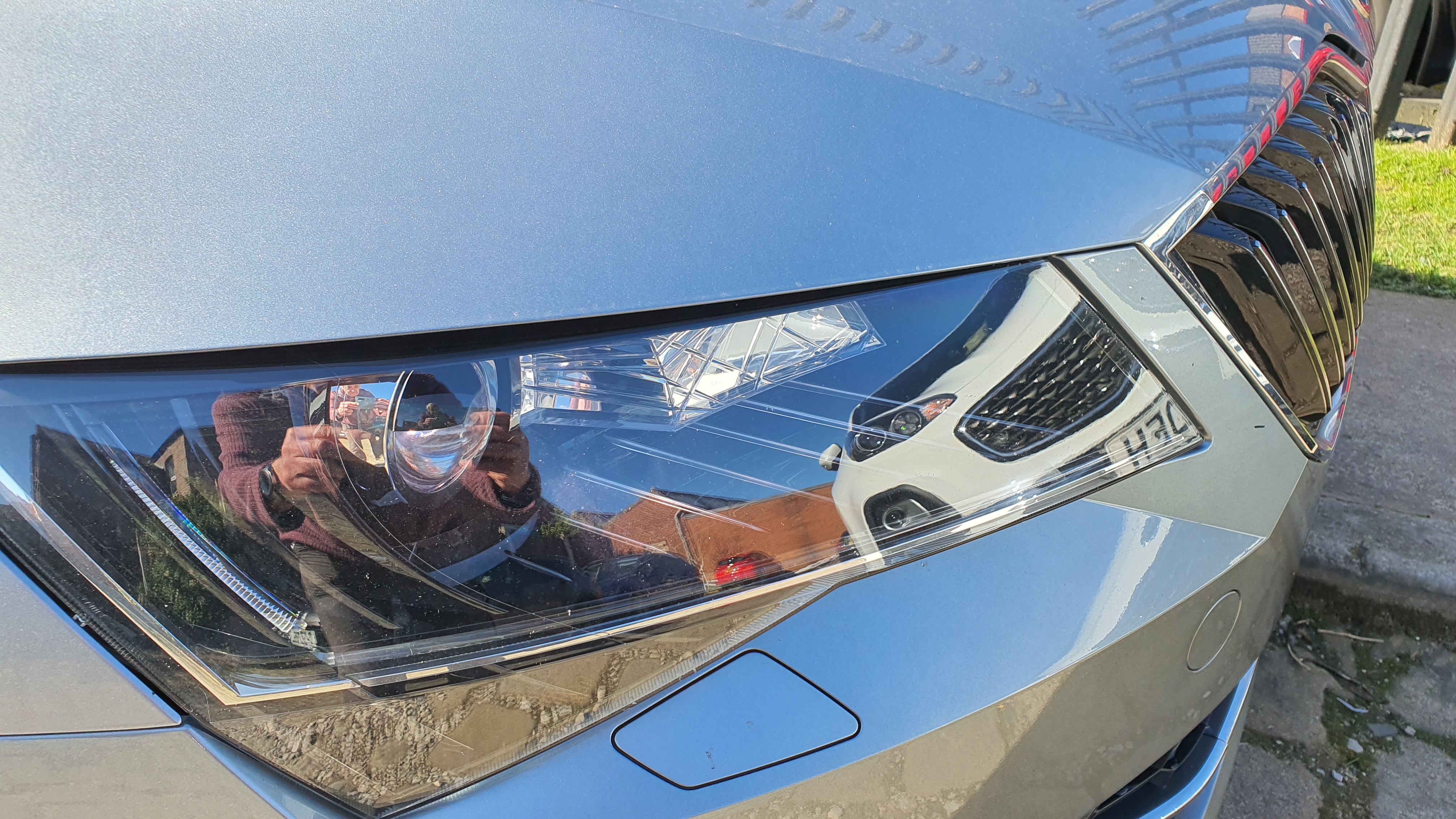

I've been looking at buying an S3 L&K estate and hoping to find one with SLA. The photo is from a car I'm looking at but having only recently discovered that SLA is only a £100 option on the L&K it would be nice to have. Looking at the headlight with lights on it was difficult with bright sunlight and reflections to tell whether the "eyelashes" lit up or whether they were just chromed. Any opinion appreciated. It's a 2017 67 reg. Also is there any way tell from the reg what was the spec from the factory.

Thanks both. I hope to be looking at such a car tomorrow and I can't see SLA listed in the features list. I suppose though that there's so much tech in the car that they can't think of and include everything in the list.

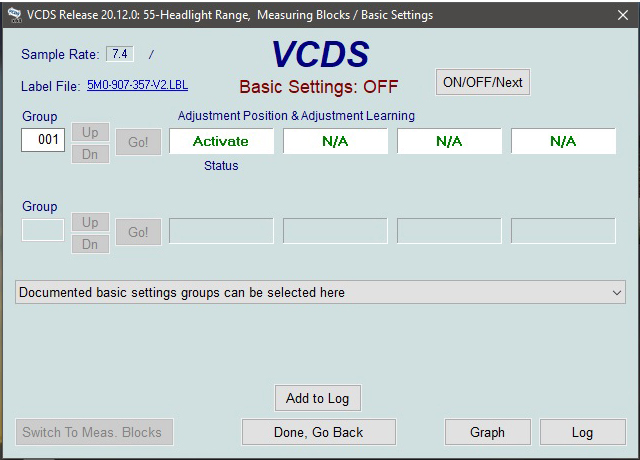

Well this is embarrassing. No matter when I put the switch to auto the headlights are now dancing for me. I have no idea what I've done to make this happen but I'm starting to doubt whether there was a problem at all and langers is right and I just missed it. I made a point of looking for it on numerous occasions and even now I'm convinced it didn't happen. Oh well
Yeah I wondered that too. I'll test that today, the garage is dark enough for the lights to come on in auto
Thanks chimaera. Something is strange is going on. After playing with VCDS and the lights I decided to put the car in the garage and stick it on charge. Late last night I thought I would try again (with the headlight switched already in the Auto position) and I couldn't believe it when the "dance" happened. The nearside light seemed a bit low compared to the other but who cares. I normally start the car then switch to Auto to turn on the lights, I don't know if that makes a difference, but I'm sure the lights would do their dance anyway, I think I'm clutching at straws here, I don't know. All I know is they stopped dancing after I had the problem with the sensor and now (last night anyway) things seem to be working again. The only thing I did yesterday was play around with VCDS, without actually achieving anything, and I took out my new bulbs and put them back in again as a last straw. Hopefully everything is back to normal and I just have the ventilation flaps to sort out now (according to my VCDS log) Thanks again everyone

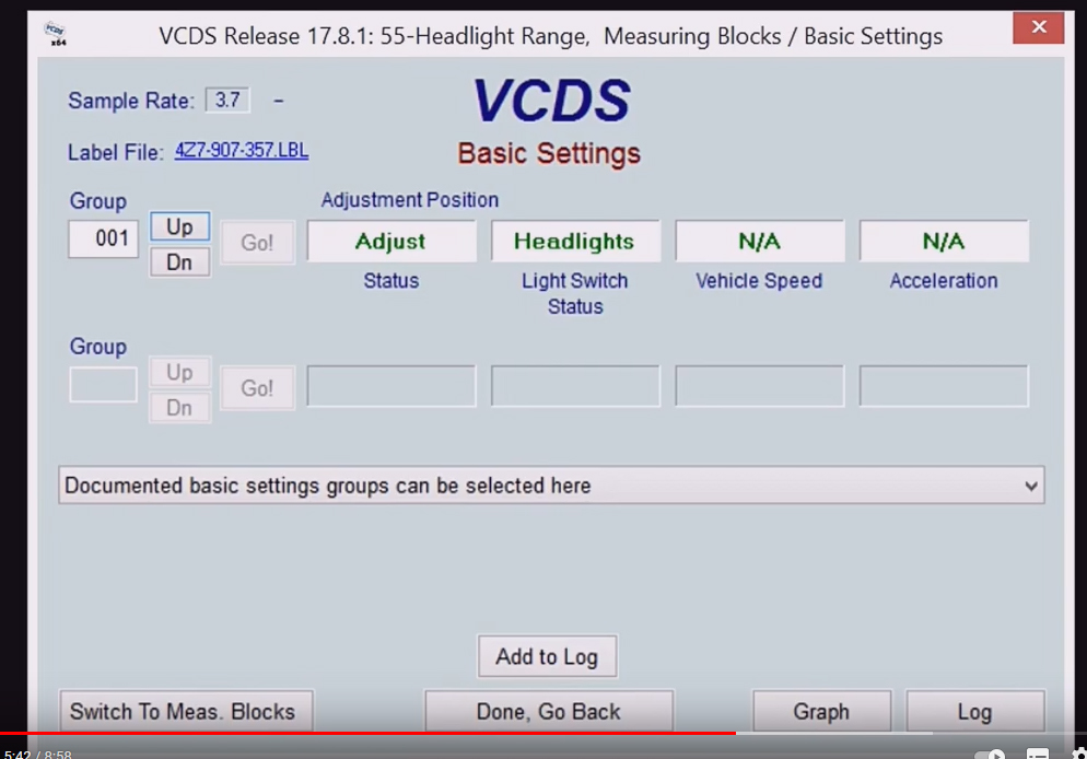

Thanks Langers, how do I do that. I keep trying the dance but I get nothing. I've checked the sensors again and they are fitted correctly. There are no error messages so I just don't get it. I misunderstood the YouTube video. I thought it was going to adjust the headlights for me, obviously not. Like I said previously I'm 99% sure the lights were moving as I was driving
