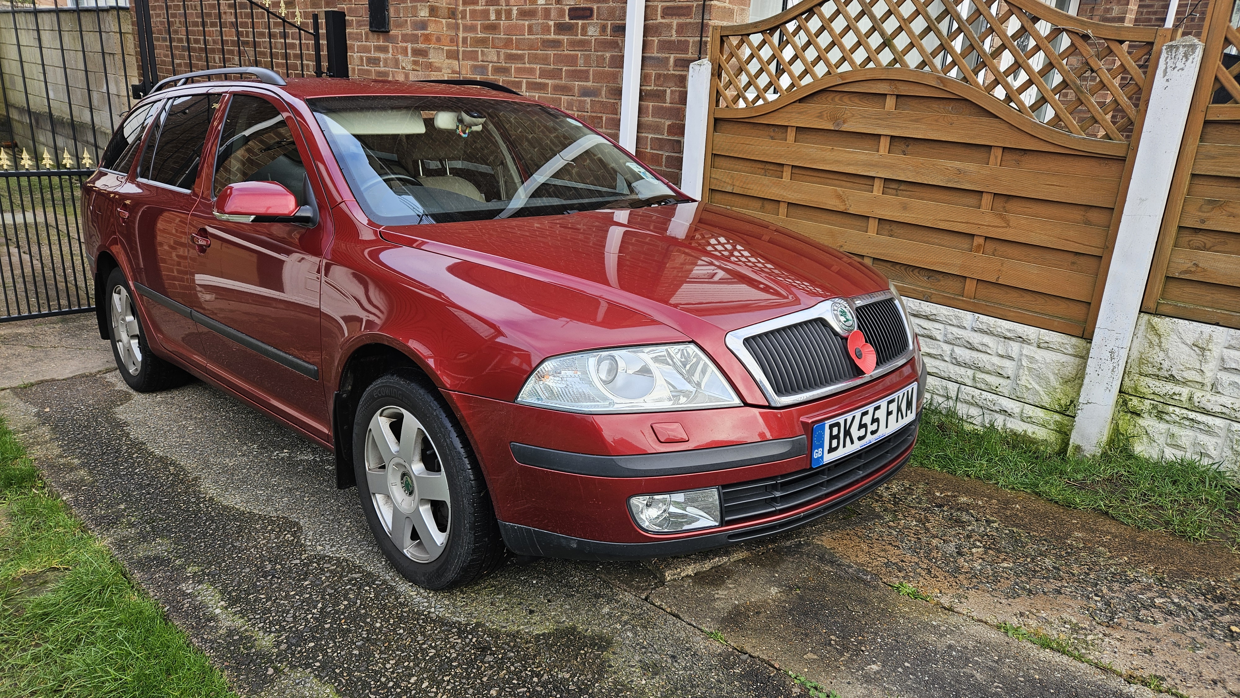

  2. Just to update on my original post and the update post above. Ive replaced the alternator pulley, that's that sorted. I did the revive turbo cleaner. Worked well. I've not had the overboost fault return and it's been a good 3 to 4 months and 4'000 miles. Lumpy idle has also gone. I still get black smoke on full acceleration although maybe a little less. Turbo still make sure noise although not as bad. Passed recent MOT so smoke not bad enough to fail but is mostly noticeable at night in headlights of the car behind. Service is now due so plan to give it a full service and another revive clean and see how it goes from there.
  3. Thanks for your response. I typically get 40mpg urban and approx 50-55 on a run

  6. Hi all, it's been a while since I've posted but this one is doing my nut. Bought this Octavia estate 2.0 TDI BKD L&K from an old lady a few years ago. It's a 2005 and only had 21k miles. It's now on 53k miles. It's had 3 services and a cambelt change in my ownership. I did the full service with all filters and timing belt was at approx 40k miles. I have a few things going on which have kind of developed in a short period of time of each other. Firstly. Last MOT, August 2023. The tester was doing emissions and I could hear a loud blowoff sound after each acceleration. I'm an ex MOT tester and never noticed this on 2.0 tdi's before but can't really hear it very well in the car. Also, it only just got through on the emissions as it was black smoking a little. Since then the smoking has got worse and if anything I think the power has increases 🤷🏼 Then came the rough idle. But again, still running sweet. I've only recently started looking into the issue ready for next MOT. I've done some data logging with ODBeleven and I've found the peak specified boost is 2300mb but actual peaks at 2600mb! Everytime on wide open throttle. I've read that 2600mbar is the maximum the ECU or map sensor can read so it's likely the actual value is greater than 2600mbar. Initially I thought sticking vnt but I've checked and the actuator rod seems to move ok indicating the veins are not seized. I've removed the egr and shudder valve and gave them a good clean. I've then done basic setting reset on egr, fuel, and boost control but still the same. The torsion value is bang on 0.0 and drops to -0.5 with a quick review so all ok there. The I do have the typical siren sound which actually also kicks in when carrying out activation tests on egr at idle or low rev. Finally, I have some readings taken at idle and engine up to temp. the fuel deviation values for idle are as follows Inj 1, -0.66 Inj 2, 0.19 Inj 3, -0.14 Inj 4, 0.61 Inj quantity 3.84 mg/h Fuel temp (G81) 80.1°c Coolant temp G62 88.2°c Boost pressure requested 1020mbar Boost pressure actual 1040mbar Ambient air temp 17.4°c Intake air temp 37.8°c I believe a deviation of +/-0.5 is tolerable but I'm not sure of what value 🤦 Now, with all of the above in mind I'm thinking down the lines of the N18/N75 valve block ,part number 6Q0906625 as this controls turbo and egr but it's a wild guess based on absolutely nothing 🤣 Any help or advice greatly appreciated Thanks in advance
