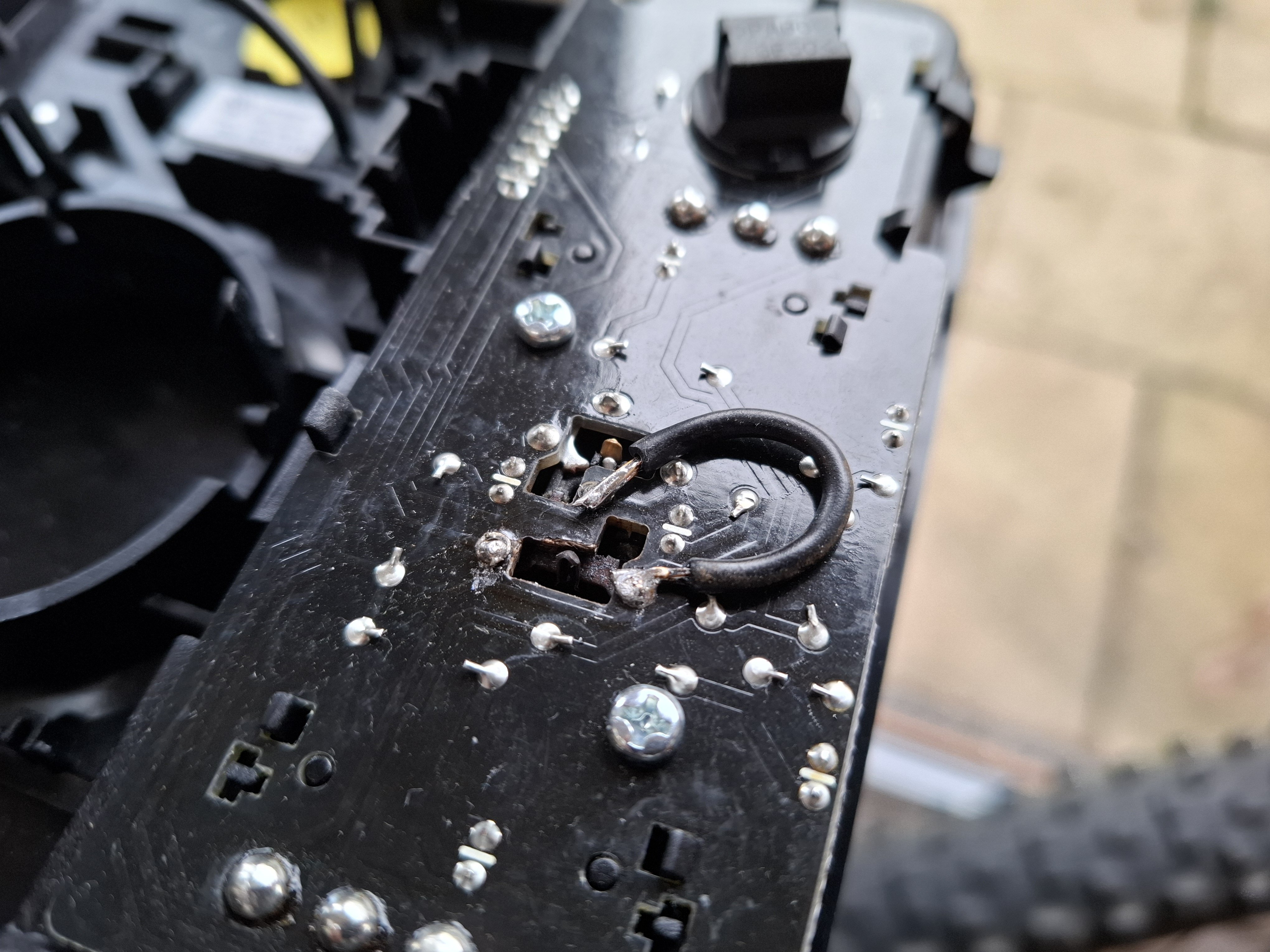

  3. I had this problem with my 2014 Octavia. As above, the rocker switch in the overhead panel corrodes. The problem is they all do it, so a replacement part from a breaker is likely to be the same, although you could be lucky. My fix in the end was to solder a jumper cable onto my existing failed switch. I'll have to do some digging to see if I can find the details but it worked and is still working!

  6. I just thought I'd add my experience with this problem. As others have described, the interior lights started to become intermittent, and eventually failing altogether in the 'door open' position. They always worked in the 'on' position. I noticed that pressing the switch lightly would make them come on with the door open. Which is no use in the dark when you can't see the switch! And sure enough, the switch was corroded and/or burnt, and was never going to make a good circuit. So, inspired by L9ppy's post: I found myself a short length of wire, and soldered to the pins as described, and as these photos. Works perfectly now! And it still works in the off and on positions too, contrary to what L9ppy says. Maybe I've used a different pin?
