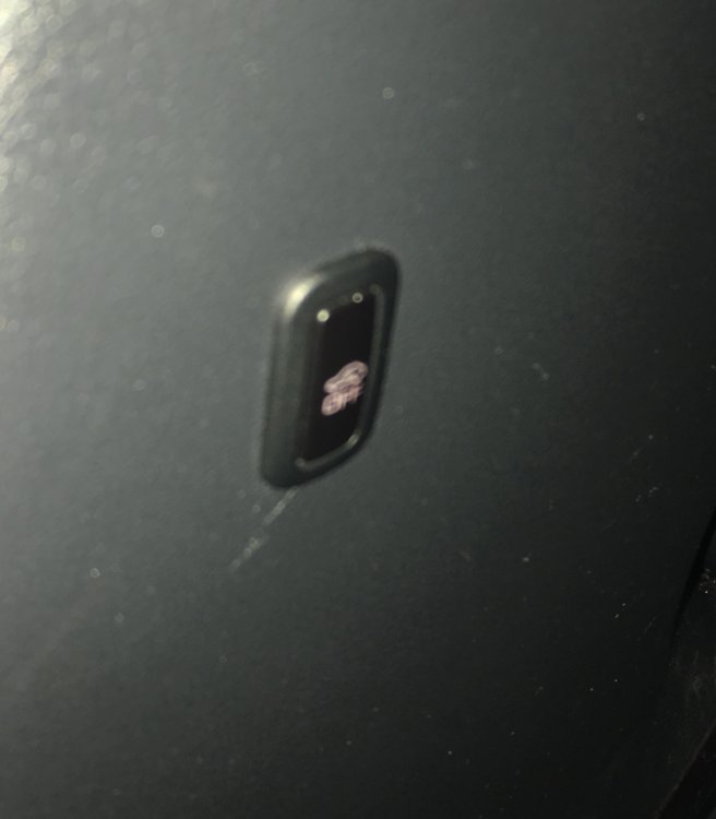

 I assume you mean this switch?
Doesn't appear to be stuck.

That's to do with the alarm system
Yeah, this button is used to disable the car's internal alarm sensors.  You should press it (it will illuminate) if you are leaving the car locked with people/animals inside it.  Note that you need to single press it each time before locking the car, ie. if you've already done this once, but come back to the car and then wish to lock it again, you must press this button so that it's illuminated again before locking a second time.

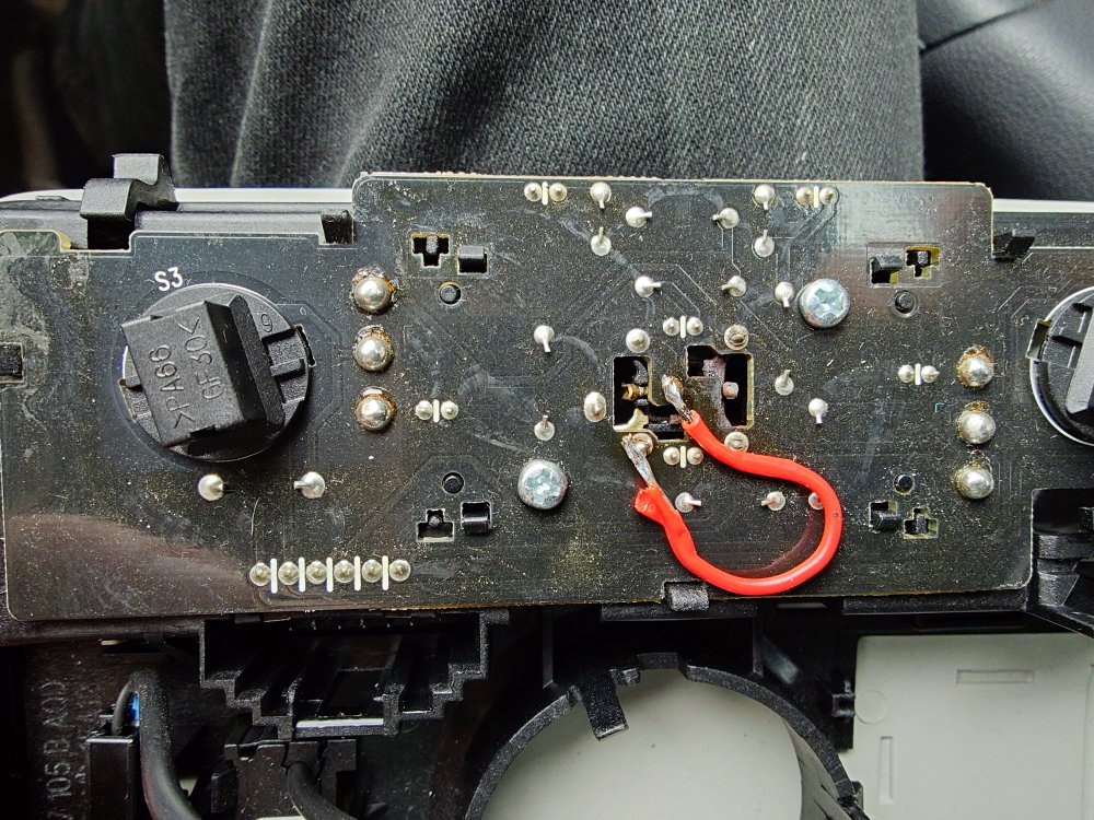

I’ve got the same issue in my Skoda. Just opened the courtesy light and identified corrosion on the circuit board that reads the position of the rocker switch.
The circuit is simply not detecting that you have the light set to switch on when the doors are open.
It might be possible to scrape the contacts and/or add some solder to resolve, but I’ll be looking for a replacement unit as the best fix.

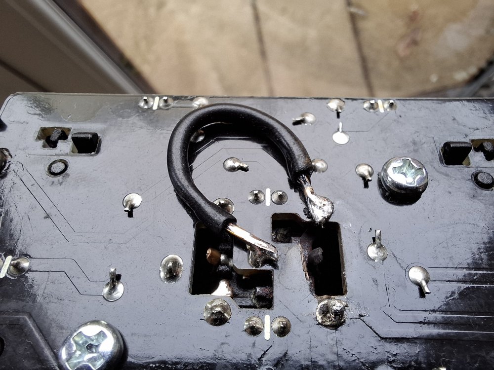

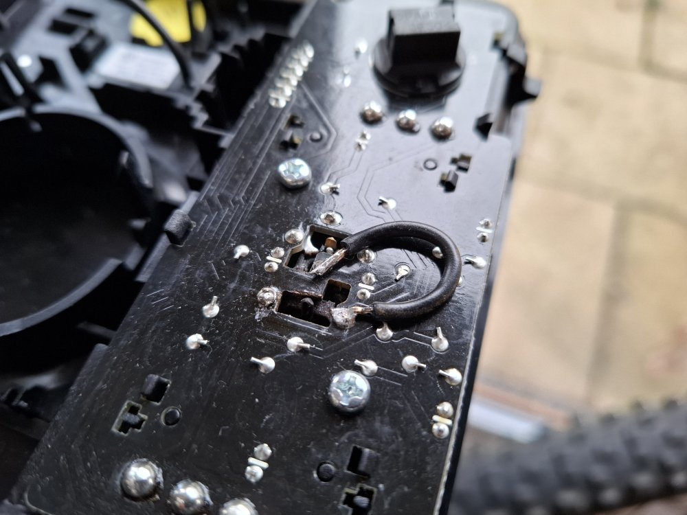

I have repaired it by re-soldering the pin connections - not sure how much of a long term fix this will be to be honest. I looked at replacing the unit and was quoted £160 + p&p.

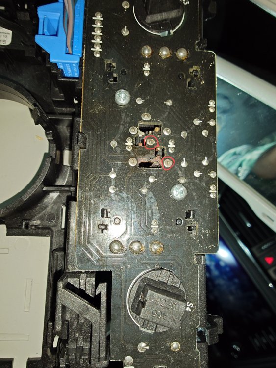

Can you tell me if you just re-soldered the top of the pin so it matches the "good" pin.
As you can see from my photos, one whole side of the switch mechanism on mine is corroded. I have tried cleaning it up with a small screwdriver and electrical contact spray but it didn't make a difference.
