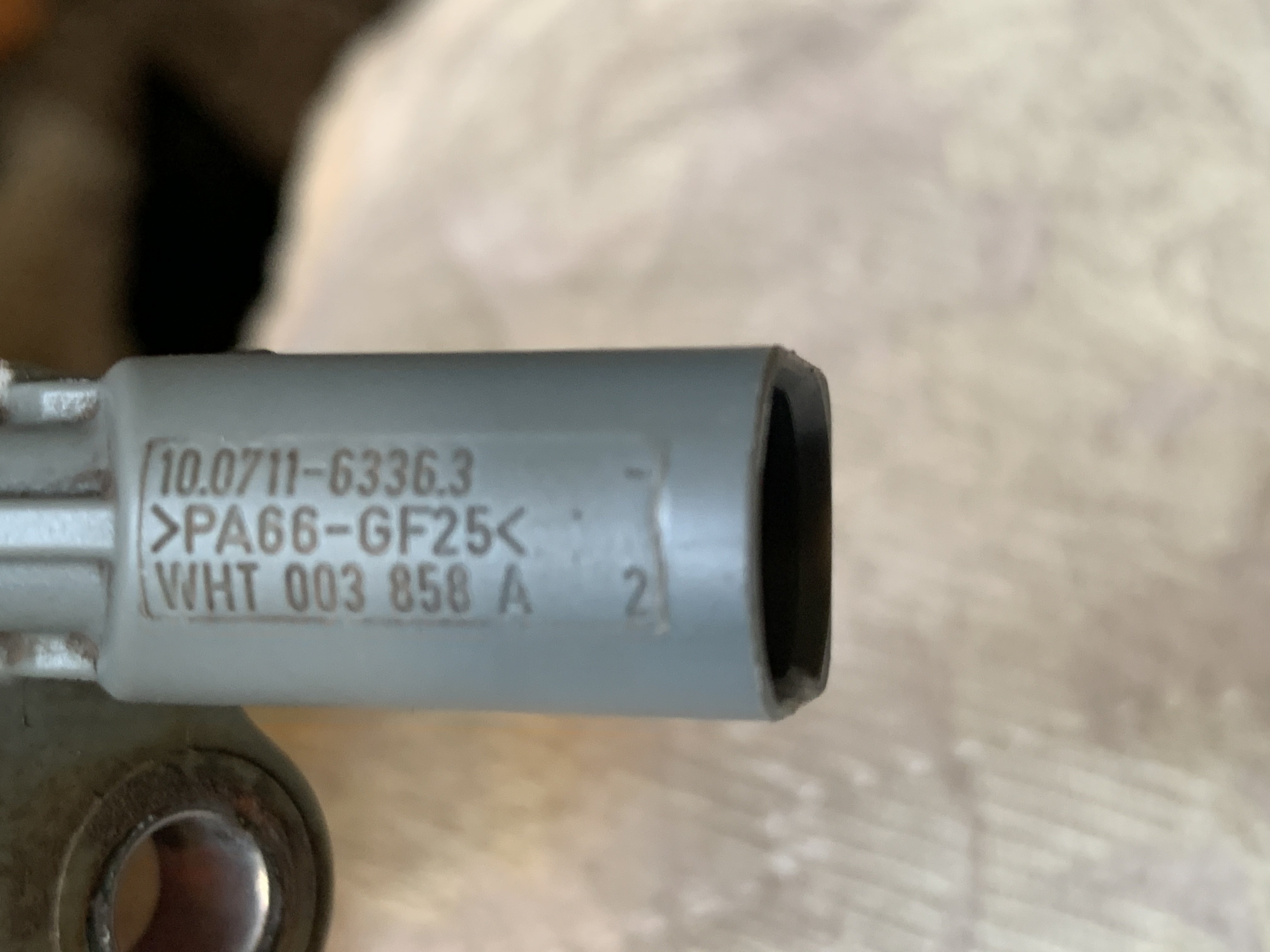

Afternoon all. A wee issue with the Superb which the diagnostics told me is a bad wheel speed sensor. Ordered one from eBay and fitted it today. Still have the fault codes which was confusing but a bit of research showed me there are 2 types, one for cars with park assist and one without. It turns out I do actually have park assist (who knew) which means I got the wrong type of sensor. I got the black one and need the grey apparently. looking at the one I took out, which is grey, has a part number of 10.0711-6336.3. I can’t find this anywhere. Another part code I have is WHT 003 858 A. The only close one I can find starts with 24, not 10. EuroCarParts do list both, but £64.34 is beyond stupid for such a part. Are there any alternative suppliers that do the ATE part? ATE make the OE ones from what I can tell so that would be my preference Thanks
