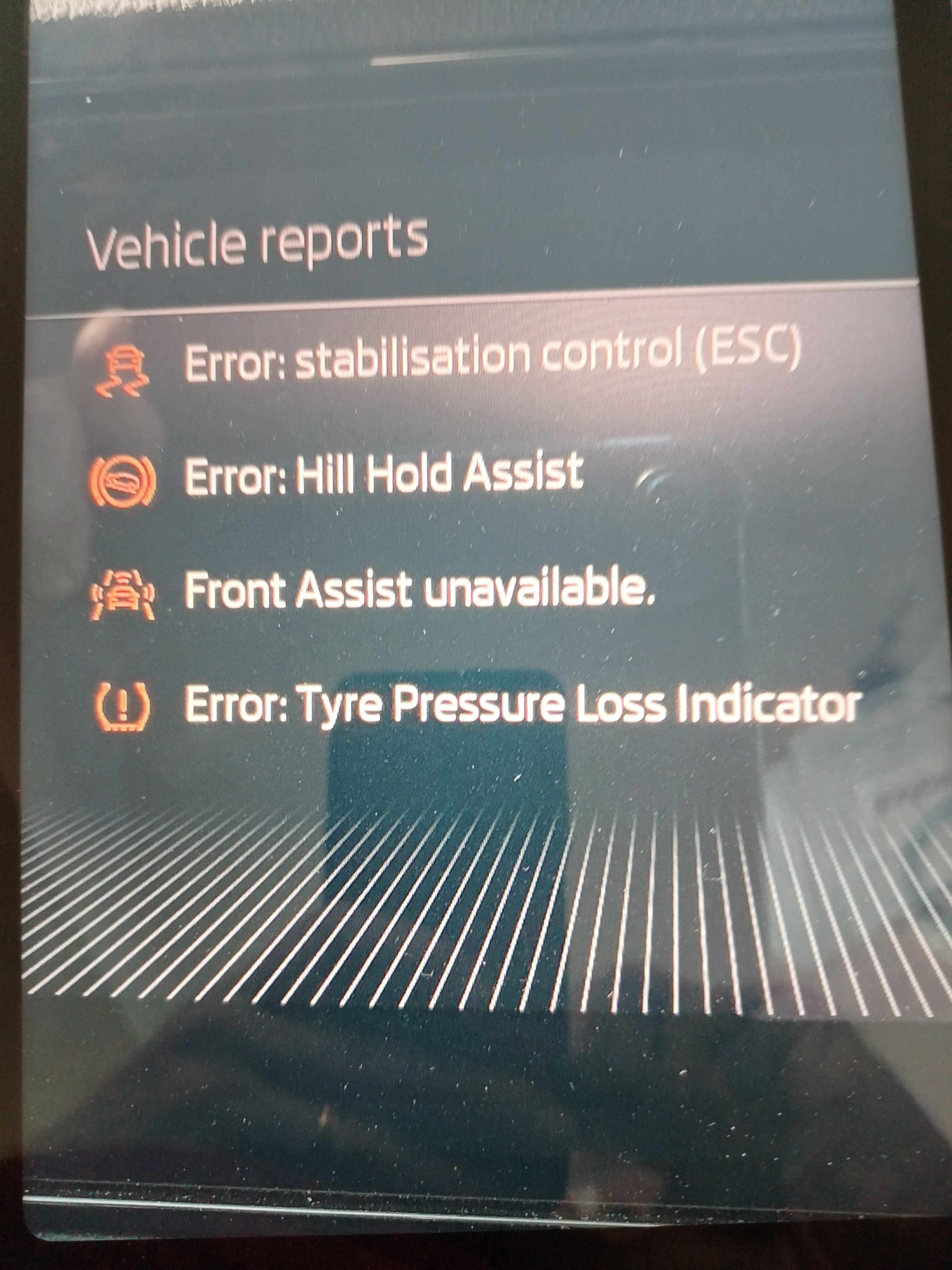

  1. Thanks, that is exactly what happened, looking at the codes, there appeared to be an connection to wheel speed this could well have been stored in memory for initial comparison. I generally have a small 12v battery connected to the terminals, sods law I didn't have it today. Thank you very much for your response.
  2. Hi, just changed the battety, 2nd one in 7 years, first time around, no problem, this time I get Error: stabilisation control (ESC) Error : Hill hold assist Error : Front assist unavailable Error : tyre pressure loss indicator Anybody know if these systems are linked with a common fuse? Handbook isn't much of a help. Any assistance greatly appreciated. Jonah
