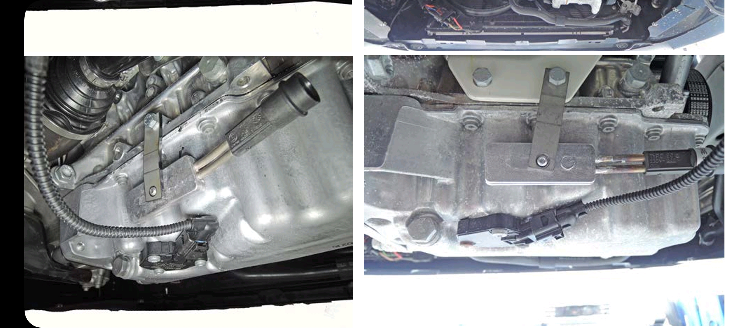

Hi, I have a late 2019 Fabia MK3 1.0 TSI that I want to install electric heater in. Does anyone know if its possible to circulate the coolant with an externally driven pump when the car is turned off? I have installed a heater inside the car to defrost it before I have to go but it's quite frustrating not to have an heat for some time before the engine get up to temp, which it can struggle with when it's really cold. I have looked at both Calix and DEFA who are the big suppliers of heaters here and the only solution they offer is a heater block that is screwed to the outside of the oil sump, and basically do no difference. I would like to buy a water heater and install byt they say the car either will throw codes because of the temp differences in the system or it will not have any circulation due to several thermostats.. In willing to give it a try mounting a heater with built in circulation pump if the cooling system is open when the car is off allowing the coolant to circulate. Does anyone know if it is possible to circulate the coolant when the car is turned off or is there thermostats or valves closed when the car is off? I have tried to find workshop manuals in order to try to see but haven't found any. Tia!
Activate electric water pump when car is off - electric engine heater Fabia 1.0tsi
This is the solution DEFA and Calix provide, and to me it's just plain stupidity as the heater itself will radiate most of the heat to the air and then the sump will radiate a lot as well.

It's not insulated at all, the instructions tell you to cut away insulation a couple of cm around it if the sump is insulated from factory. I replied and asked what the reason to bot insulate it is and they said that insulating it will cause it to overheat and melt. So I'm my opinion you will not get close to transfer even most of the heat to the sump as a large portion will radiate away. It would probably be more efficient with a 150w heater that's insulated on the outside and not rely on contact heat transfer on only one side of the heater. To me it just sounds like they only care about keeping manufacturing costs low and profit high as no one in their right mind would think their solution would be energy efficient. So it might be possible to activate that pump alone depending on the control circuit and assuming there's no need to activate anything else to open any valves. I'm only interested in heating the engine and not the inside of the car as I already have a heater for that, but it would be nice to have the engine pre-warmed to get it up to temp quicker and less wear on the engine itself.

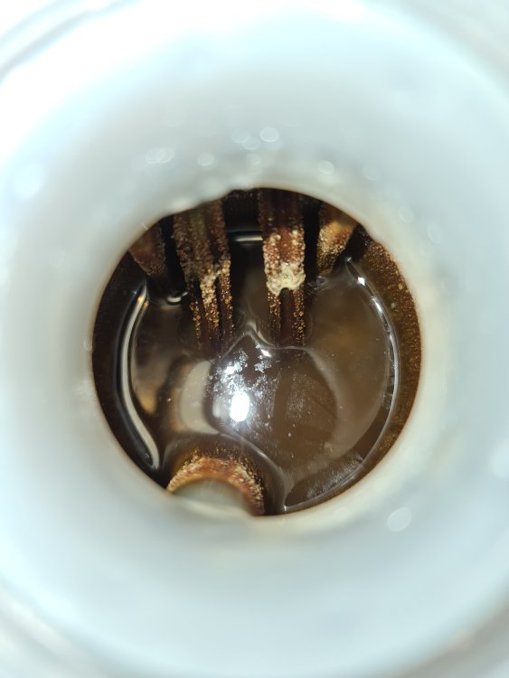

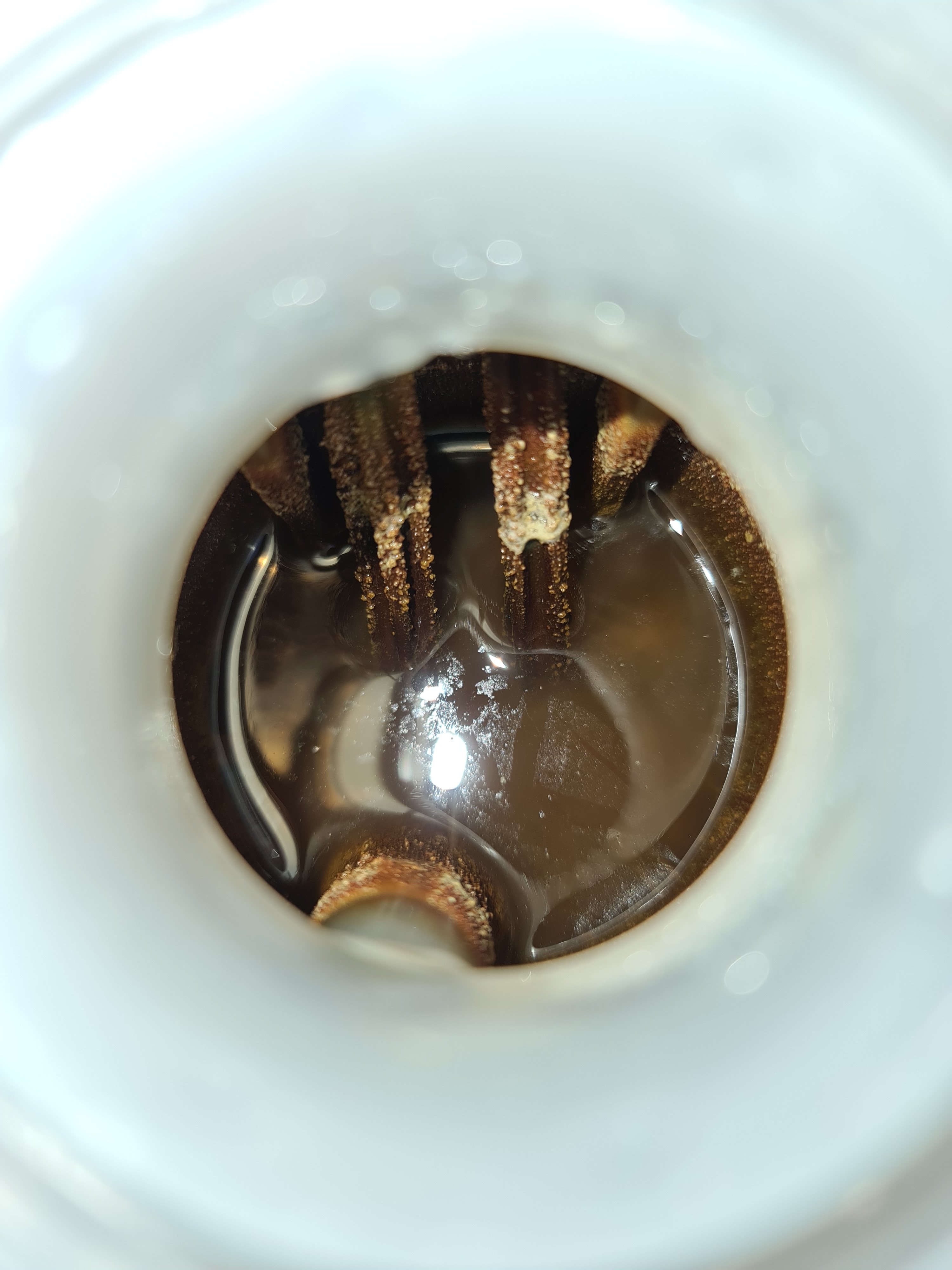

Hi, We have a my17 Octavia 2.0tdi 150 DSG with 60000km on it. I was having a check under the hood and noticed that the coolant is dark brown instead of red and have a lot of oxide or other contaminations in it. I stuck my fingers in it and it feels mor or less like normal water, and not quite as slippery as antifreeze usually feels. The car was serviced 4 month ago so I went back to the stealership who said this happens easily on diesel engines, but he couldn't tell me why when I questioned that as it's a closed watersystem and not like the oil that usually get sot in it. He continued to tell me that the only check in the service is checking the freezing temperature of it.. He told me that I can let them change it if I would like, but I don't think that's gonna happen. I'll go somewhere else in that case. Any how.. Have anyone had the same issue? Don't know if they have mixed different coolant types or if it might be oil in it? The oil is normal and no trace of water in it. No smoke from exhaust and it runs fine. I have never experienced coolant going bad so to say and changing color. The car is going to another stealer In a month as there is no hot air on the passenger side.

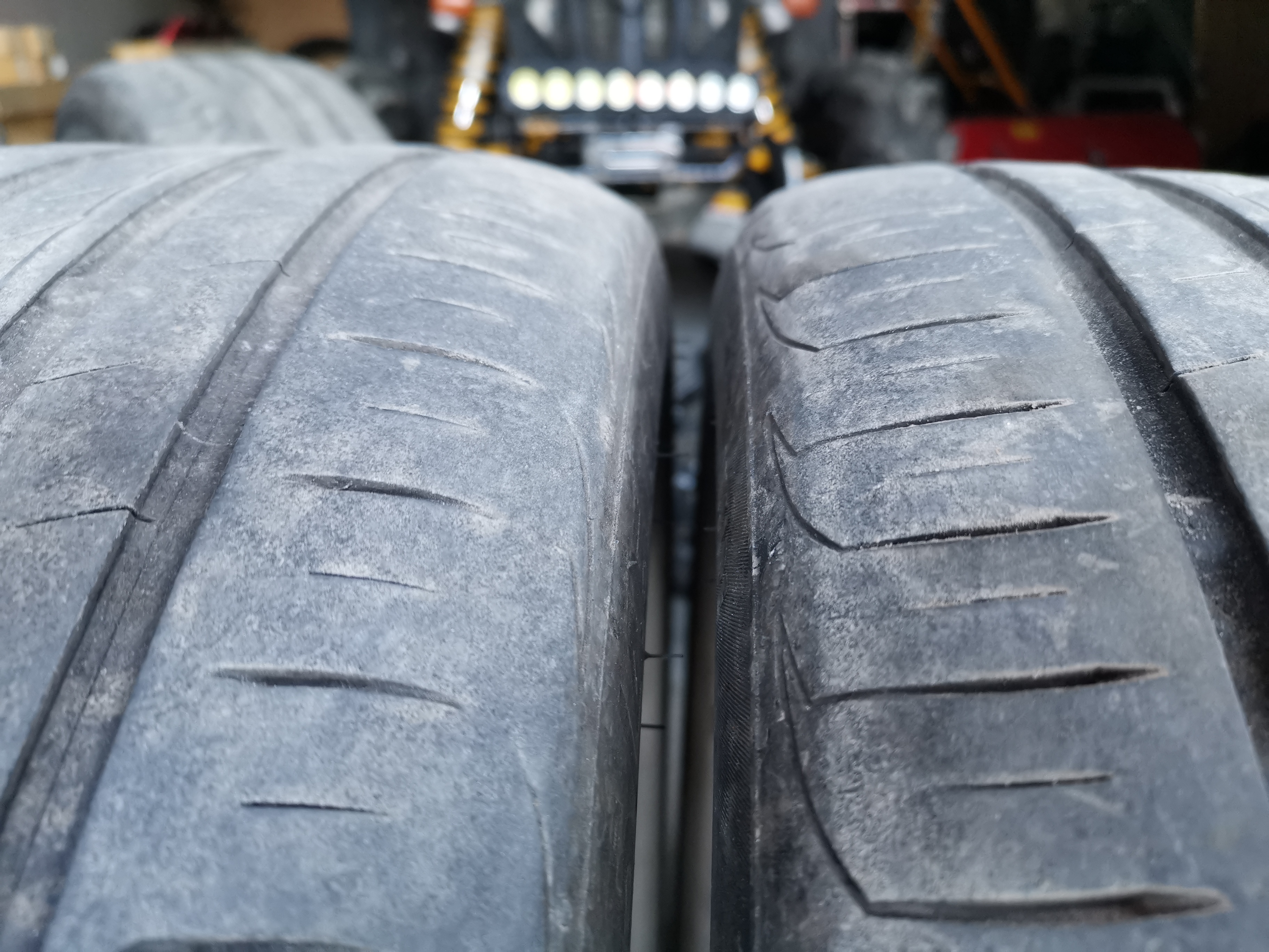

Hi, I changed to winter tires yesterday and discovered that the front tire on the left hand side is worn pretty bad on the inside edge. I would say this is due to camber problem but is it possible to change camber on the MK3 (non-VRS)? We've never had an accident happen or anything else as far as we know. Only thing that's been done is that I changed the wheel bearing before the summer on both sides, but nothing can be put back in the wrong way as far as I know, and when I check everything looks fine. The bearing looks like it's in place and I can't see any gaps between the bearing and the hub/spindel (correct name?) but I haven't removed the brakes to inspect it closer. I feel like the breaks should show sign of wear if it saw the bearing as well as the disc would be out of line in relation to the pads as well, if it was something wrong with the bearing. Tires have done 2 summer seasons and the picture show both front tires.
