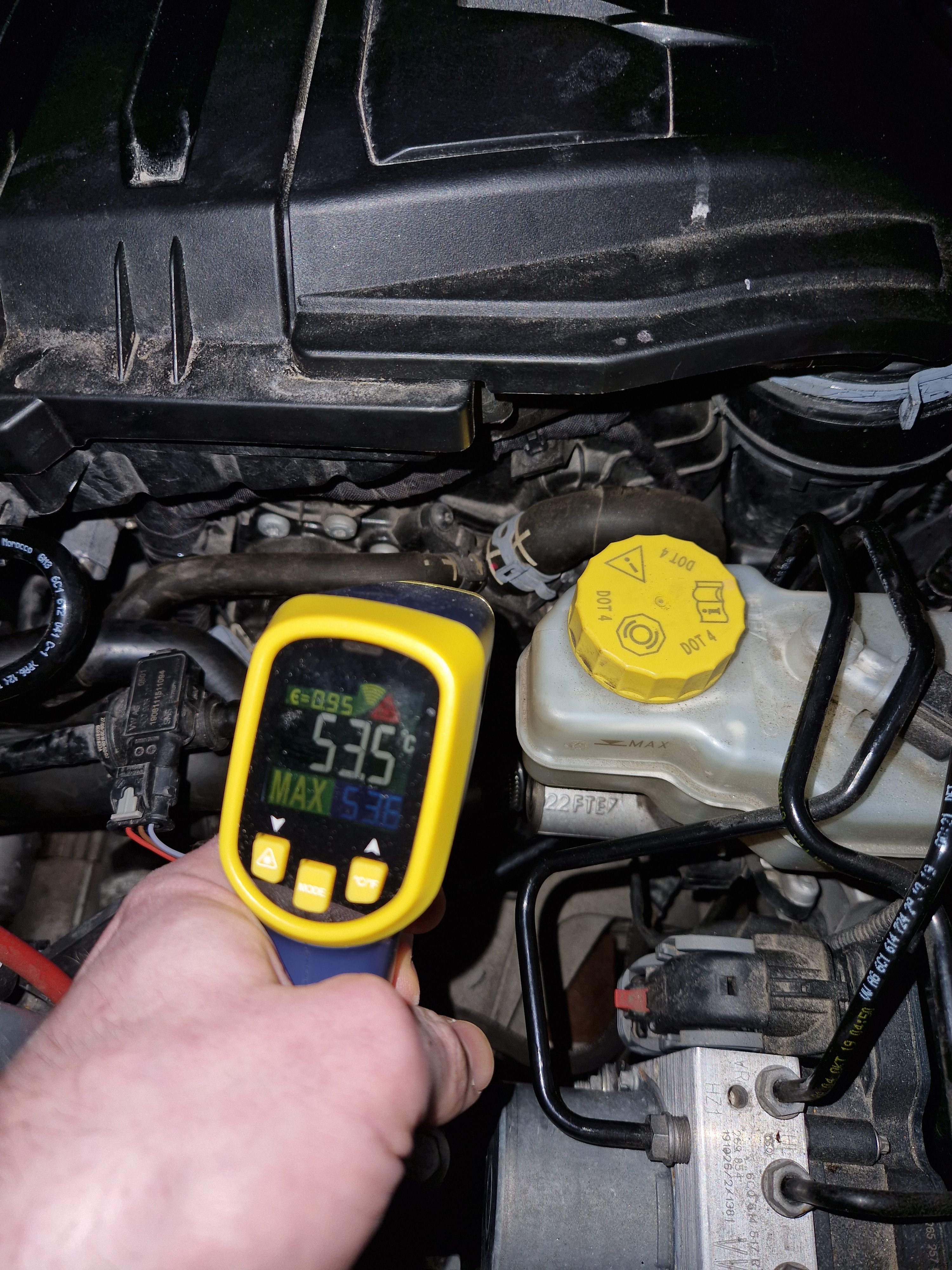

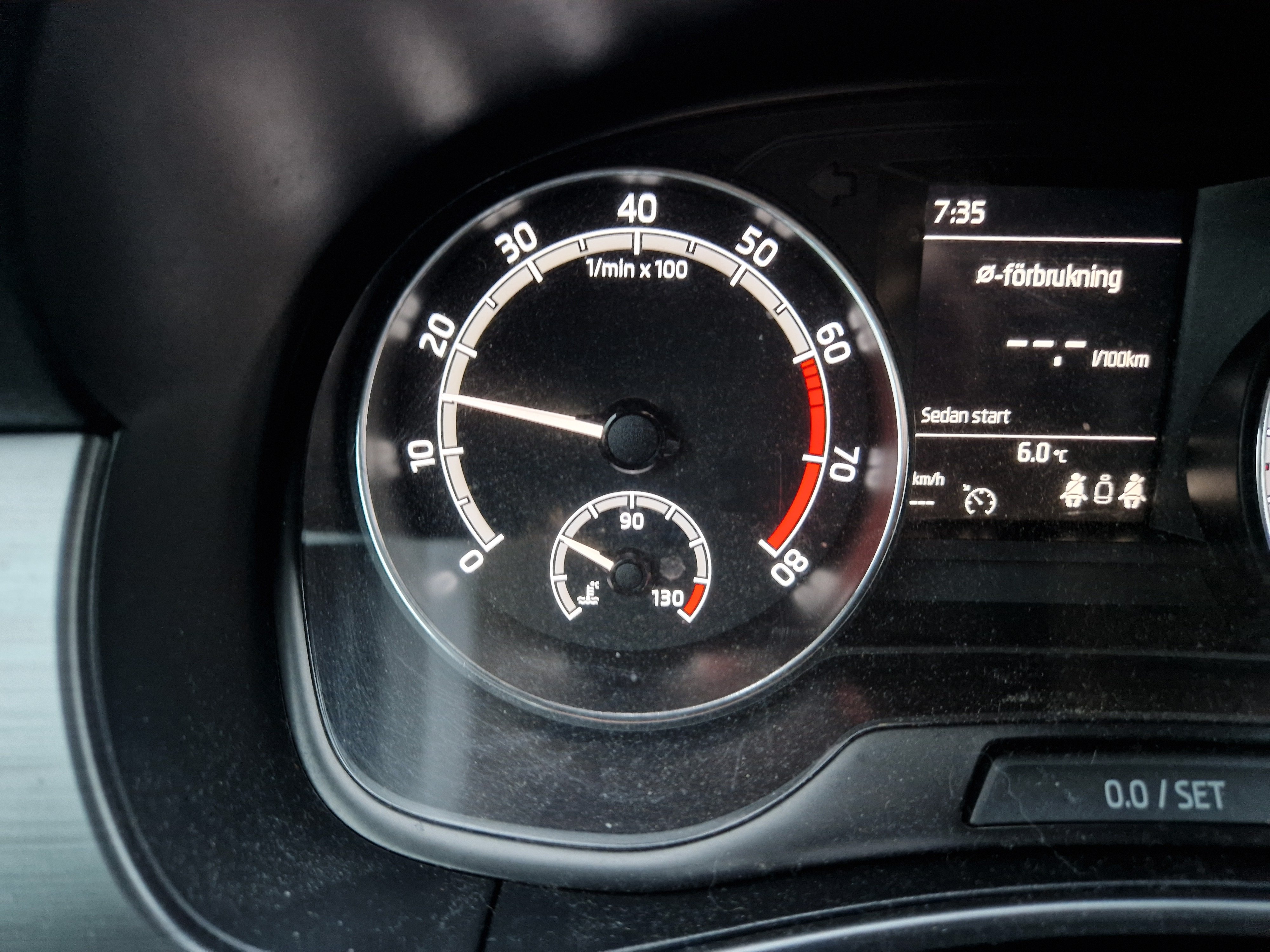

I think I might have read it somewhere now that you mention it. Did a quick temp check when I was about to pick the kids up from school. Was around 6⁰c out and the heater thermostat hadn't shut it off. Temp gauge showed 55⁰c when I turned the car on, if one would assume it's linear scale

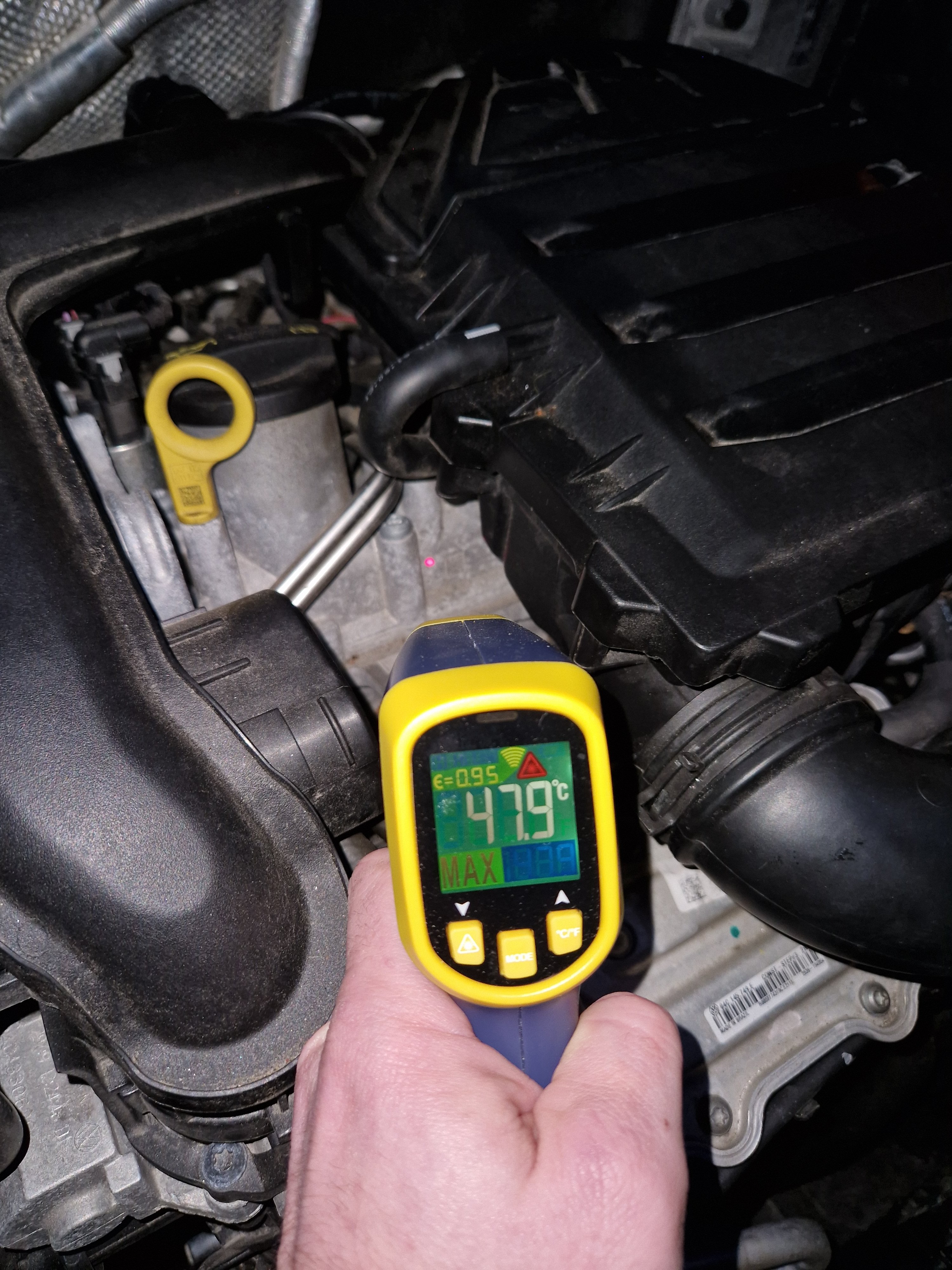

Update #2 This morning was a bit colder with a ambient temp of -3⁰c. Ran the heater for 1h together with the coupe heater. Water temp was 65-70⁰c but almost instantly increased to 75⁰c when I started the car. It reached a water temp of 90⁰c within 2km/3min and oil temp of 50⁰c within 3km/3-4min. It heat up faster even though it was colder outside but it's probably due to it pumping the hot water in to the engine first and running for longer before it will reach its shut of temp. Never thought it would be so effective. It will be really interesting to see how it performs when the temperature drops even lower. I can also notice that the fuel consumption is an low I can get it doing the school drop off route during the summer. 5/5 recommend

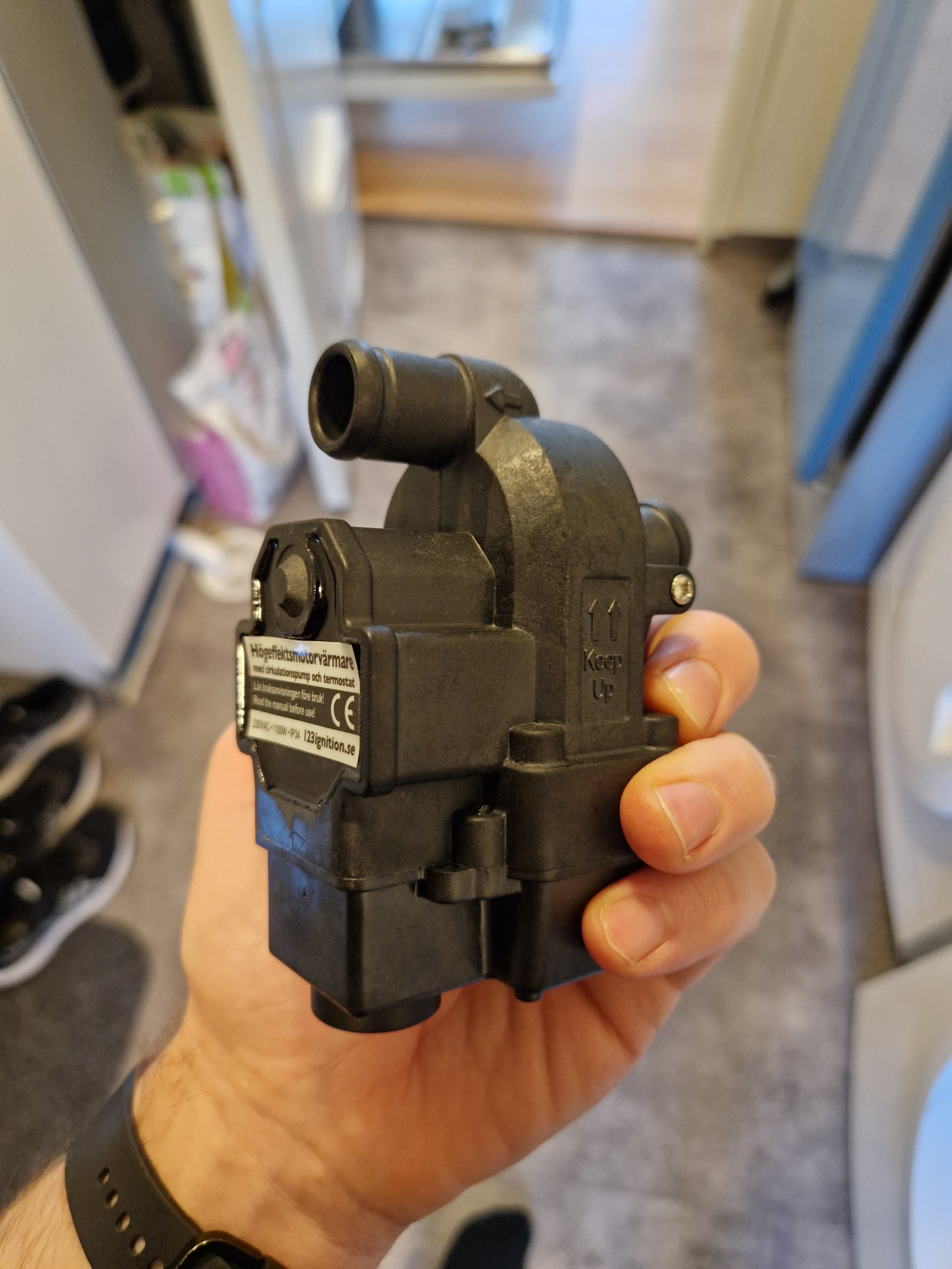

Thanks for all your input, here's an update. I had a good look on the good ol interwebs after a good heater. I found cheap 1500w ones from china being sold all over amazon and other websites, or there were a few other options with Russian name and text on them but they are easily found directly on Chinese sites as well. I didn't feel like putting some no-brand china unit in the car as the consequences of a malfunction would be severe. Found this one sold by a small Swedish company, surely imported somewhere from china as everything is, but at least I will have protection through Swedish consumer Laws if something were to happen. It is 1.1kw with built in pump, cost equivalent to £130 with shipping, feels like good build quality and it has a serious electrical connector made for pre heaters and coupe heaters, and I already had a heater inside the car using that system. I went ahead and mounted it on the hose between the expansion tank and connector on the hose between engine and heater matrix with the thought that the water would have to flow through either heater matrix or engine. First placement didn't work as a problem with air inside it occured, fortunately it survived as I realized this risk and and filled the heater before mounting it. Moved it a bit on the same hose to a better location where the air would escape easier, and this time it worked, but... It isn't clear in the flow chart, but the water doesn't have to take its way through the engine or heater matrix, it just "turned" the wrong way and returned to the tank through the water pump and return hose, so nothing got heated apart from the water in those two hoses and the tank. I got mad and yesterday I finally relocated it to one of the hoses between the engine and the heater matrix. Made room in the garage, put the front end on stands, got under it, removed the plastic underneath the engine, squeezed my hands in to the tiny space where it could fit and got to work. Many swear words and some coolant in the eye later, I got it in place. Tested it this morning, it ran for 40-45 minutes before reaching it's set temp where it stops until the temp drops. I got in to the car and to my surprise the coolant temp read 75⁰c. It was +4⁰c outside (car says +6⁰c in picture but that's due to the heater, and during the night the temp were down to 1⁰c), so not really that cold but still. It appears to circulate the water through all of the engine and heater matrix as the temp didn't drop at all when I started the car. The manual says it should stop at 55⁰c and start again below 40⁰c, but it seems like it goes higher as the car indicated higher temp. Great success and so worth all of the trubble. A DEFA heater wouldn't come near these results.

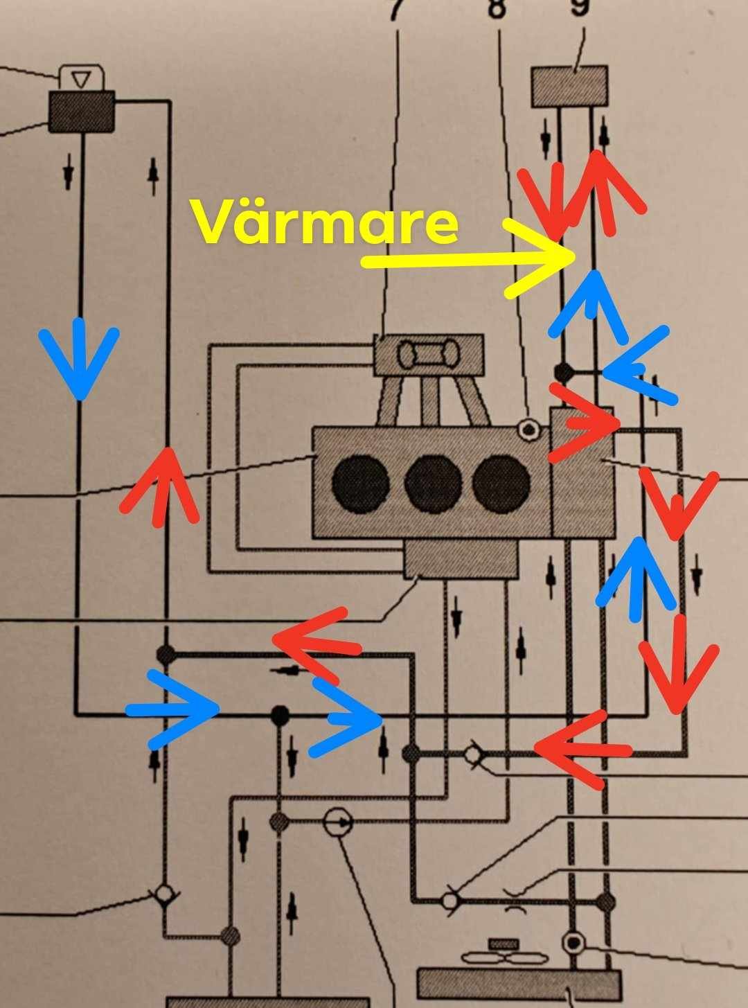

So I talked to a friend who works for VAG stealership and got hold of the schematics for the cooling system for 1.0TSI. It's quite similar but not exactly as the one for 1.2TSI. I haven't checked if it's physically possible yet but my plan is to mount it like shown in the very professionally edited photo: (Värmare is heater in Swedish) So mount the heater on the pipe leading to the heater matrix. It appears that there is a unrestricted circuit between the heater matrix, engine, expansion tank, apart from the water pump which should have some kind of flow through it anyways. I will have to see if the hose is accessible to cut in to, and also se what kind of flow a heater will have through it when turned off. I don't want to restrict the cooling system when the car is running and if it will restrict I'll have to make a separate hose to slice in at the anti backflow valve and put one on the heater line as well
Electric heater - coolant circulation while parked?
Thanks! By looking at it I feel like mine is more like the one I posted. It has a different aux pump for the turbocharger and when it's running the coolant flows through the expansion tank which it doesn't seem to do in this one

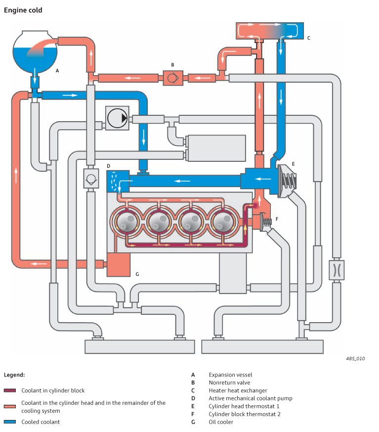

I found this schematic for 1.2tsi, and if the basics are the same it should be possible to put a heater with pump and backflow valve (?) in parallel to the existing one at the top of the image. This circuit seems to be open with only restriction through the water pump it self but this type of pump usually are centrifugal and will let water flow through it
