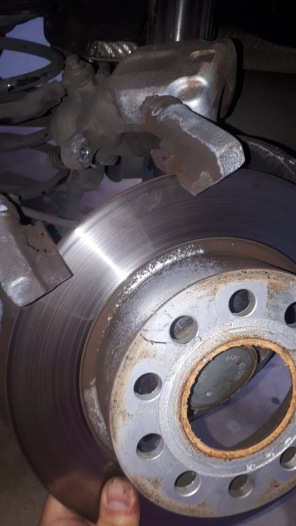

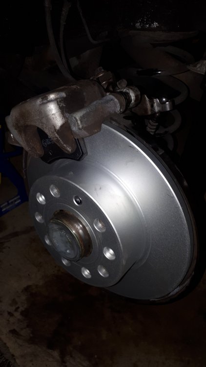

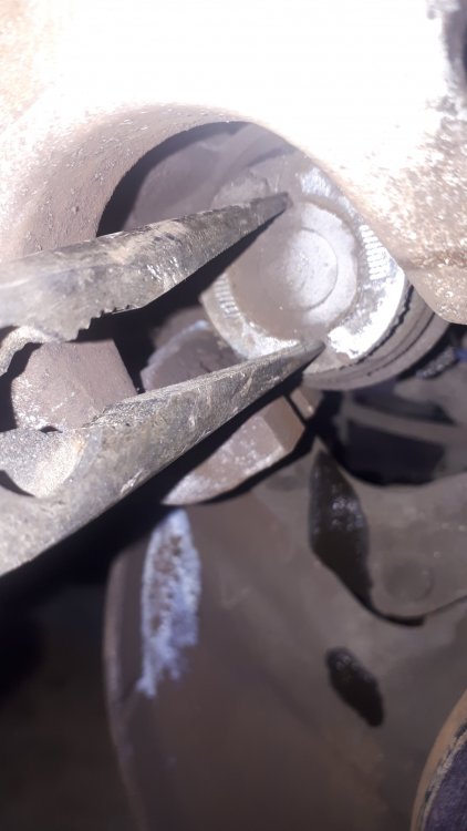

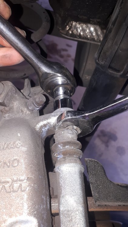

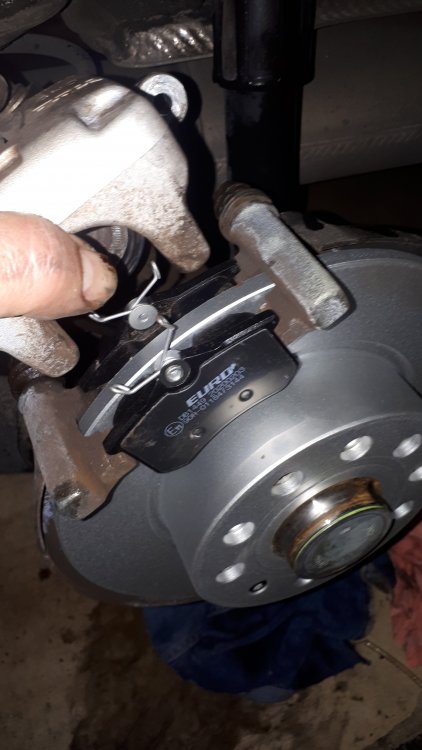

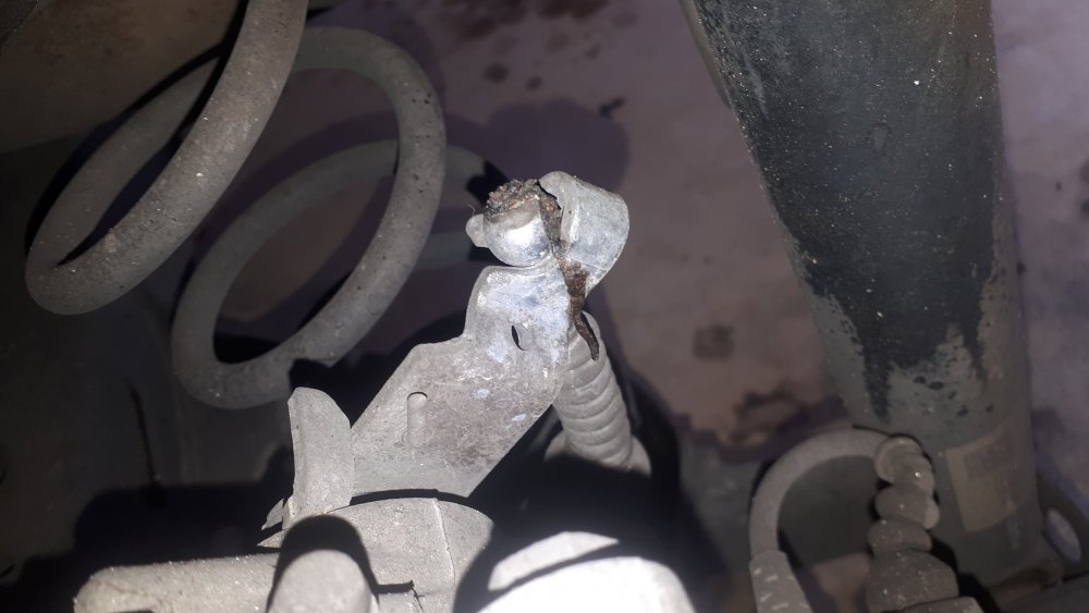

  5. Yeah, it was Hillcrest. They did it under warranty, and they did blame the lockdown for the parts delay. But it wasn't a big deal because my wife liked driving a new Karoq around. Because we live down south, it is a fairly inconvenient location. But now that we're out of warranty, I may start doing service myself, or find a more local place. There is a VW dealer within walking distance...
  6. I just had the water pump replaced on my 1.4. Like you said, an intermittent leak that fotced my wife to refill the reservoir 4 or 5 times. They had our car for more than a month, but we got free use of a loaner Karoq.
  7. A couple notes I want to add: This process is for a 2015 Octavia 1.4 TSI with the torsion beam rear end and 1KD 253mm rear brake. The process is likely very similar for cars with other brake packages, but there may be differences. The code for your brake package can be found on a sticker likely placed in the front cover of the service manual. Check the brake fluid level regularly while pressing the caliper piston in to be sure it doesn't overflow or that the level doesn't fall too low if you have opened the bleed screw.
