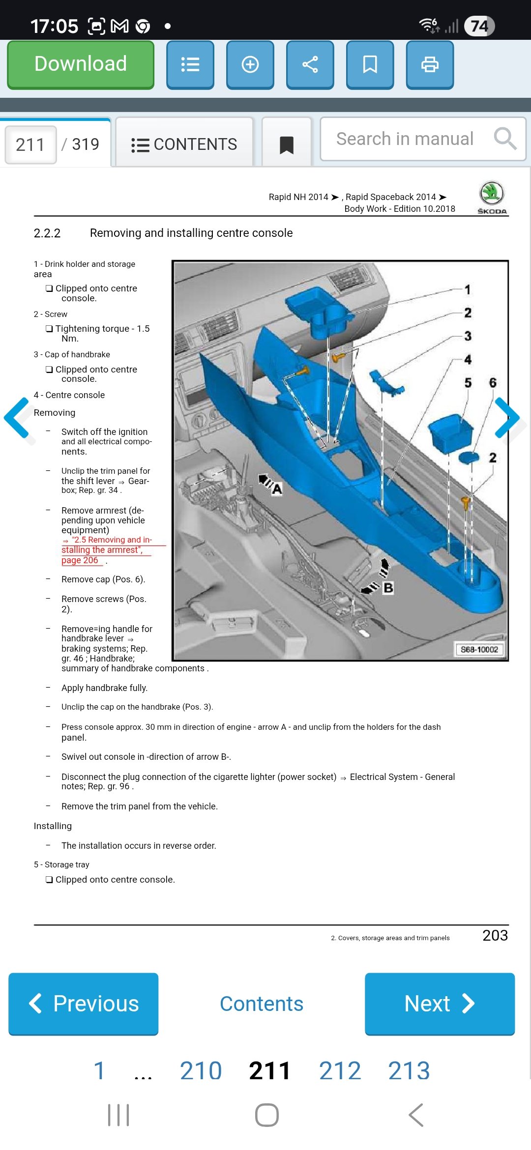

  3. I found a guide online and it looks like I have to remove the centre console. I hate plastic trim... The module location is highlighted. https://www.manualslib.com/manual/1879665/Skoda-Rapid-Nh-2014.html?page=211#manual

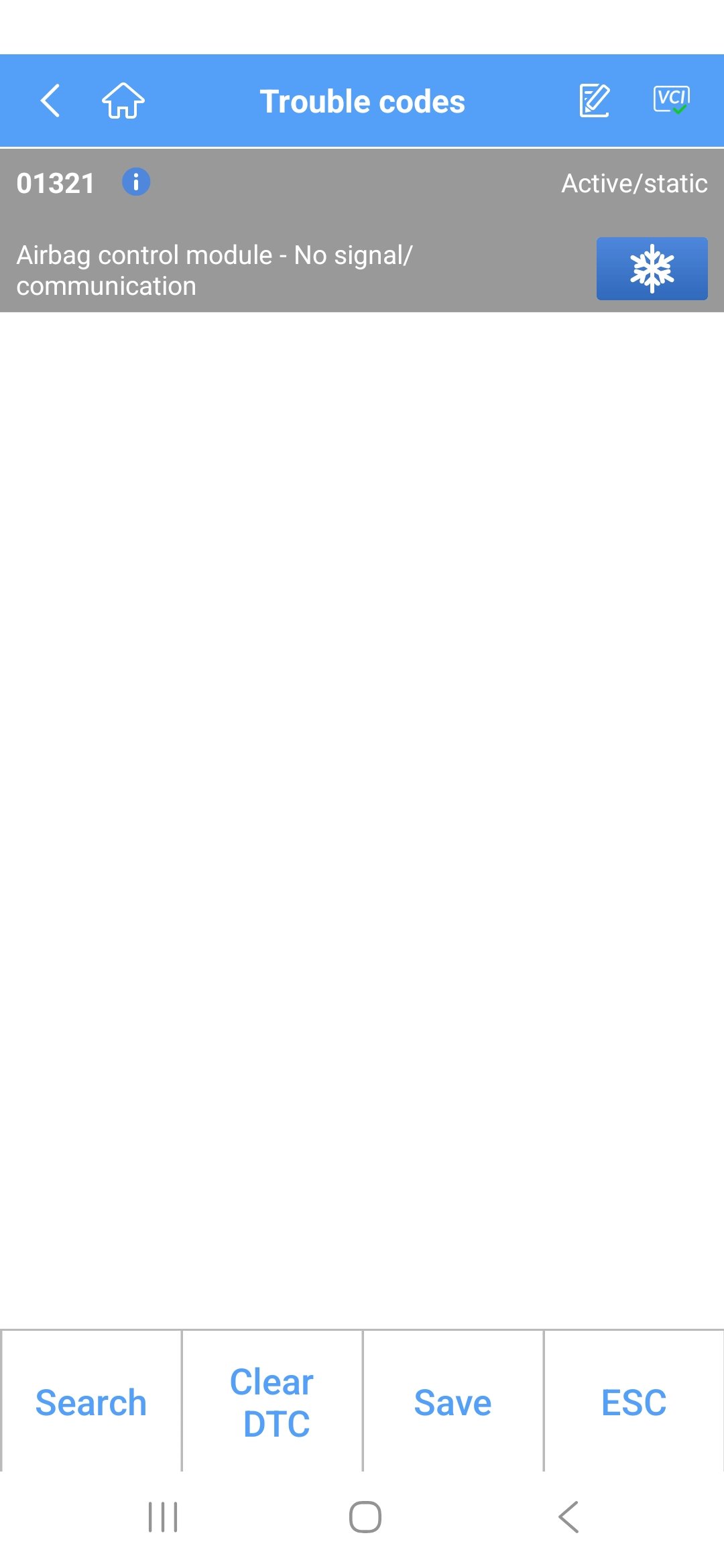

  4. Thanks. Crusie control and auto door locking has stopped working along with an airbag warning light. This is the offending fault code. I need to check if the module is receiving power or not. Did you remove some trim before taking that picture?

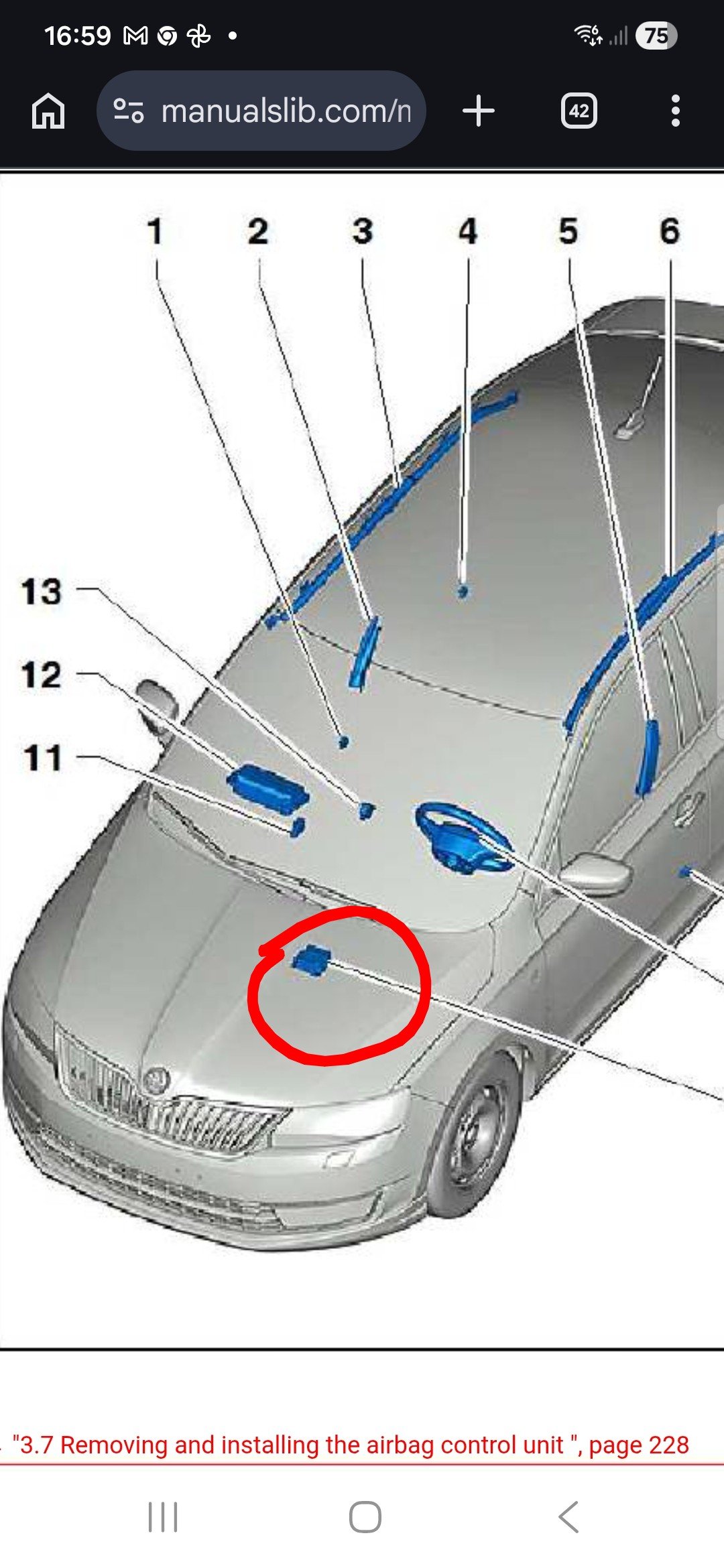

  5. Does anyone know the location of the airbag control unit and how to access it. Which screws and flimsy plastic clips do I have to navigate? Car is 2014 Rapid (non spaceback).
