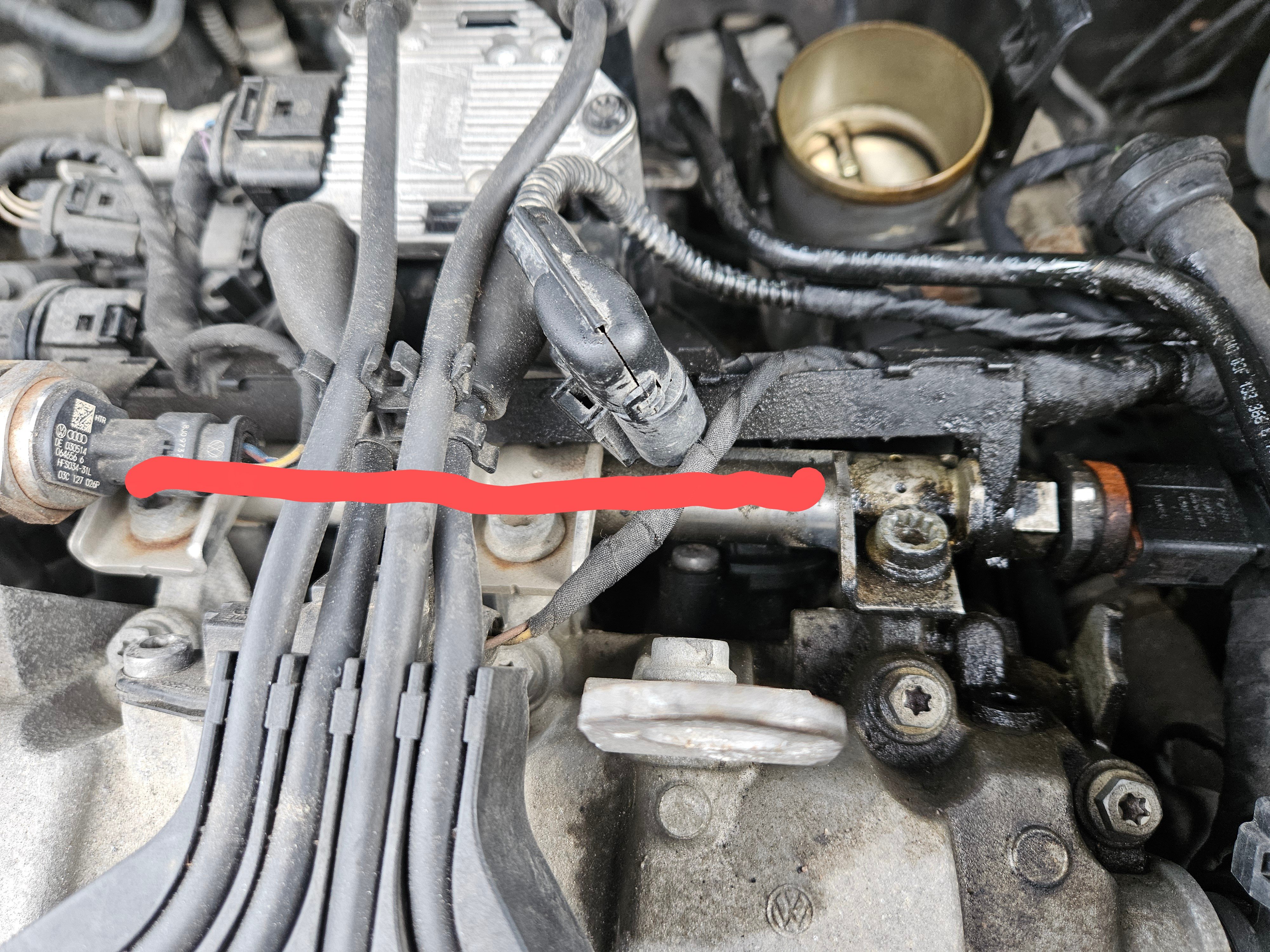

1.2 tsi has a strong smell of fuel. I've read a few reports of fuel rail bolts shearing. Is the part I've highlighted red the fuel rail? None of the bolts appear loose or sheared. Or is this not the fuel rail?

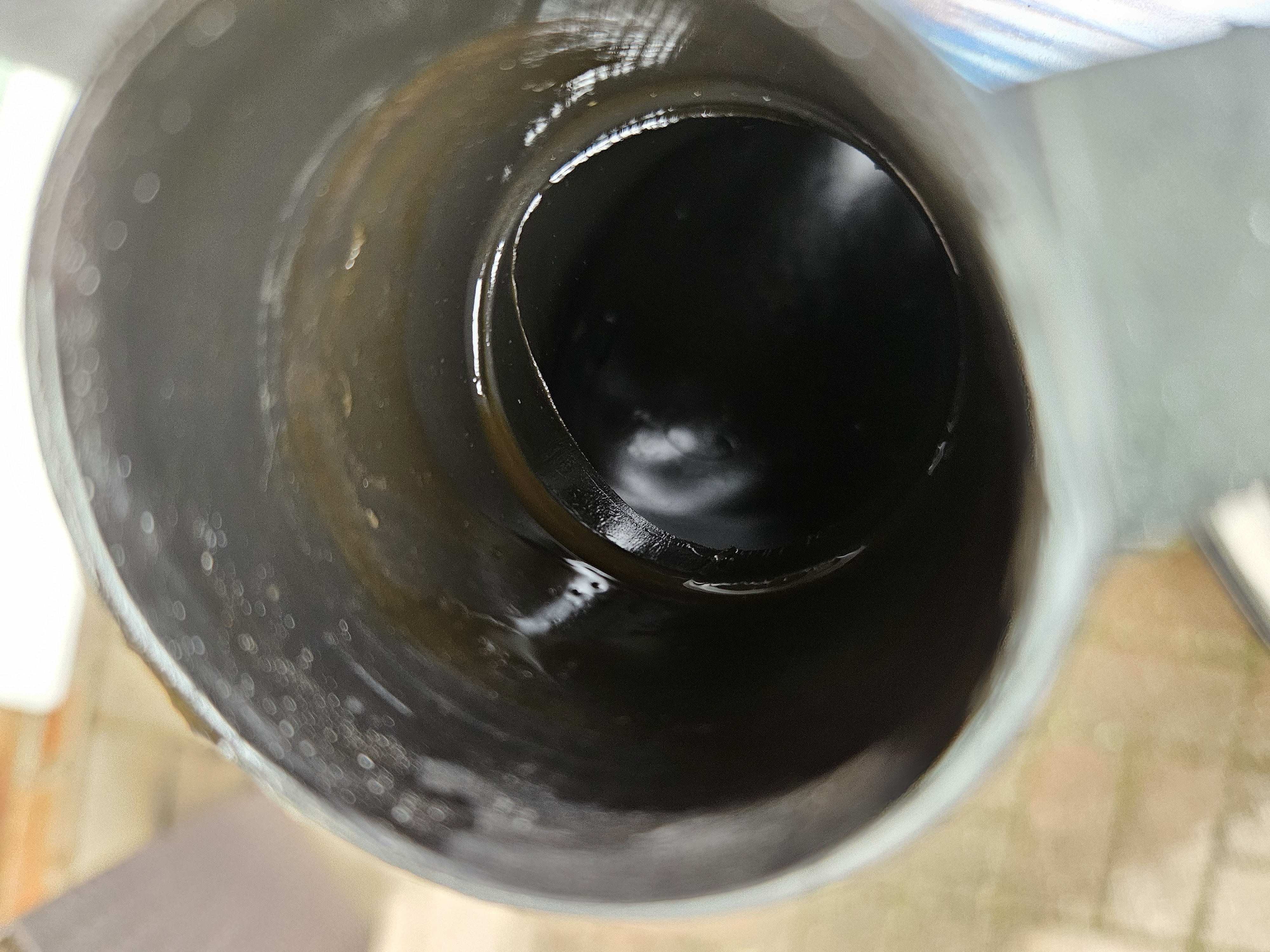

You can see the filth all around the end cylinder so something is leaking. It feels oily, maybe that's what happens to old fuel? Inside the air pipe going to the throttle body seems oily inside too which is a concern.
Looks like engine oil to me, looks like the car is breathing a good amount of oil from the breather system and/or from the turbo seals. There is probably a very small air leak causing that oil to seep out over time around the throtle body. I don't think this is the cause of your fuel smell.

Thanks for the response. I'm wondering how there is so much filth around the end of the fuel rail, if the only source of oil was from the air pipe leading to the throttle body. The pipe seems pretty well sealed at both ends and the fuel rail is in the middle. I'm now considering if there are 2 separate issues, one causing oil in the air system and a separate leak around the fuel rail.
Oil tends to ‘wick’ and travel across the dirt on the engine.
