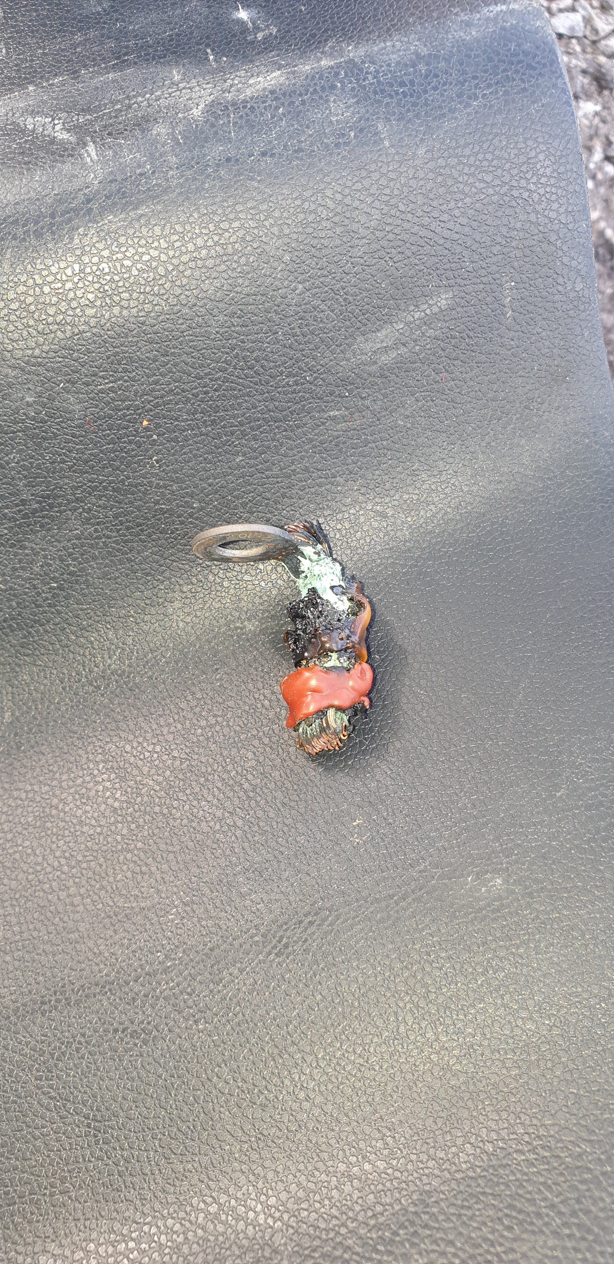

Thank you to all the people who have posted, I've finally got round to looking at the earth points today and found one very corroded contact and wire, looks like some water has got in at some point. Cut that out and replaced and everything is working well. I would say the rear wiper has more power now too. Thank you all!

Hello all, Apologies if this has been covered somewhere before, I've searched but nothing has come back with quite the same issues I'm getting. So the car is an Mk2 Octavia FL 2009 VRS. Problem: Bulb failure light came on today Neither the 3rd brake light nor the number plate down lights are working. (Both MOT failures which is coming up in 15 days) When I unlock the car the boot electronic button/handle works, once I've turned on lights the electronic button handle does not work and I can no longer open the boot from there.. However it does still work if I hold down the button on the key fob! Both sets of rear cluster lights are all working correctly Things I've tried: Checked all the fuses in box next to the driver. (None blown) Taken the rear panel off the boot lining and checked the connector for corrosion but there doesn't seem to be any. I'm not sure where to go from here. Has anyone got any other ideas on where to check/common issues? Or does anyone has a detailed wiring diagram for the boot? Cheers all
