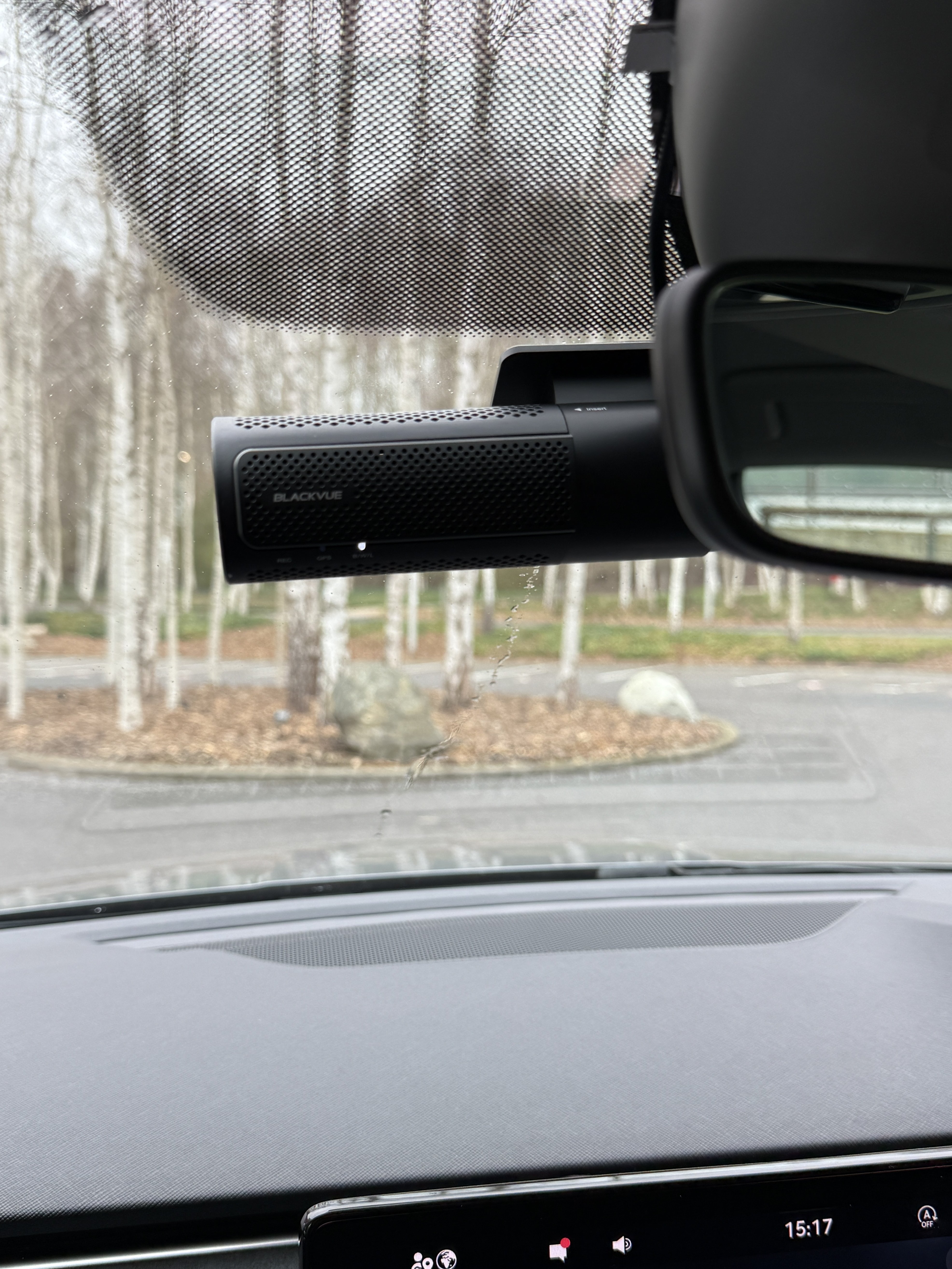

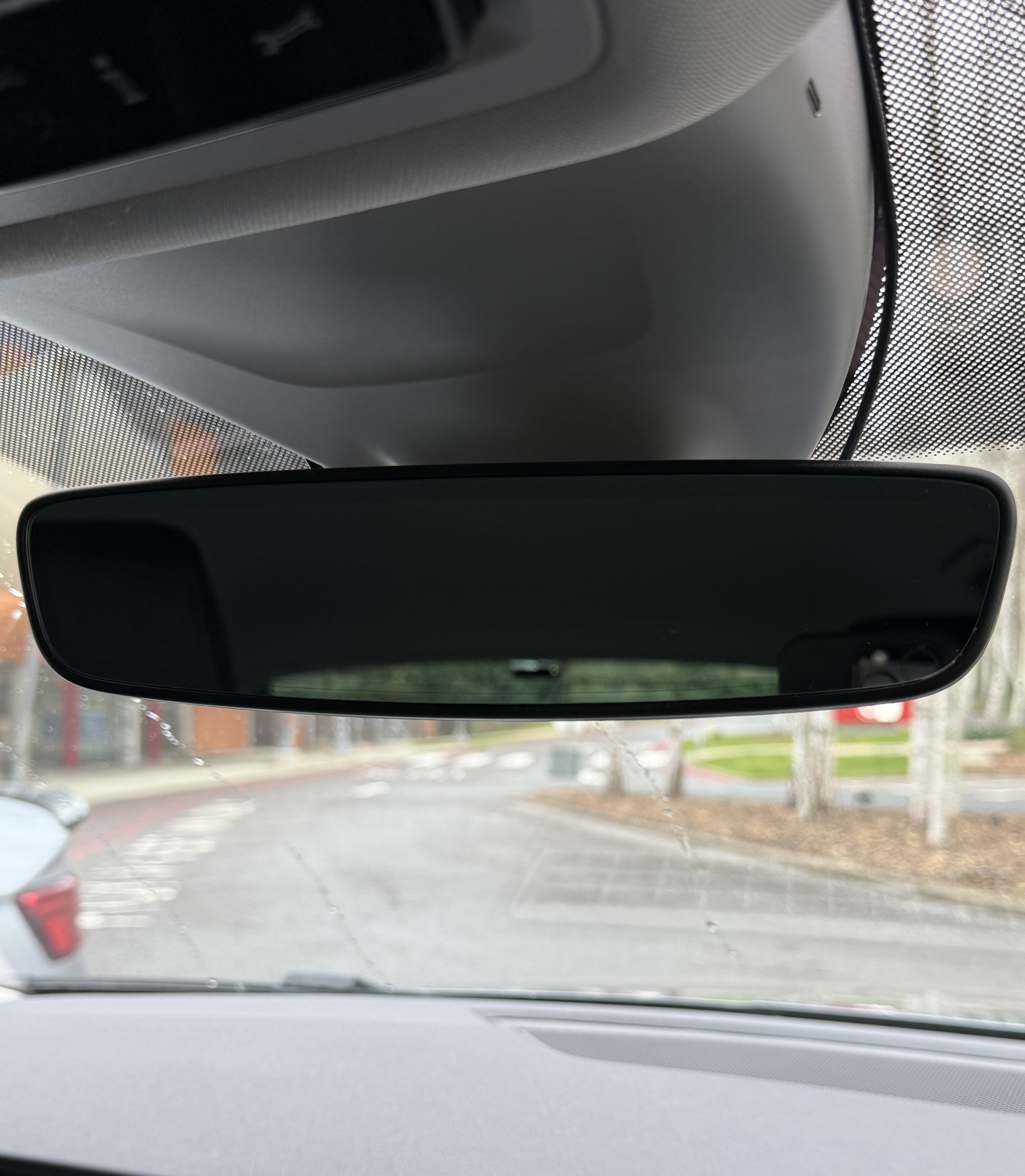

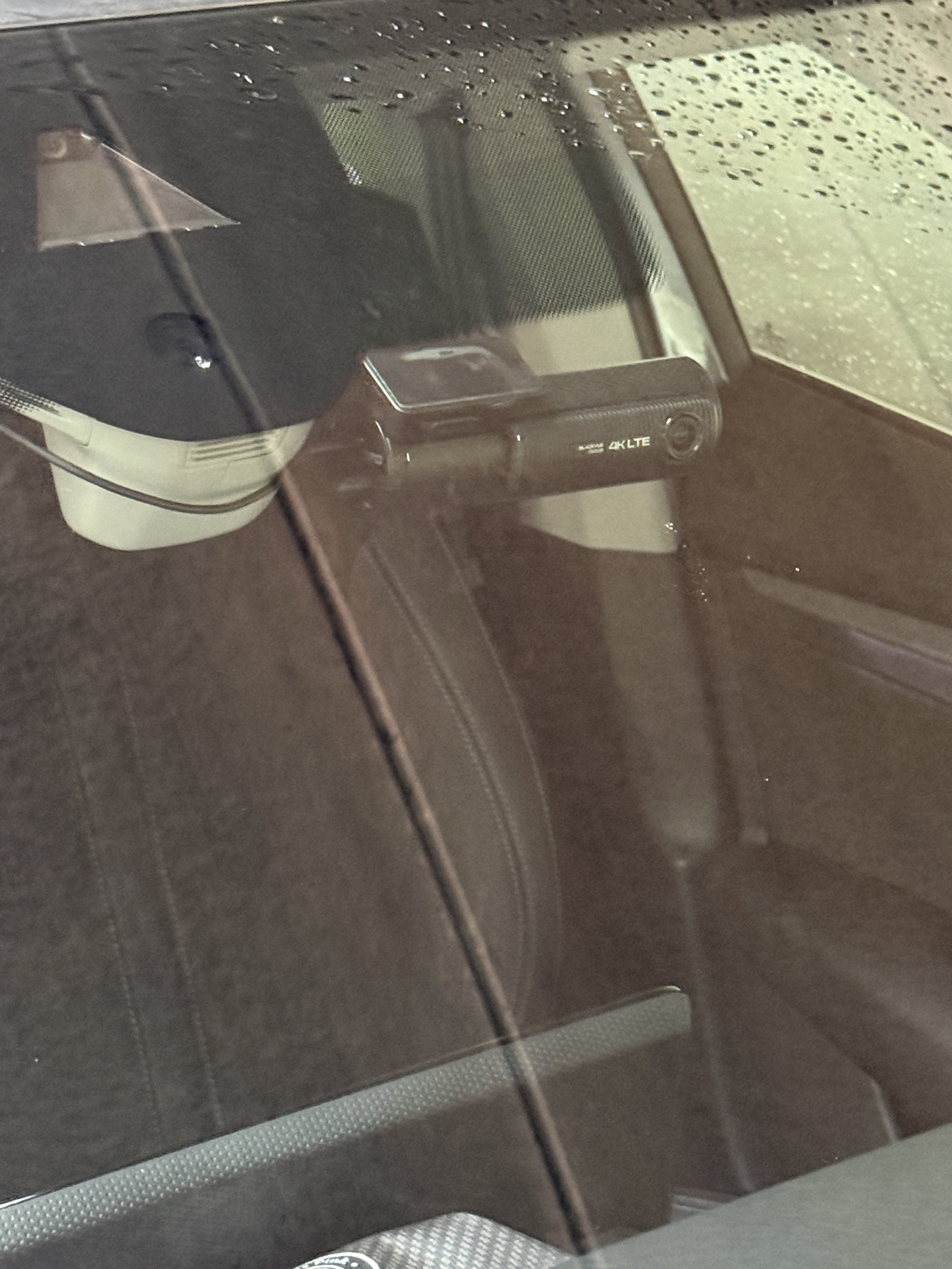

  3. Pictures of my DR970x LTE fitted to my 4.5. Cable fed from switched live (rear wiper) via the BlackVue B124x battery, up A pillar, avoiding airbag. Along under headlining and around rain sensor etc. Coax to rear fed to where I need to route properly when it turns warmer.

  7. If you have megabucks to spend, look at Blackvue. Parking mode, cloud storage and with 4G connection, remote viewing. £400+ though
