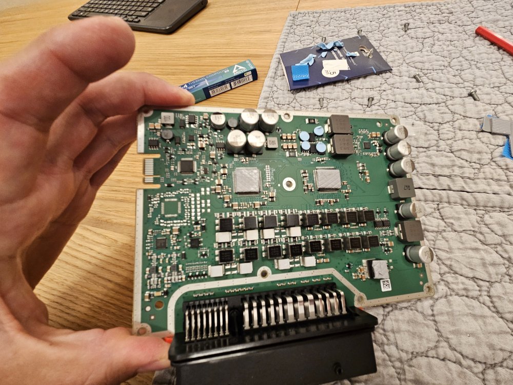

  8. Dear all, At this time of my life Skoda Octavia III continues to be part of my life / I sold mine, but my cousin buy VRS / So all knowledge I took from it, I use now New car is Audi A6 C8. It has Bang Olufsen music and ... I opened the amplifier just to check it out It is called MIB 3 booster and it is located in truck. It is claimed to be 705 W. At the beginning I tough it using MIB2 amp like the Skoda - seeing the pictures schematic. But after I found it - it is different. So. Whats inside Pictures later For now: 1 chip TDF8536HH with specs: Class D / 4 x 140W at 4 ohm 1 chip TDF8532HH with specs: Class D 4 x 80W at 4 ohm Maybe a different threat must be done, but no time now, maybe later. Regards,
