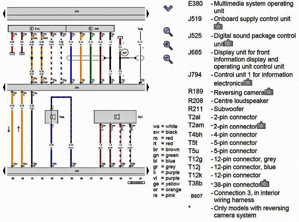

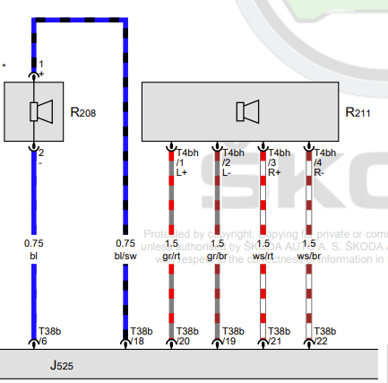

You can't mess nothing just make it in sequence. 1st make channel 1 and try. If you don't hear bass in car so you have depolarised + and -. If you do go with 2nd channel. Then tell me what you think or what you hear or feel

Best you can do is to make it as it is +- +-, but I'm not sure what are the cable colors.

The Bang Subwoofer will be enough for you. I'm pretty sure you will love it. Just try not to mess the + and - of your 2 channels, because if you do so all the bass in car will dissappear. I even have 1 sub for sale :), because I bought 3 or 4 in a rush
