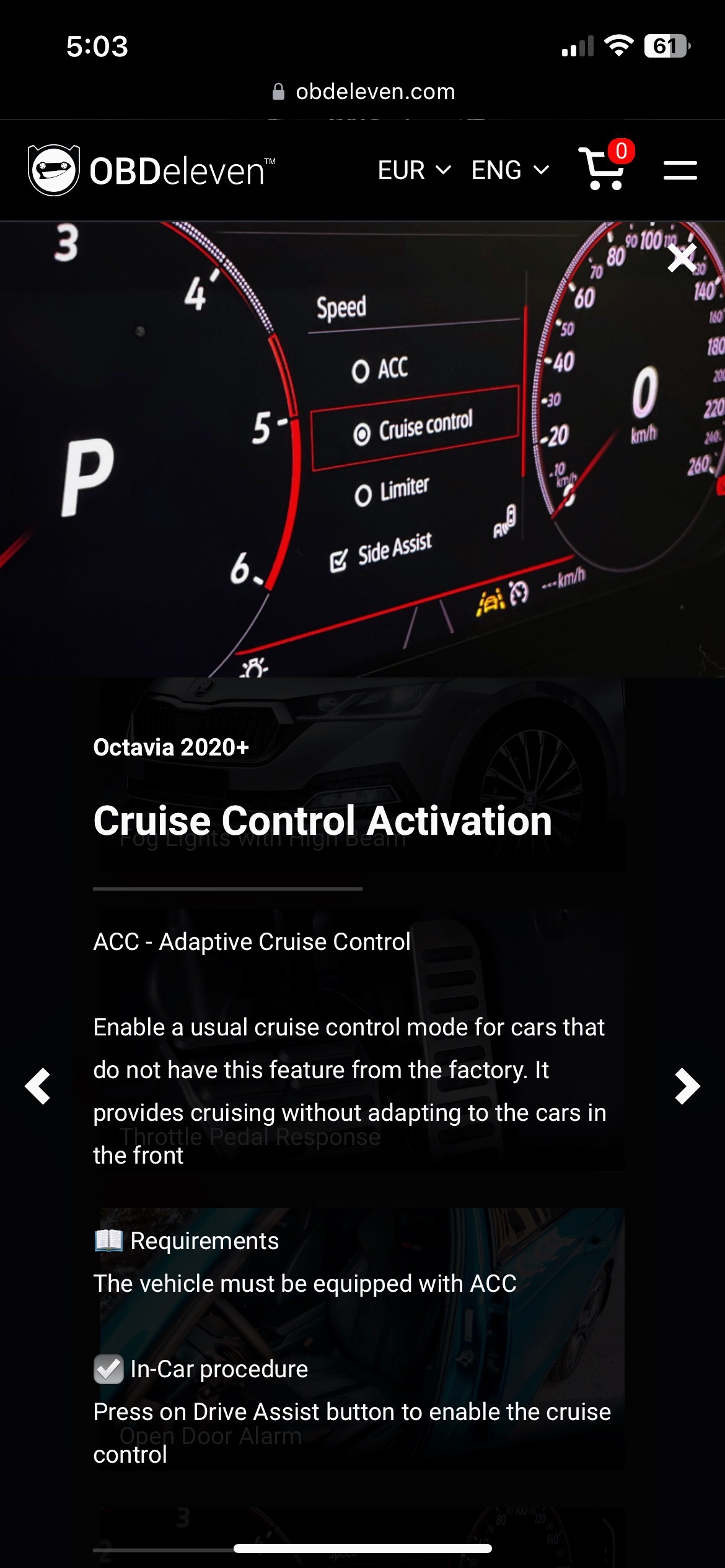

  1. Obdeleven has an app to add this option for the Mk4 Octavia that have ACC but I haven’t tried it. Hopefully this means it maybe coming to the Kodiaq

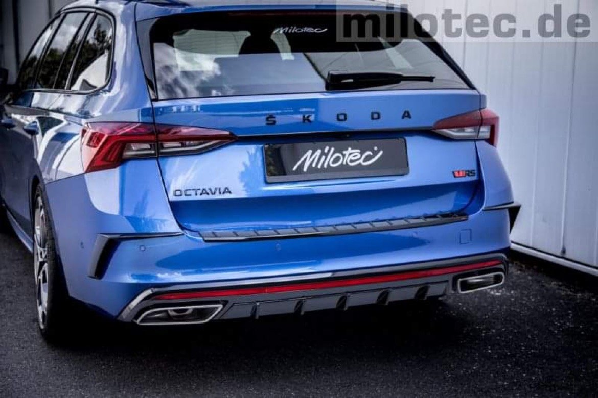

  9. Just in reply to this, Milotec.de have released a rear bumper protector for the Mk4 Octavia VRS now. Also have released a rear diffuser (is compatible with the electric fold away tow hitch too). Have mailed them to get a quote for shipping. Link is below https://milotec.de/Milotec-Ladekantenschutz-passend-fuer-Octavia-IV-Combi-RS-Combi-ABS-schwarz-Klavierlack::3965.html

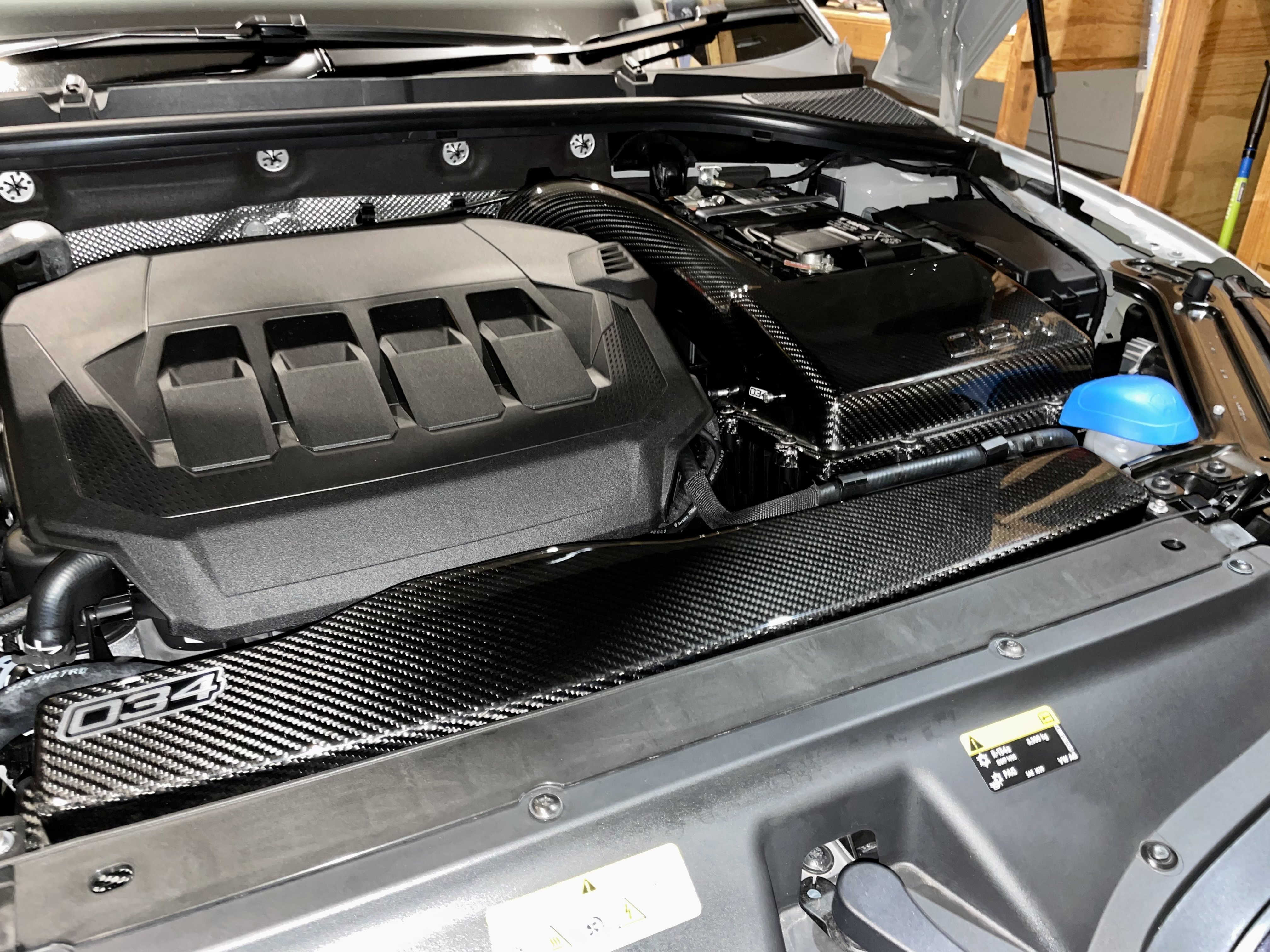

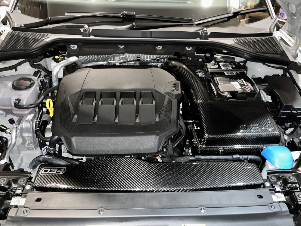

  10. Yeah I just installed the 034 X34 Carbon intake and 034 X34 Carbon Fresh Air Duct. Gotta say it goes heaps harder. Mid range punch and top end is much better. Initial throttle response is definitely more noticeable too. Won’t tune this car hey. I reckon it goes as hard now as when I had a JB4 connected to my 162 Octy VRS Mk3. Except this car has traction… (no LSD in the 162) Will get the 034 Turbo Inlet Pipe installed soon. Am also going to order rear gloss black diffuser, gloss black rear loading sill protector and some front and rear air inlets from Milotec. Just waiting on getting a quote for shipping to Australia.
