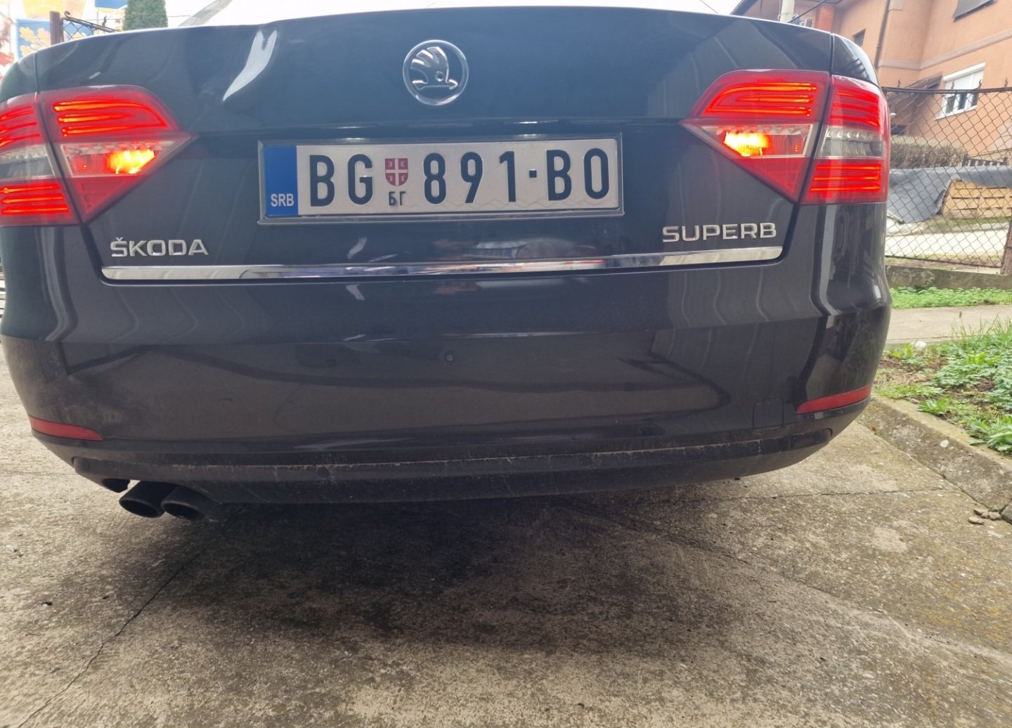

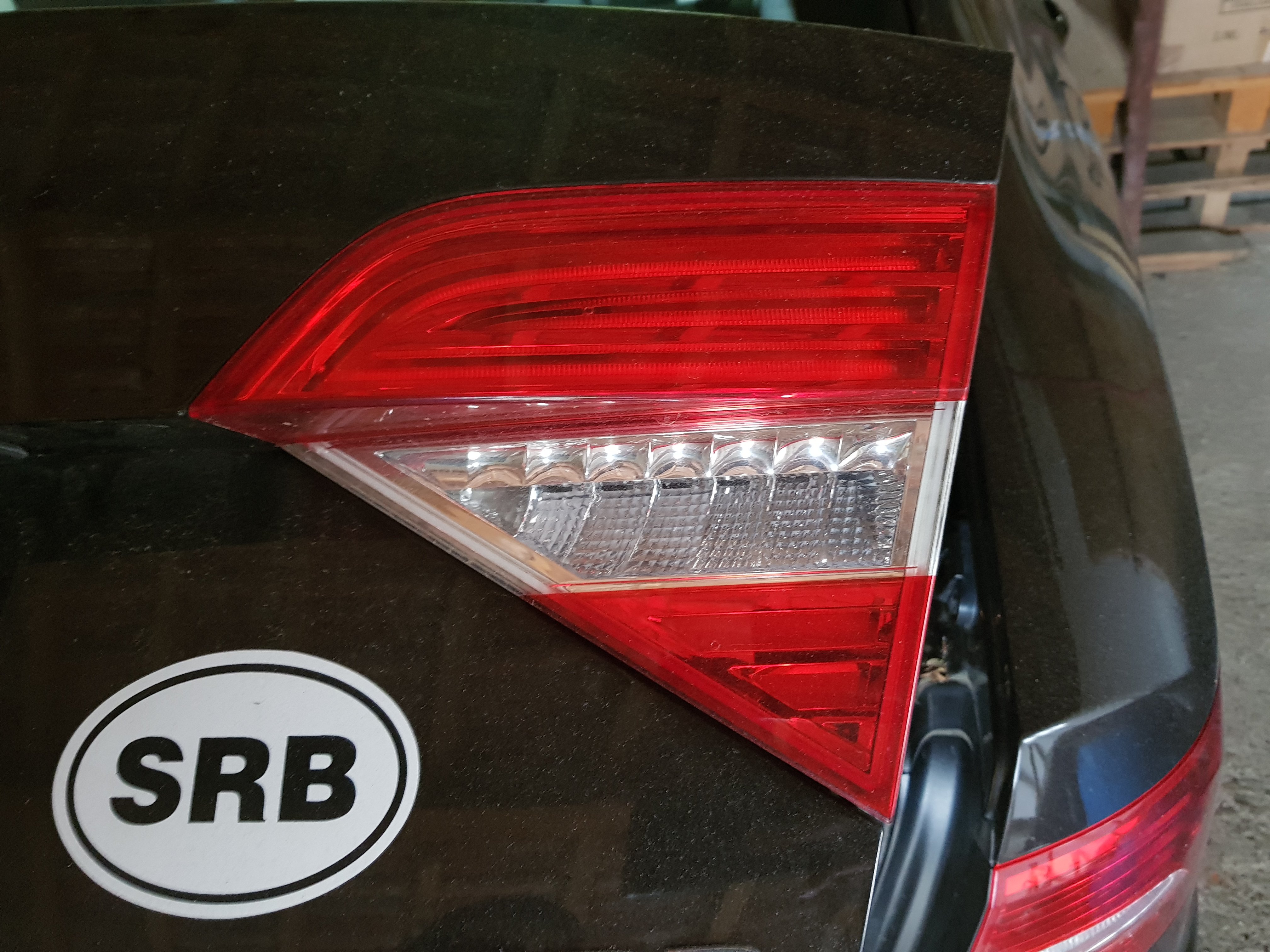

Superb mk2 limo FL rear right fog light
Done today! 10 mins job with the help of friend who works at local Skoda service. One wire and job finished. No bulb error on dash.. P.S dont ask me where I hit rear door😑
Looks like I will to put a wire from BCM light module to the fog light. Via twin door system. And after that coding.

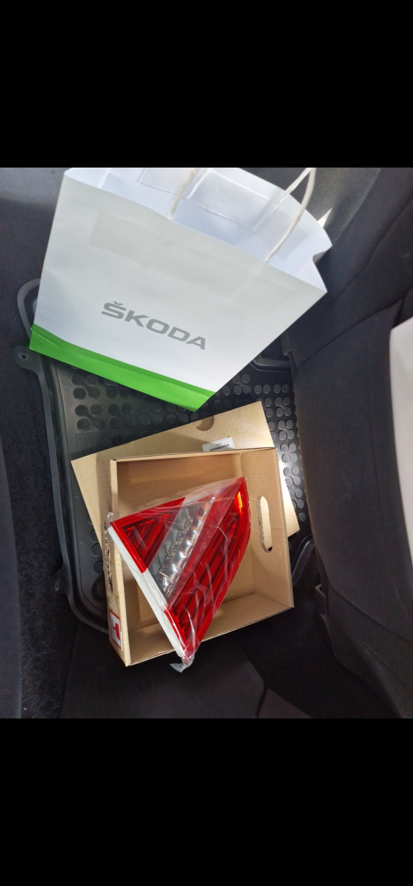

Hi guys. My topic was old, but got up to date today. I bought the UK part under number 3T5 945 094 B. It is writen "UK" on it. I see the led diods for fog light (I couldn't see them on my EU part). But I was surprised..there is no light at all! No error on dash, no "cool flashing sequence" when I start the engine, no nothing! Reverse light in the new part works, but maybe dimmed a little comparing to the old one, I must wait dark. I have LED H7 in my high beam, it works excelent and therr is a "blinker like" flashing sequence when ECU does light check when I turn the engine. There is an error "check right/left high beam" which is totally ok.. Does anyone have an idea who to activate the rear right UK fog light?:)

Hi guys, can someone with RHD (England) please tell me the serial OEM number for the right part of the rear right headlight which is attached to boot door? I saw that my LHD car doesnt have led diods in that right headlight. It is blank. So i would like to put RHD right part and have both rear headlights. Thanks in advance! If someome needs i can tell you the left LHD part. But now i need right RHD part no:)
