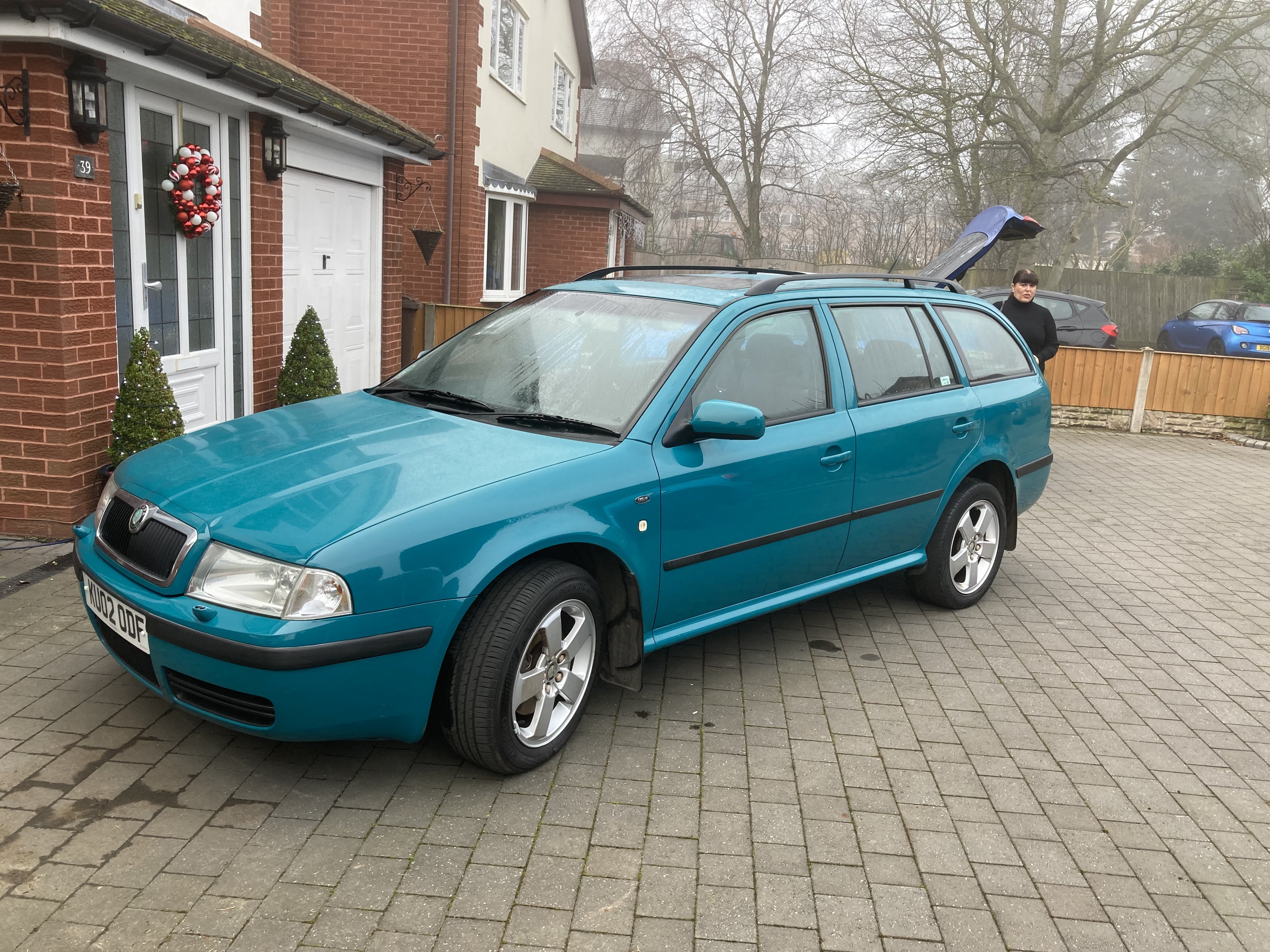

Hi! (Mk1 Octavia 4x4 1.8t)
It's a strange colour but I like it! It might well have been the one your mate was looking at. It's in really good nick, just trying to keep it that way now!
