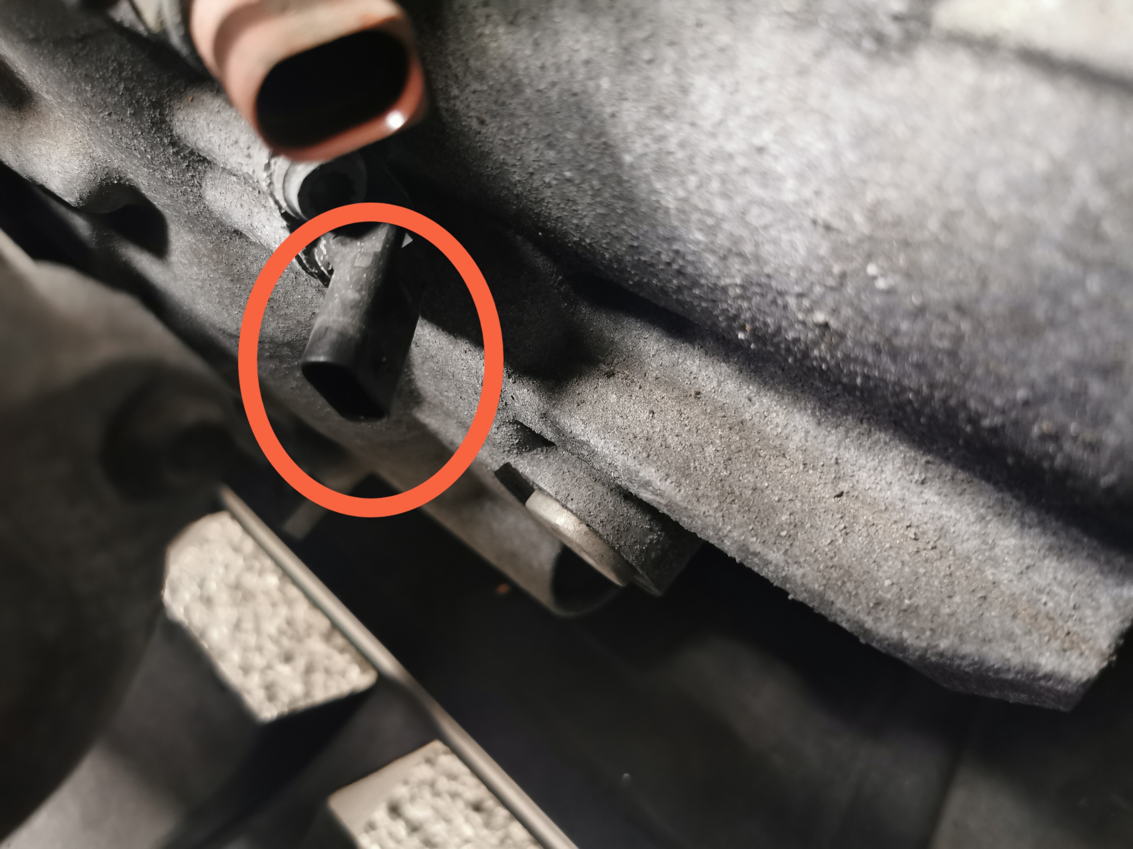

  8. Had a look, on my own MK3 manual, to get access from above I had to remove the air fliter box rather thsn the battery box then it is straight down practically looking at you towards the front right if the gear box...
  9. Photos are of my own... I didn't need to remove the battery box or anything, this was located at the front of the gearbox, should be the lower of two sensors I think with the upper one being the reverse light switch, and was easily accessible from above, I will get a photo in abit and post here to show location better. However as my own was a MK 3 I'm not sure if it's a similar layout or if there was any changes in terms of getting access etc.

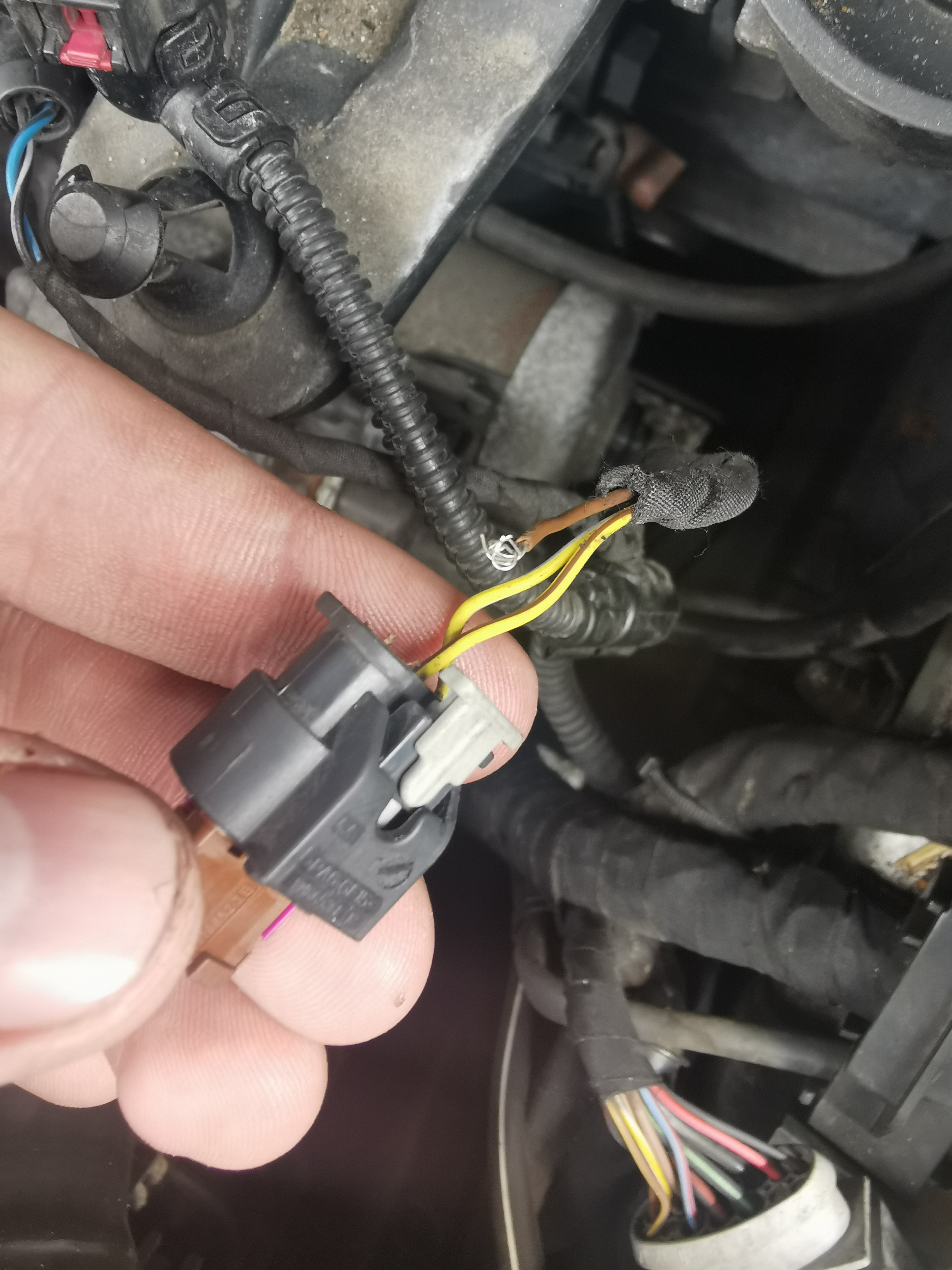

  10. Did you ever happen to get this sorted? I've just had the same issues on my own MK3 VRS Manual, which ended up needing a simple repair of a nipped wire on the plug on the gear box, under the reverse light switch. I've attached an image of the plug with the nipped wire and the sensor on the gearbox
