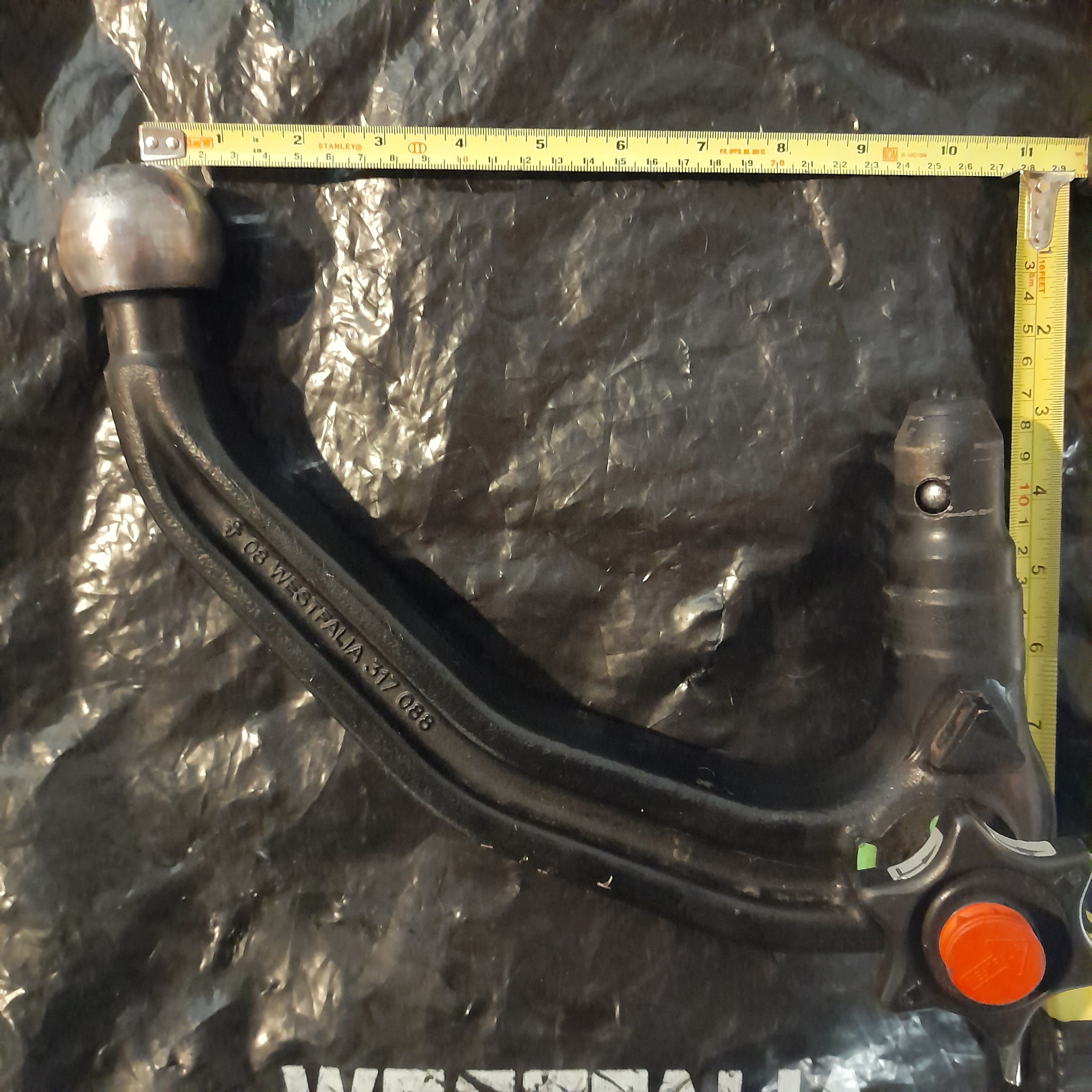

Greetings, I had a Westfalia towbar fitted by Towsure to my 64 plate MkII Superb estate when it was 10 months old. According to Towsure (at the time) the bar is the same as fitted to an Octavia estate of that year. I hope this helps. AndyW

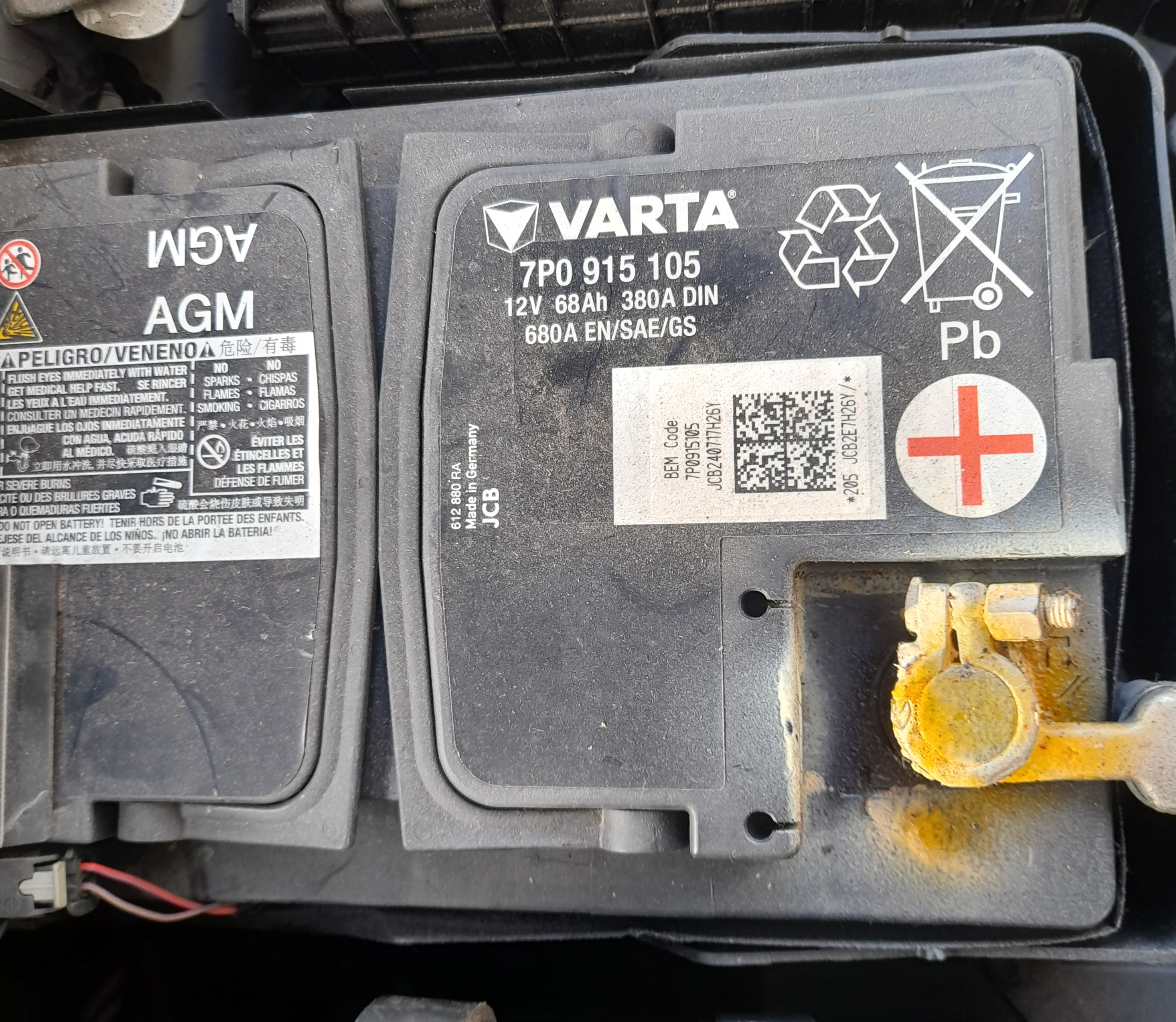

@varooom I think I'll go for the same as what's in already - see pic attached. I know it's not rocket science. In my "youth" I've changed big ends on my Trumph Herald, for some reason flashed my Triumph Spitfire from positive earth to negative earth (I still can't remember why), modified the valves and head on my mk2 Cortina GT and put a recon engine in our VW caravanette (1971) but now, just starting my seventh decade, when I look under the bonnet of my Superb I wilt. I think (hope) I can manage a battery change though 🤗. AndyW

@varooom Thanks for that. Not haviNg a VCDS gizmo, if I understand the opening of your article correctly, as long as I replace the battery like for like then after a short drive and a bit of a twiddle all should be well? Brilliant. Thanks again. AndyW

Greetings and apologies to Graham Butcher for tacking my (related) query onto his post, I have a 2014 Superb Combi SE 140 diesel manual gearbox and I think the winter has finally taken it's toll on my battery; mind you it is the original battery (I've had the car since it was 9 months old - aah). The car still starts but the stop/start doesn't stop/start(?) any more even after an hour's motorway journey. I'm confused about the replacement side of things. I've read this post and the query about coding. I've read various articles about stop/start batteries needing encoding to the vehicle. Halfords (hmm) say the new battery has to be encoded. That's all fine BUT my vehicle manual states: "We recommend having the battery replaced by a specialist garage, where the new vehicle battery will be installed properly and the original battery will be disposed of in accordance with national regulations". (Page 192 REPLACE) Now the question: Is the manual's statement a disguised way of saying that it does need coding when it states "installed properly" or does the battery not require coding? AndyW ps I was going to check whether the existing battery is an AGM or EFB, apparently this is important, but it is persistantly precipitating it down outside so I haven't yet.
