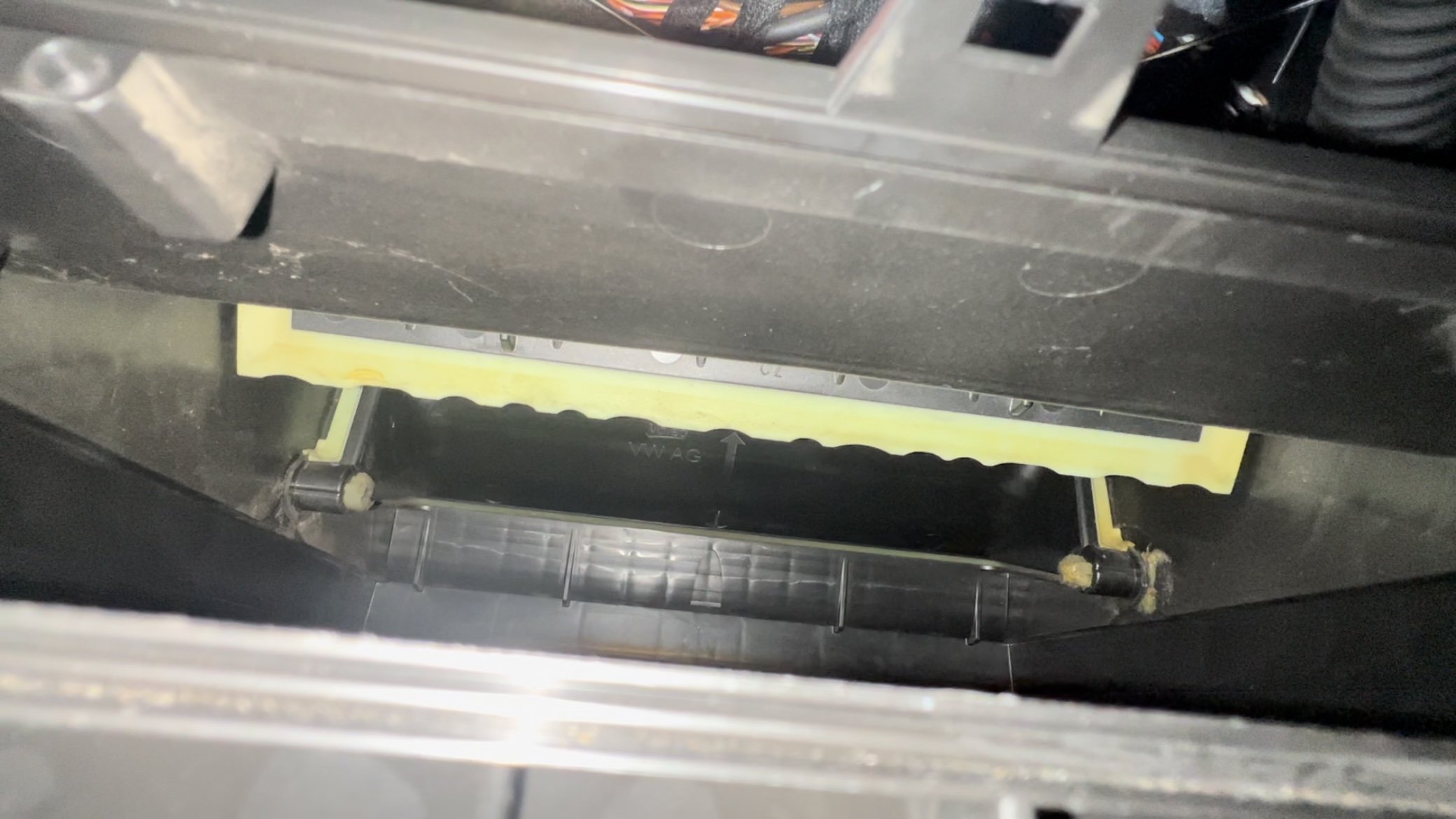

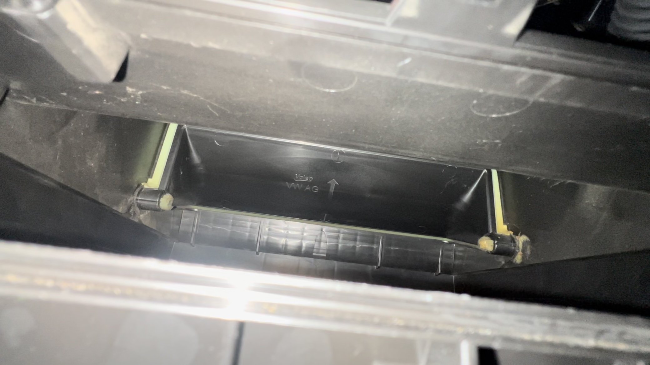

  6. I struggled to see much, but took a video of the flaps moving (starts in recirc, then fresh and back to recirc- you can hear pitch change). I could be wrong but looks like the one closest moves but the far one doesn’t- it says valeo on it. Assume the far one is the broken clean air one. Looks a right pain to get to! video is too big to upload so here is a YouTube link: Took screenshot 1 of it in recirc, screenshot 2 in fresh air (the far flap doesn’t move)

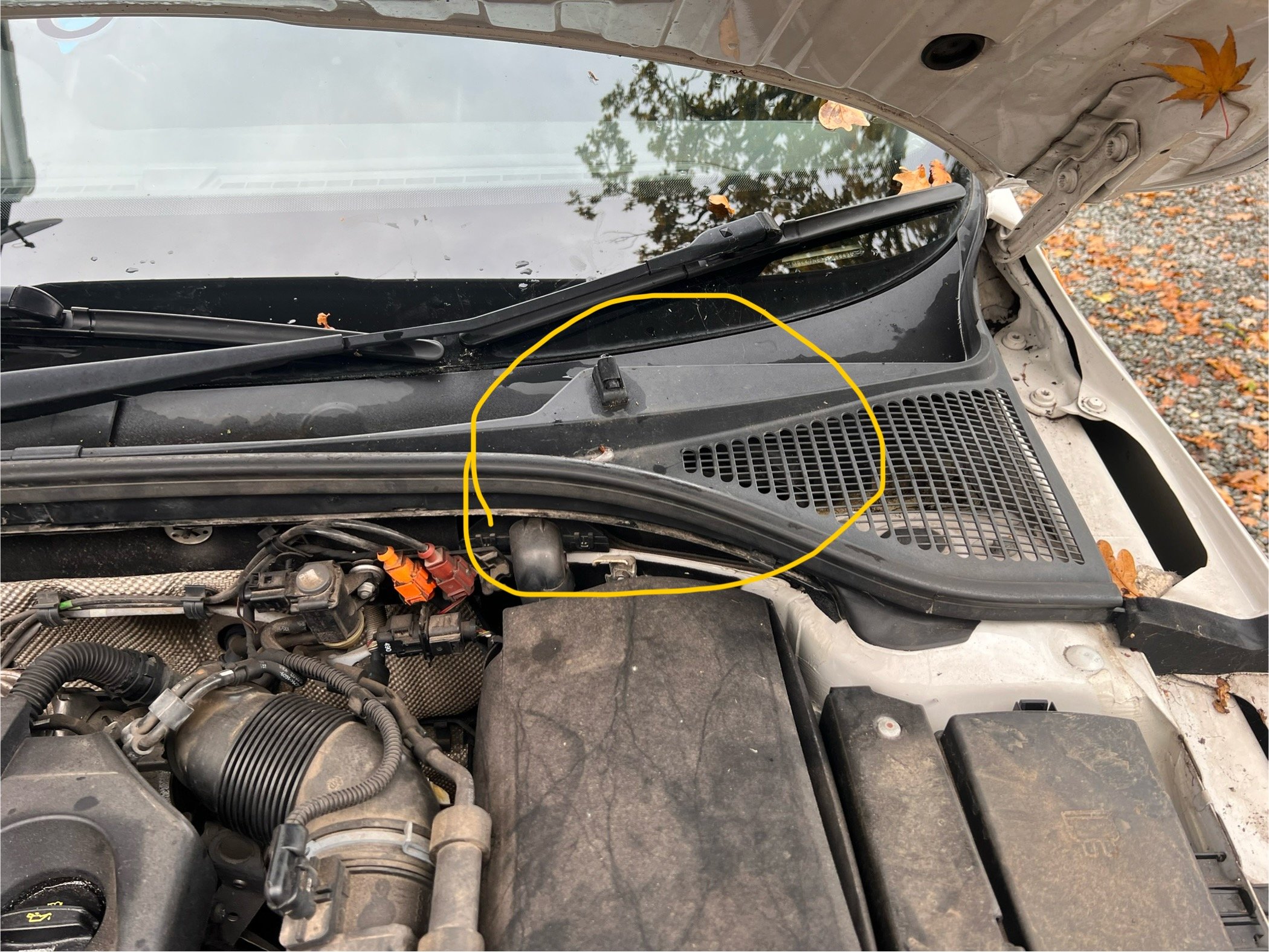

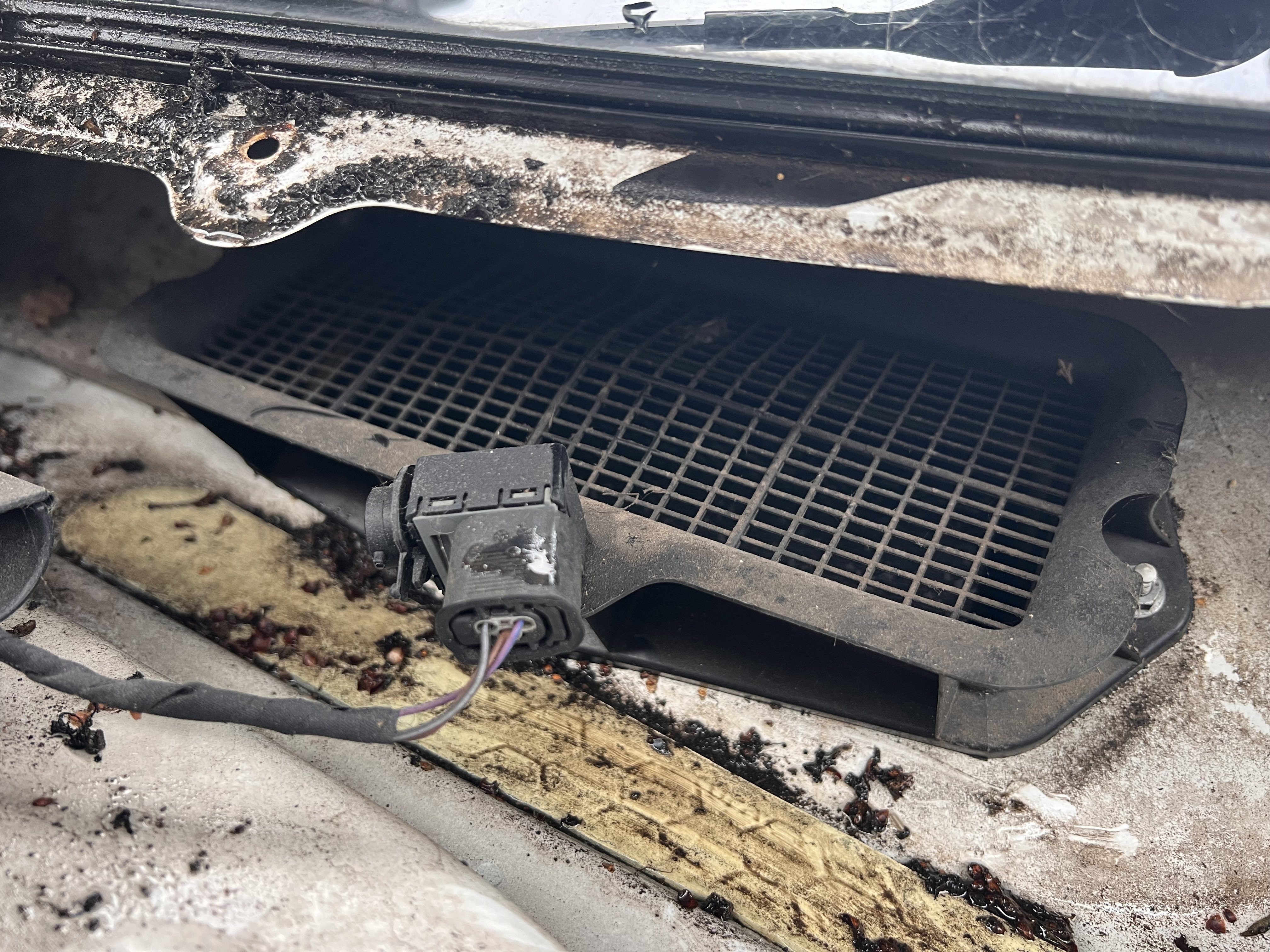

  11. Ok so for the benefit of others I did find the intake location, On the passenger side below windscreen as Ootohere said. Photos below. just needs the cover popping off then there’s another shield with 2 torx screws to remove. it wasn’t blocked so I’ll open a new thread with a new question to avoid confusion in this one.
  12. Yeah could try taking that off - it is between the two wiper blade motors? Plenum or something? I did find this old post but wasn't too conclusive:
