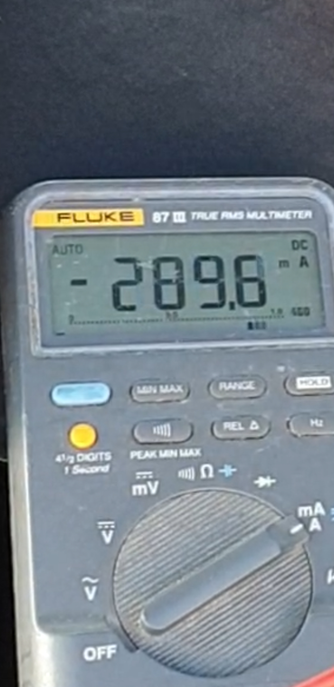

  20. Thanks ill have a read of the link you sent. This is what i get on my multimeter.
  21. it s an Oldham advanced and says 74Ah 12V 670CCA I did take it to a garage to get it double checked to make sure my multimeter was reading it correct. I only have one setting for amps, it says mA A and has direct and alternating pattern on the same dial where as volts has separate settings for direct and alternating ac/dc. When it's set at rest the display shows 00.00, once it's connected it shows - 289.6 m A
  22. It must be 0.3A, I did get someone else to double check it and said it's fine being below 0.5a. The battery is now back on charge as it's too flat to start the car. I bought it in mid October 2018 when i found the receipt. So its 2 yrs and 4 months old. I'm sure the warranty is 3 to 5. It's not like it's sitting for weeks on end without being started. I have disconnected the car terminals from it and charging it up fully again. I will then try checking the battery on volts as someone turns the engine over to see if the starter motor is excessively pulling from it as someone local suggested it might be on it's way out. If this is worth it, what figures would i be looking at? Other than a weak battery and not enough use I don't know what it can be now. I don't want to buy another incase it does it again. I may have to buy a solar charger that plugs into the 12V lighter socket to top it up if it's the lack of use or shorter runs.
