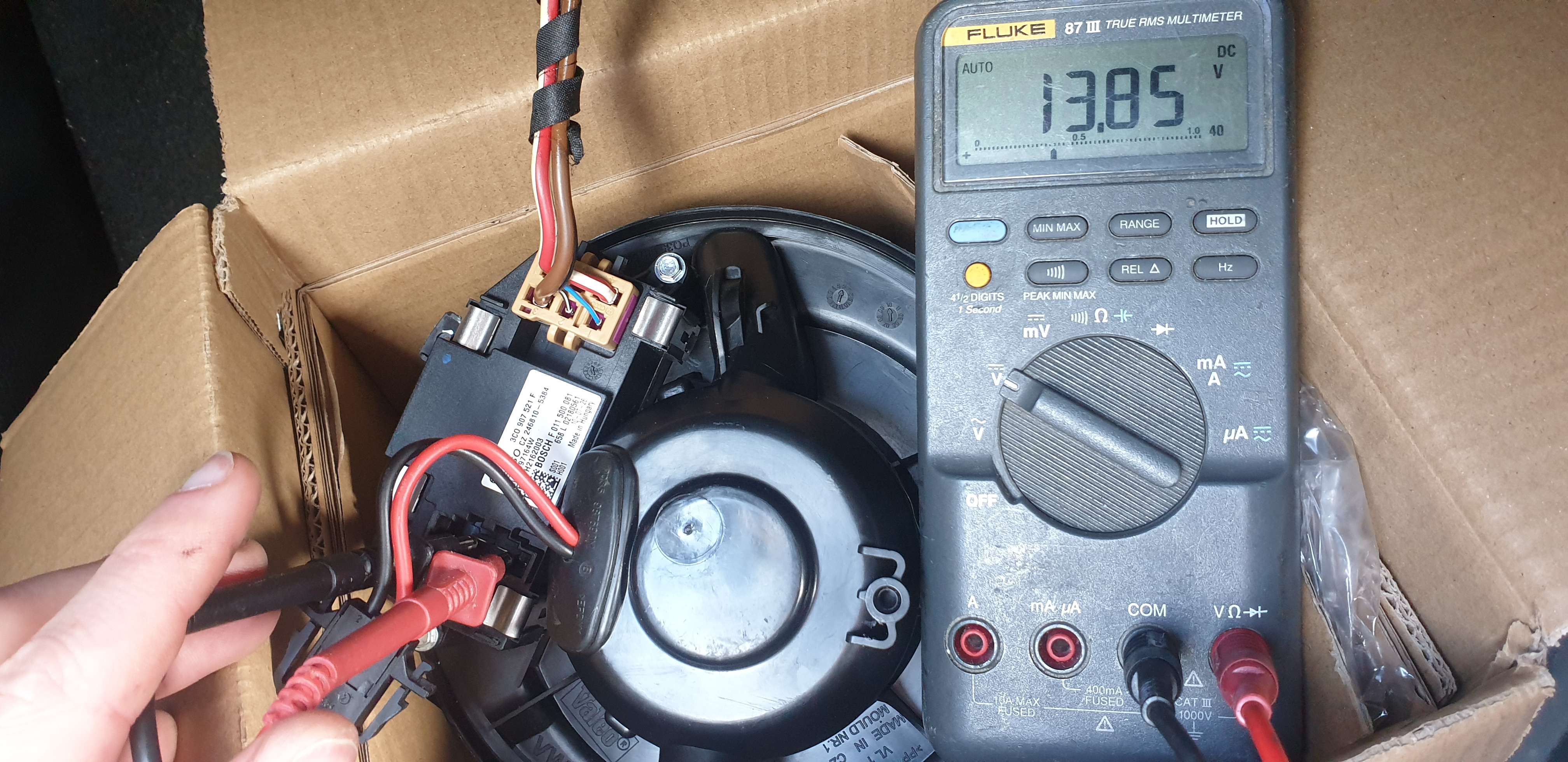

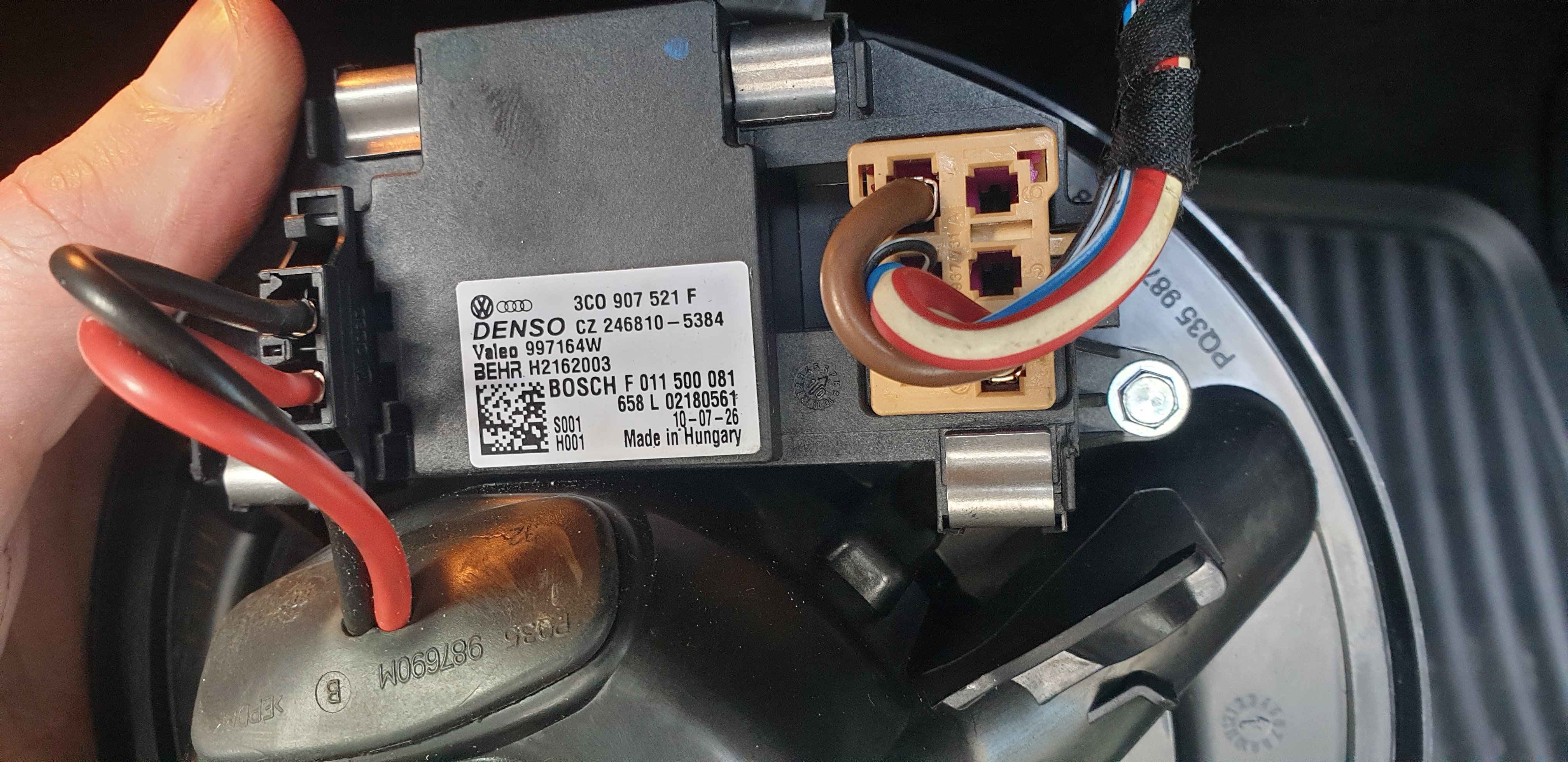

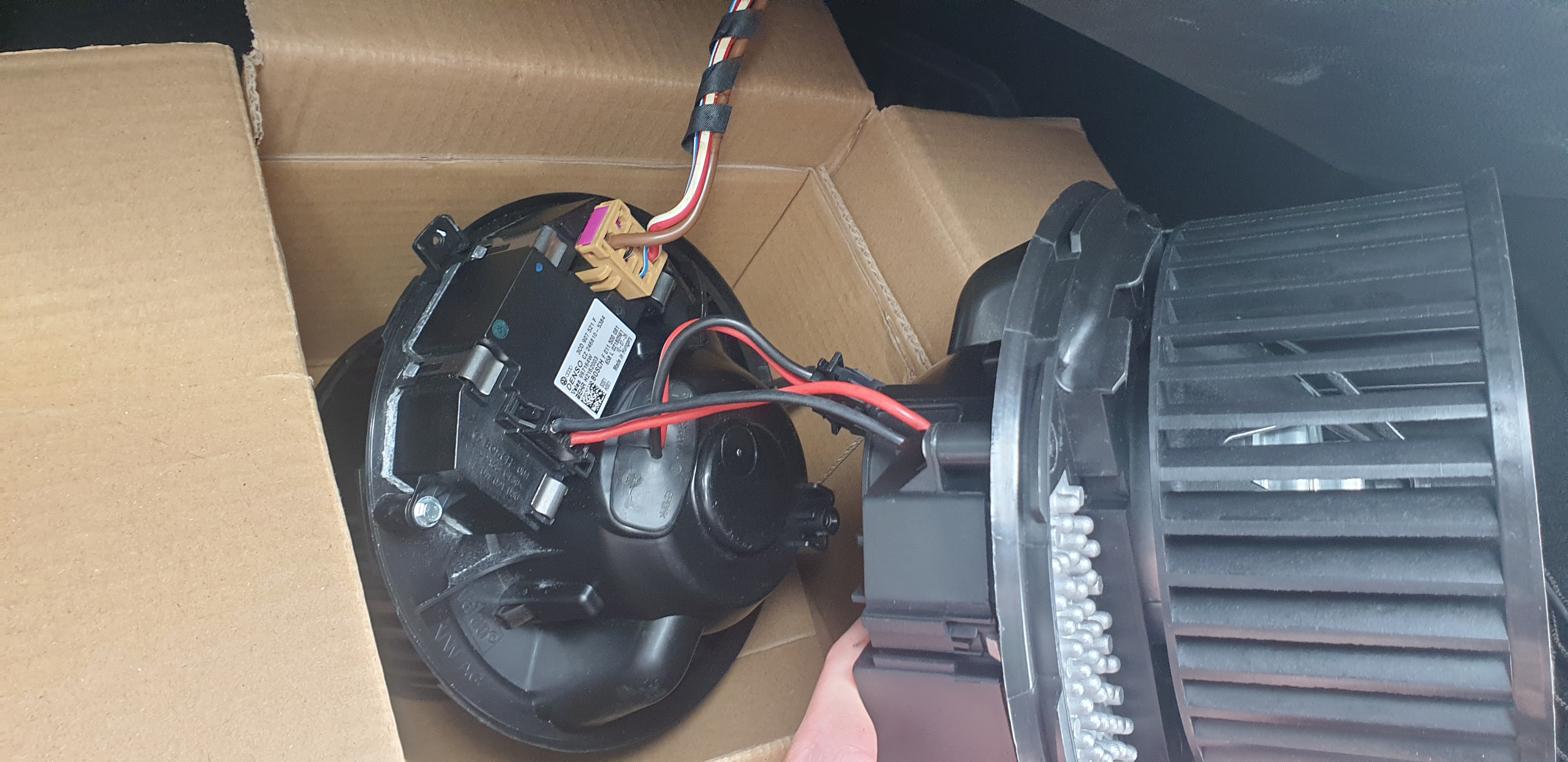

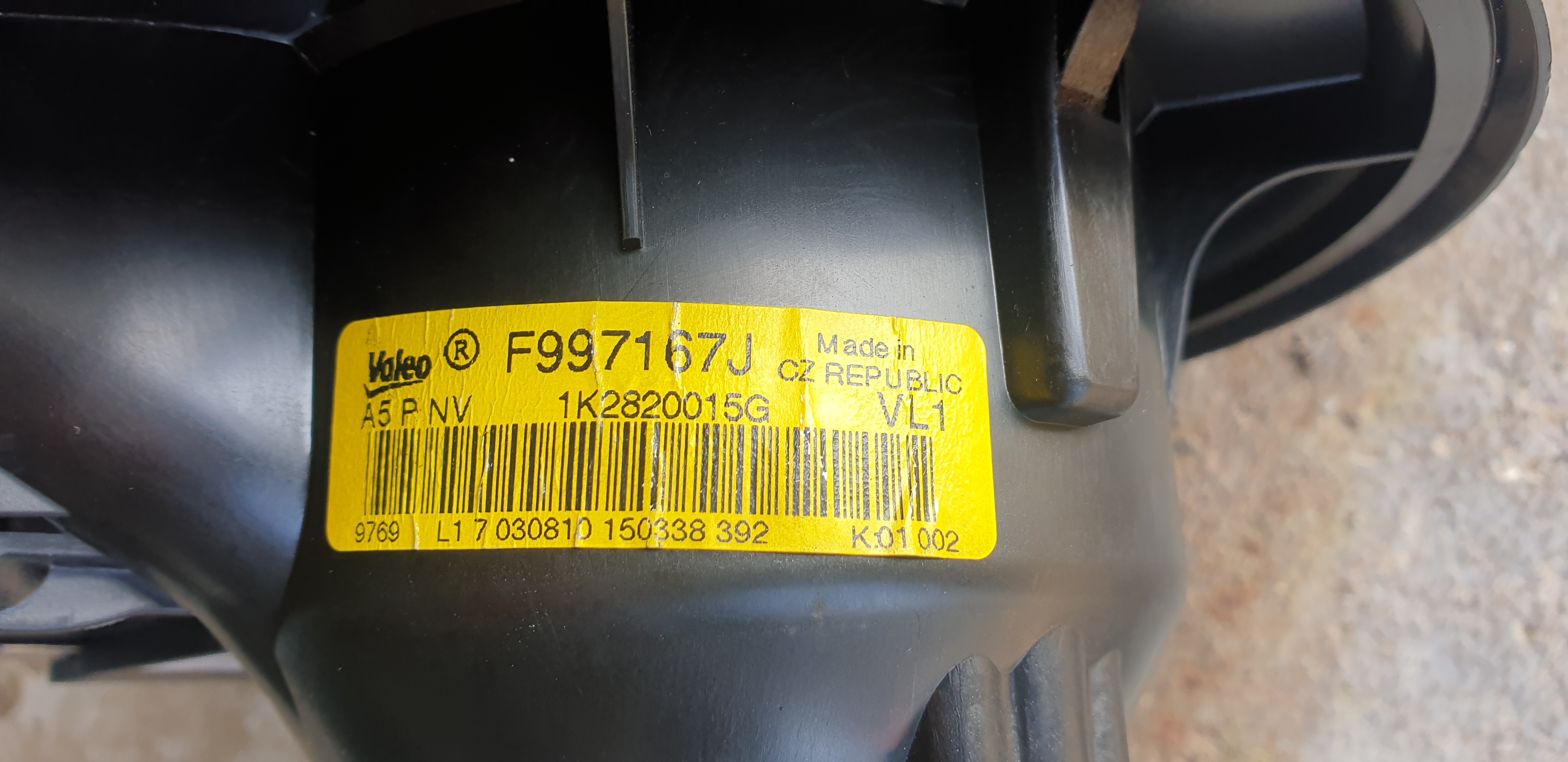

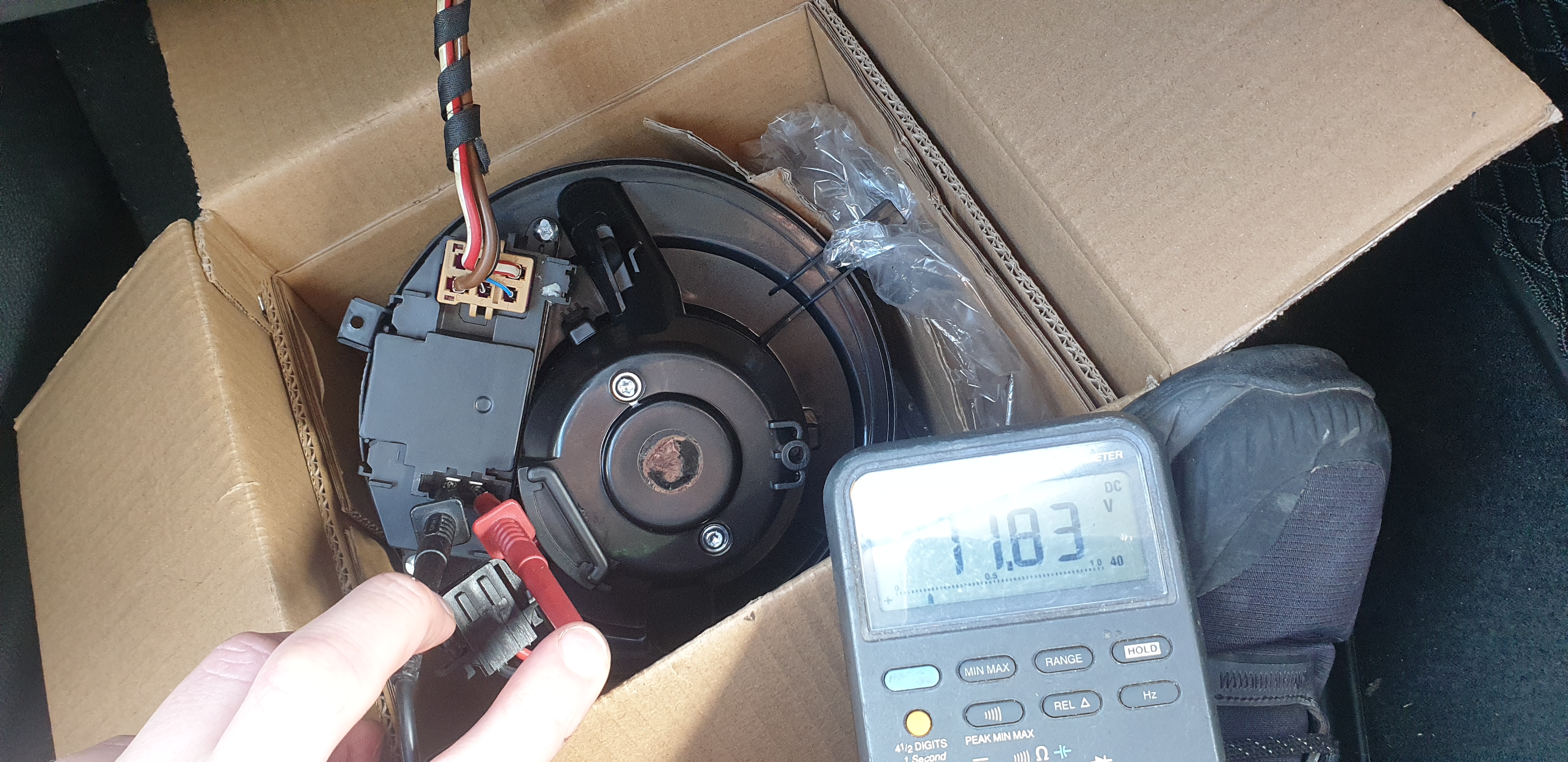

Update for others. Fuses next to the drivers door all ok. Plugged in new and old fans with engine running and disconnected the plug with the red and black wires. I have power at the harness. When the harness is connected to the old fan, if i disconnect the 2 wire plug that connects the module to the fan, im getting 13.85V at my module supply the fan. So my fans dead. The new ebay identical look unit plugged in only has 11.8V at the module and the new fan doesnt work. Ive plugged the new fan connector into my original old module and everything works. So the ebay fan unit either has a dodgy connection or its not compatible because the part number 3C0 907 521 F which is the module part number was missing from the advert despite the seller saying it matches all my codes when asked. The code 1K2820015G applies to the fan unit. Ive asked the seller for a partial refund and will hopefully swap over my original module to the new fan. Maybe purchasing ebay item 2 for £75 was the correct one. As mines dual climate control model and this new fan has the metal heat sync unit on it that was the standout difference between dual climte and standard air con models. Would be nice to know if its the wrong model or if i have a faulty module but I'm not great with electrics.

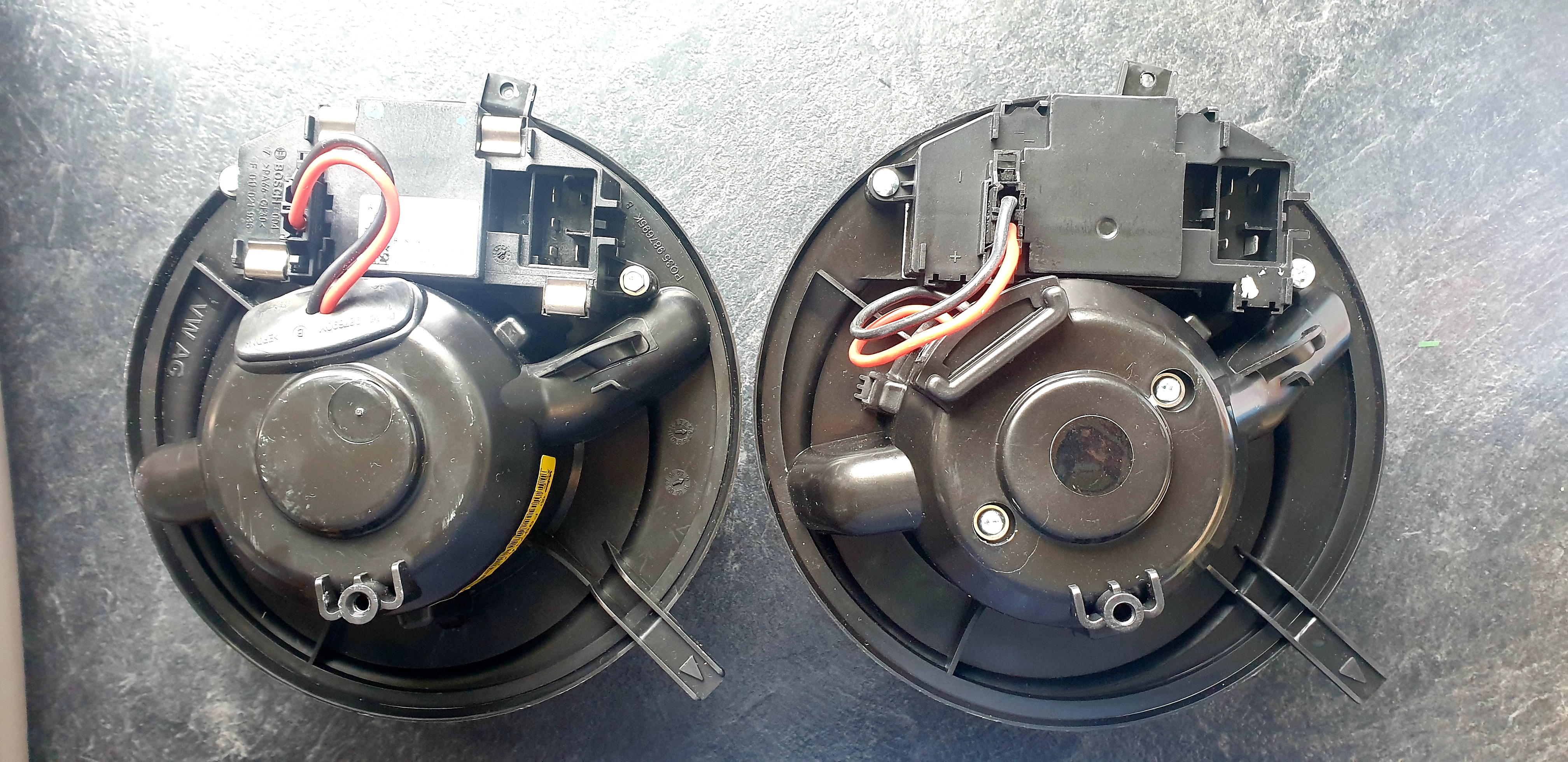

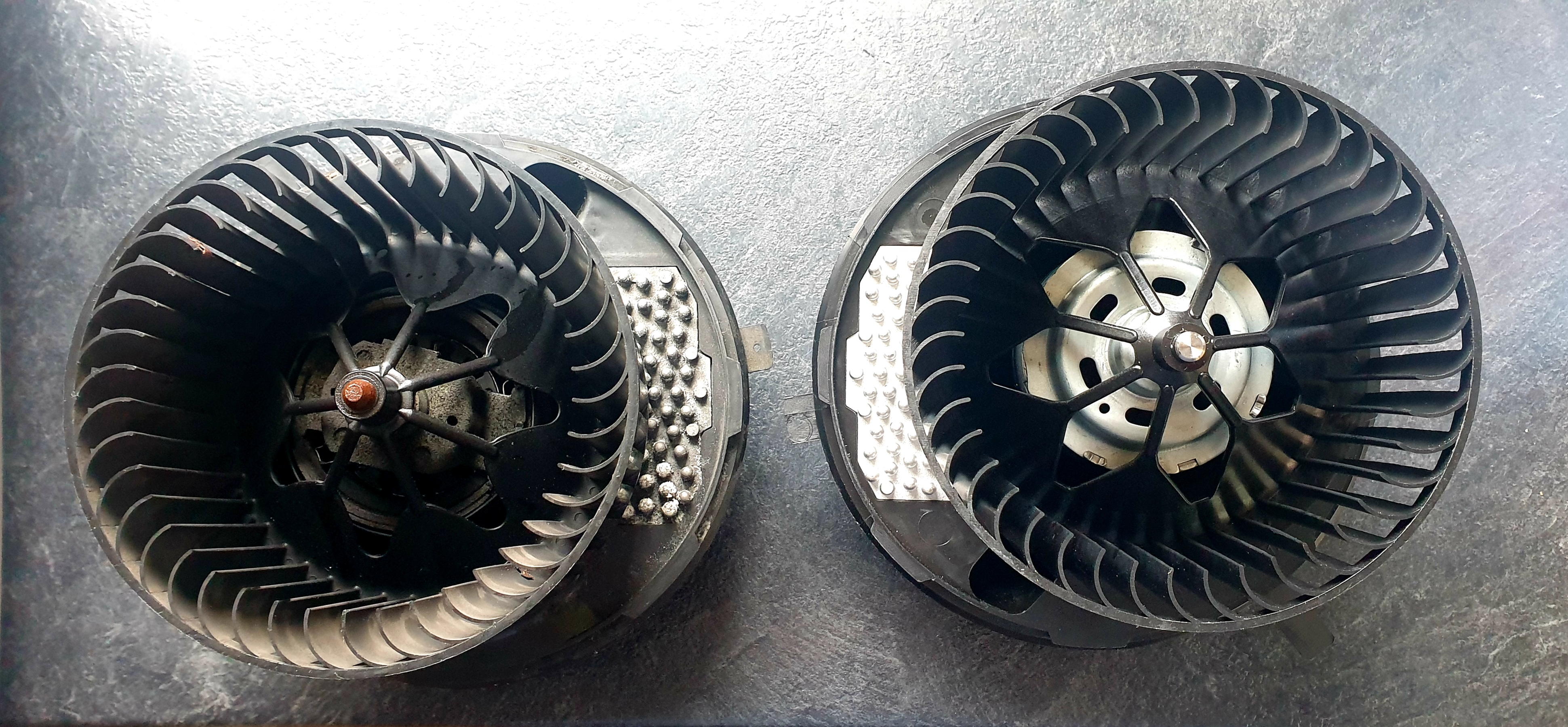

So i checked with the sender from the cheaper of the two and its arrived but doesnt work. I now dont know if this is because of the unit sent isn't compatible, or if its because i have another fault which i dont know where to start with that. I could order the other fan which matched more of the codes. I thought having the visible metal heat sink part would be the correct dual climate model unless they all have this? My own failed fan is so stiff compared to the new one even after spraying it. Genuine model on the left.

Yeah I've gave it a spray and plugged it back in and it done nothing. I'm not sure how free it should be but theres still resistance in the fan it doesn't rotate on its own. The rear demister is now working apart from the rear side glass on both sides for no reason. The more expensive of the two fans has both numbers from my own fan displayed on their advert where as the cheaper of the two only has one of the codes.

Looking for some parts advice please. Ive only just removed this now, managed to find 2 on ebay but unsure if theyll be the correct one for my dual climate control model superb estate diesel. Both links have the same codes showing as my parts if im looking correctly. But they are £25 price difference with delivery. Euro parts was dpuble them prices. See links and photos. The £53.49 link has a matching code of 1K2820015G The £70 link has the 3C0 907 521 F Both have the metal heat sink part attached. https://www.ebay.co.uk/itm/383644361317?mkcid=16&mkevt=1&mkrid=711-127632-2357-0&ssspo=eo3flM5cSvO&sssrc=2349624&ssuid=ik-l4TyNR9m&var=&widget_ver=artemis&media=COPY https://www.ebay.co.uk/itm/155281654077?mkcid=16&mkevt=1&mkrid=711-127632-2357-0&ssspo=rmxY6GIRSX-&sssrc=2349624&ssuid=ik-l4TyNR9m&var=&widget_ver=artemis&media=COPY
