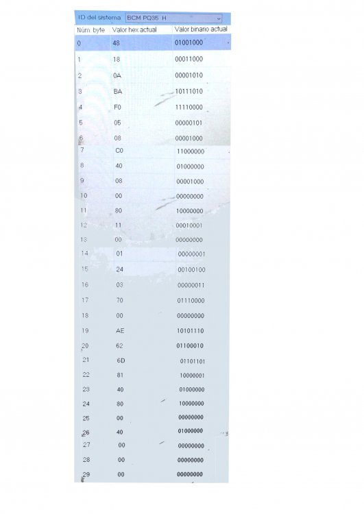

I couldnt do a scan this time. The car is at the shop and didnt have the chance. The problem is that even with the pre-fl xenon control module installed, the car doesnt auto-level the xenon light when starting the car. Also, the lights remaing stable when car at idle, but when I hit the throttle they start to flash as crazy. Due to al this, I was told by the shop mechanics that the car BCM needs To be re-configured (Replace the hex code from the Corresponding byte in list Attached). So, does it make sense to replace “01” with “04” in the Hex column of the line 14? (Screenshot attached). I’m confused haha! Thanks again anyway mate

Hi again! Finally I got to install the older range control unit. Replaced the connector keeping the right order of the cable loom. But turns out that the BCM seems not to be recognising the new control unit. So I took the car to the official Skoda dealer and they told me that they need the new lighting configuration code (xenon + H7) to be written into the BCM via (Odis-e) in order to replace the OEM code (bi-xenon). They aren't able to find out this new config code since they don't have the software and have to stick to my car VIN due to safety policy. Anyway, they offered to replace this light config code via Odis-e if I provide it to them. Any of you could throw me a hand with this? @langers2k may be? I feel I'm about to reach the end but don't want to give up so far! Thanks a lot in advance!! p.d: They gave me a screenshot of my BCM configuration:

So, finally I got the basic lighting done: high beam, low beam, parking lights and turning lights. I had to buy 10 pin connectors since the FL uses 16 pin ones. Picked up the right pins and the connections were made. But! Turns out the range control unit that you mentioned has a diferent type of plug that the one in the FL version. I removed the climate controls and removed the Oem xenon control unit, but the wiring loom won’t have the same plug on the end. So I dont know yet if it’s going to work. I hope so since you adviced it @langers2k, but now Im in stuck in a point where dont know how to continue. Could I replace the plug in the loom and try the old control unit or should I replace the entire loom/harnes? Thanks in advance the help and have a great week you all!
