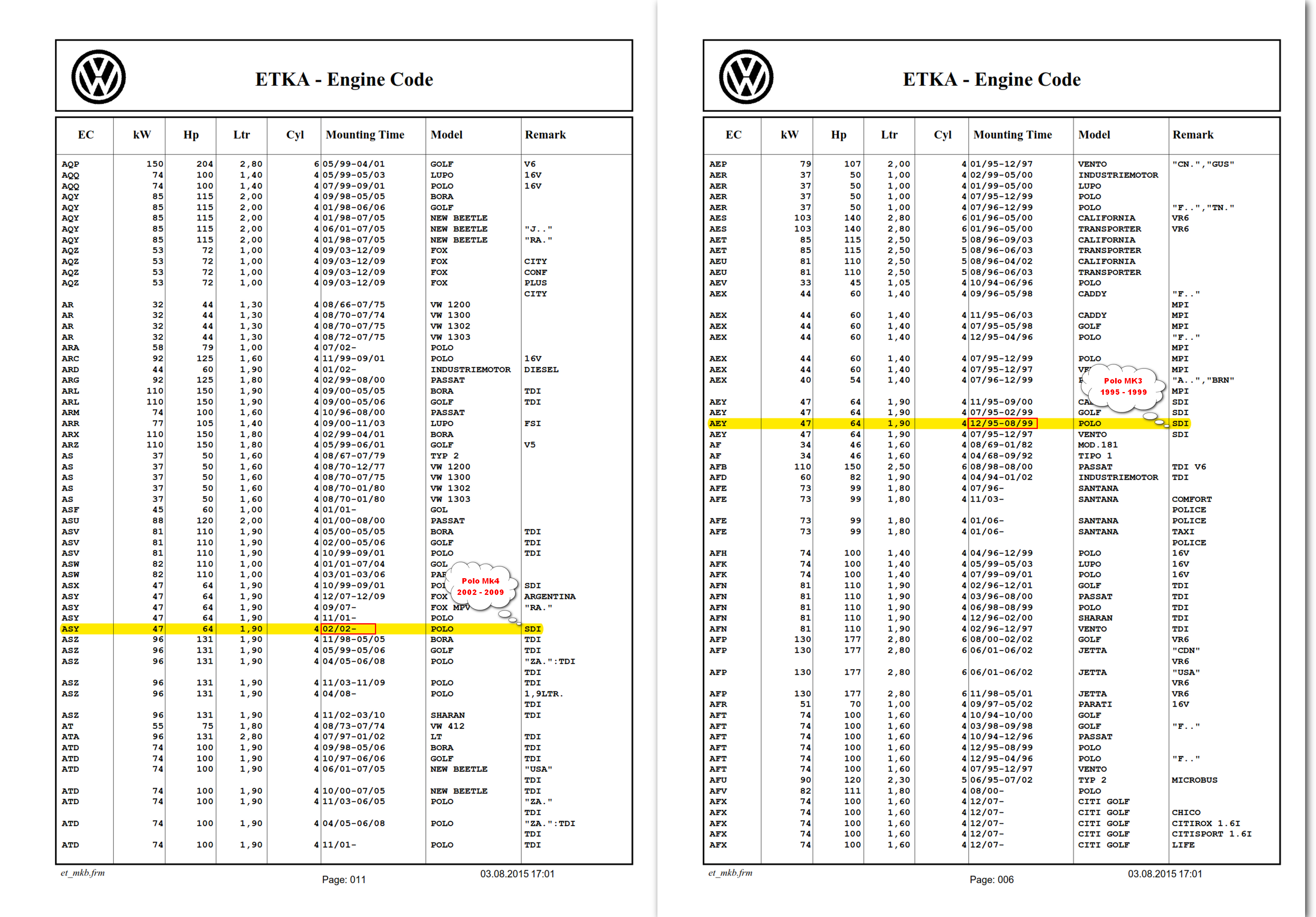

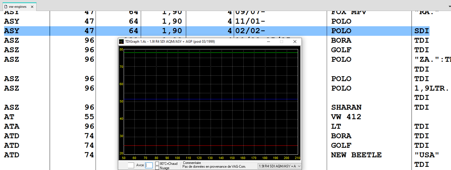

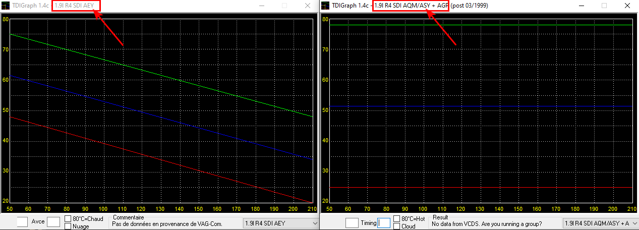

  1. Injection timing graph is different. ASY : fit Polo Mk4 , Skoda Fabia MK1 ... AEY : fit Polo Mk3 I beleave information will be helpful forever. Have a nice day.
  2. Hi, while searching on the internet, I found this old post with my previous comments. So, let me clarify that I'm not wrong. ☺️
