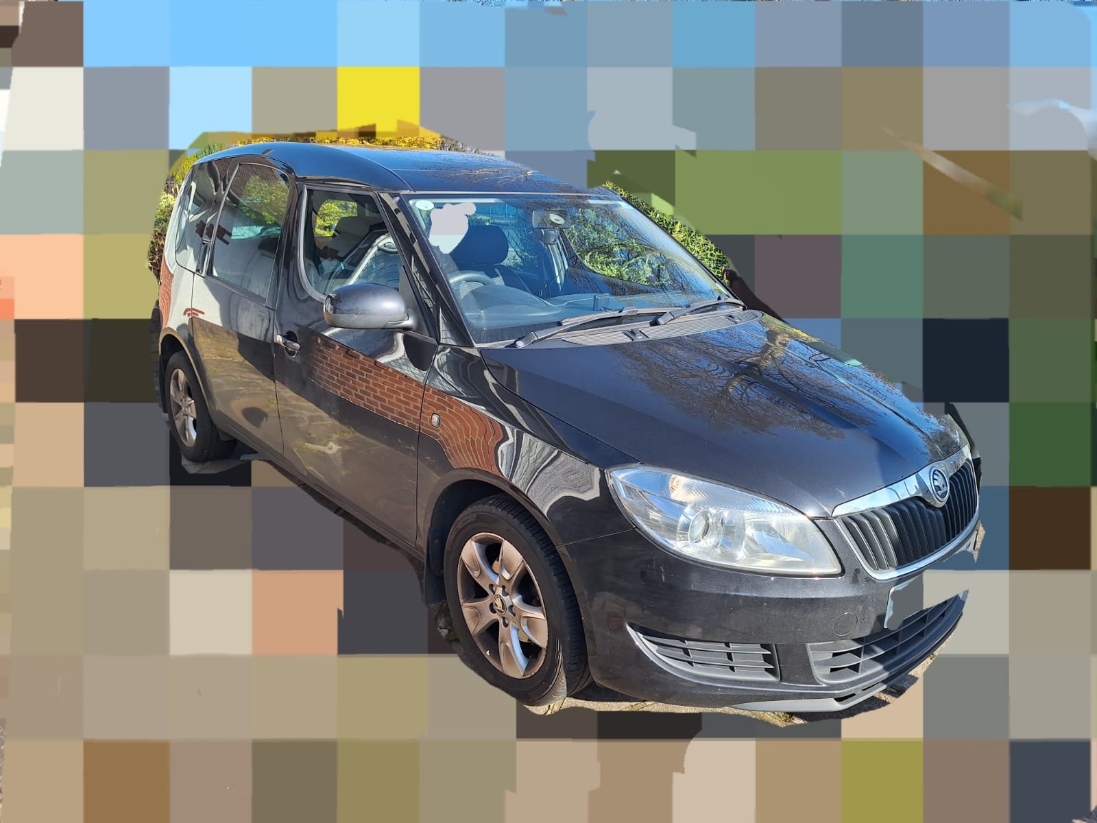

  1. Hi All, It is sad news that I had to say goodbye to my 15 reg Roomster recently. I traded it in for another brand and even though the Roomster is only 9 years old (owned it since brand new/ pre reg) had covered 110k of London miles (not used for taxi but commuting and used it for work) the car has been a very reliable work horse until recently. 3 months ago, the throttle body failed and Skoda garage quoted £1500 for the job but as I had all your knowledge in the forum and also I have a small knowledge of the engine and I like to work on my cars sometimes so I just bought a compatible throttle body and installed it myself in under 30mins and also only cost £75, not really sure where the £1425 difference is going to for the Skoda Garage. Then recently the water pump failed again making a growling noise when accelerating ( previously the water pump was replaced at the same Skoda garage 2 years ago under 30k miles of use. Thought it was the chain rattle/ chain guides needs changing but went to a VAG specialist and they said it just the pump but this will cost £550.00. Since I bought the car for below £9k at the time (Extremely good deal) and right now its only worth around £2.5-3k, i think the time is up to part ways with my work horse. Had a lot of fond memories in that car. This was my wedding car, the car I drove my new born back home with it, went to Europe with the family in it, how I got my first 2 ever speeding tickets with it in Wales when only having owned the car for 1 month, had been my trusty steed moving house with it and a whole lot more. Dont think any other car can compete with the intelligent space it has for such a small car and how useful the car has been to me and my family. My Roomster should be auctioning off now but I hope it will live on giving memories to the next owner (hopefully good ones) and it may pop back up in this forum who knows. It is Goodbye for the Roomster forum and for Skoda, but maybe I will be back.
