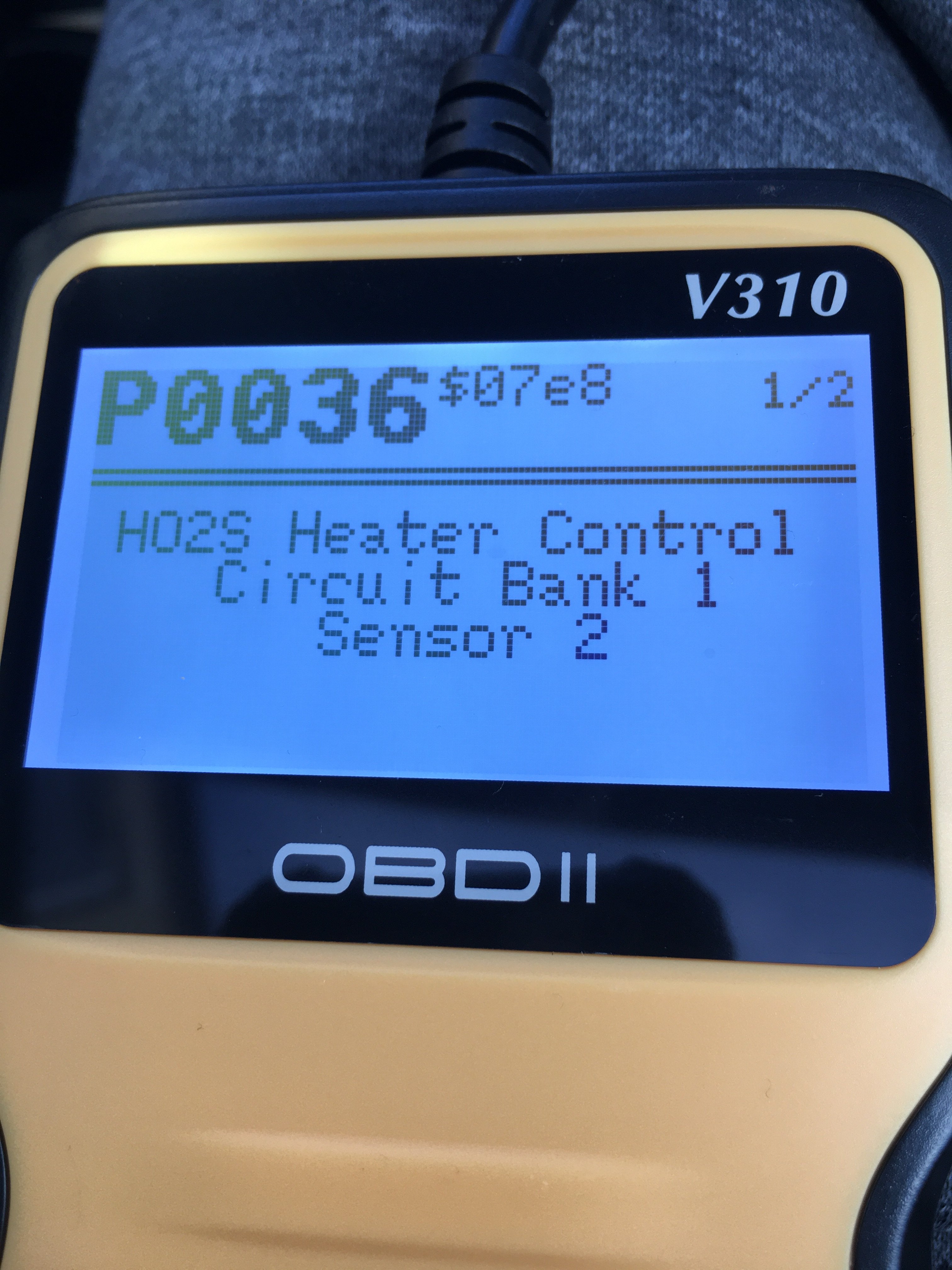

  1. As suggested I enlisted an auto electrician and he found the fault was in the wiring, now sorted.

  3. Had the post cat oxygen sensor replaced yesterday, cleared the fault code unfortunately the check engine light is still coming on and showing the same fault code, I'm gutted 😞

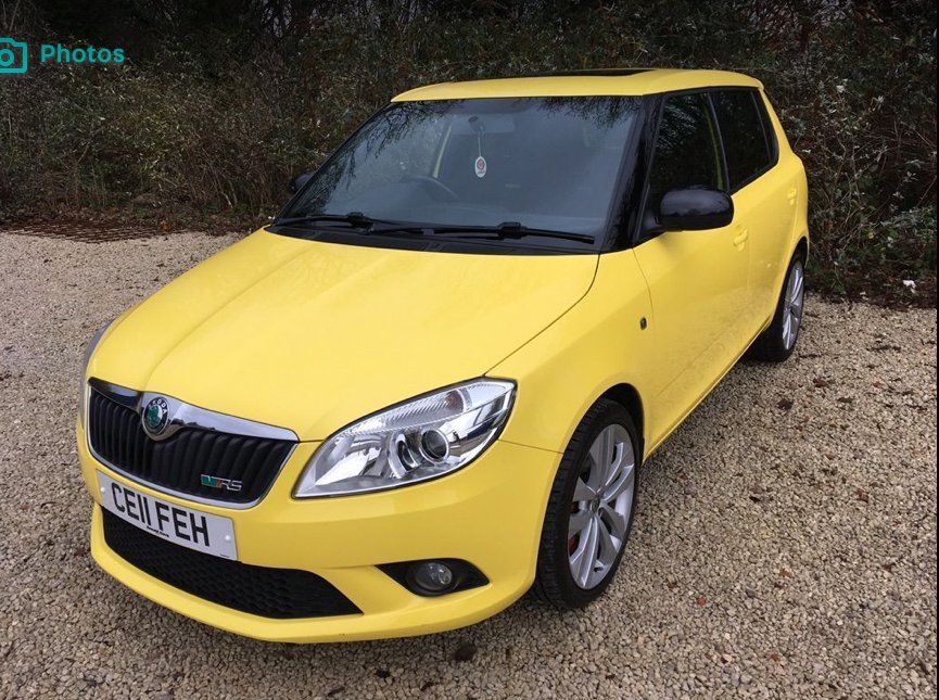

  5. This afternoon while driving my 2011 Fabia VRS the check engine light came on, nothing appeared amiss with the running of the car so I carefully drove it back home. Once home I plugged in my OBD reader to check for fault codes, this was what it read, can anyone tell me what it means and how it can be fixed ?
