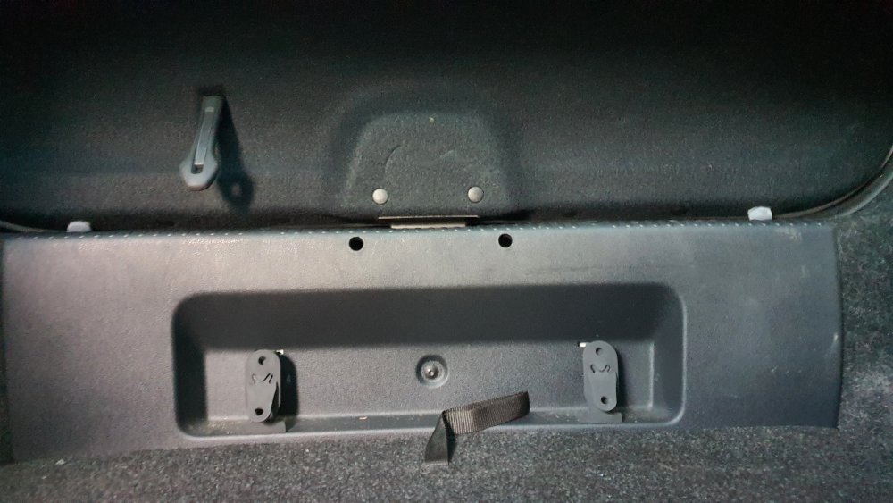

  5. Just taken some photos of the inside of the boot. on a MKII there would just be a section between the straps , which you can pop out which then reveals a lever, but here there is nothing, but apart from a torox screw, I think it is.
  6. Hi does anyone know where to find the emergency boot release switch inside the vehicle. I've seen on the MKII there is a small panel you can remove from the boot, and then it reveals a lever, my car L&K 2017 doesn't appear to have this pop out panel, so wondering can it still be opened from the inside and how?
