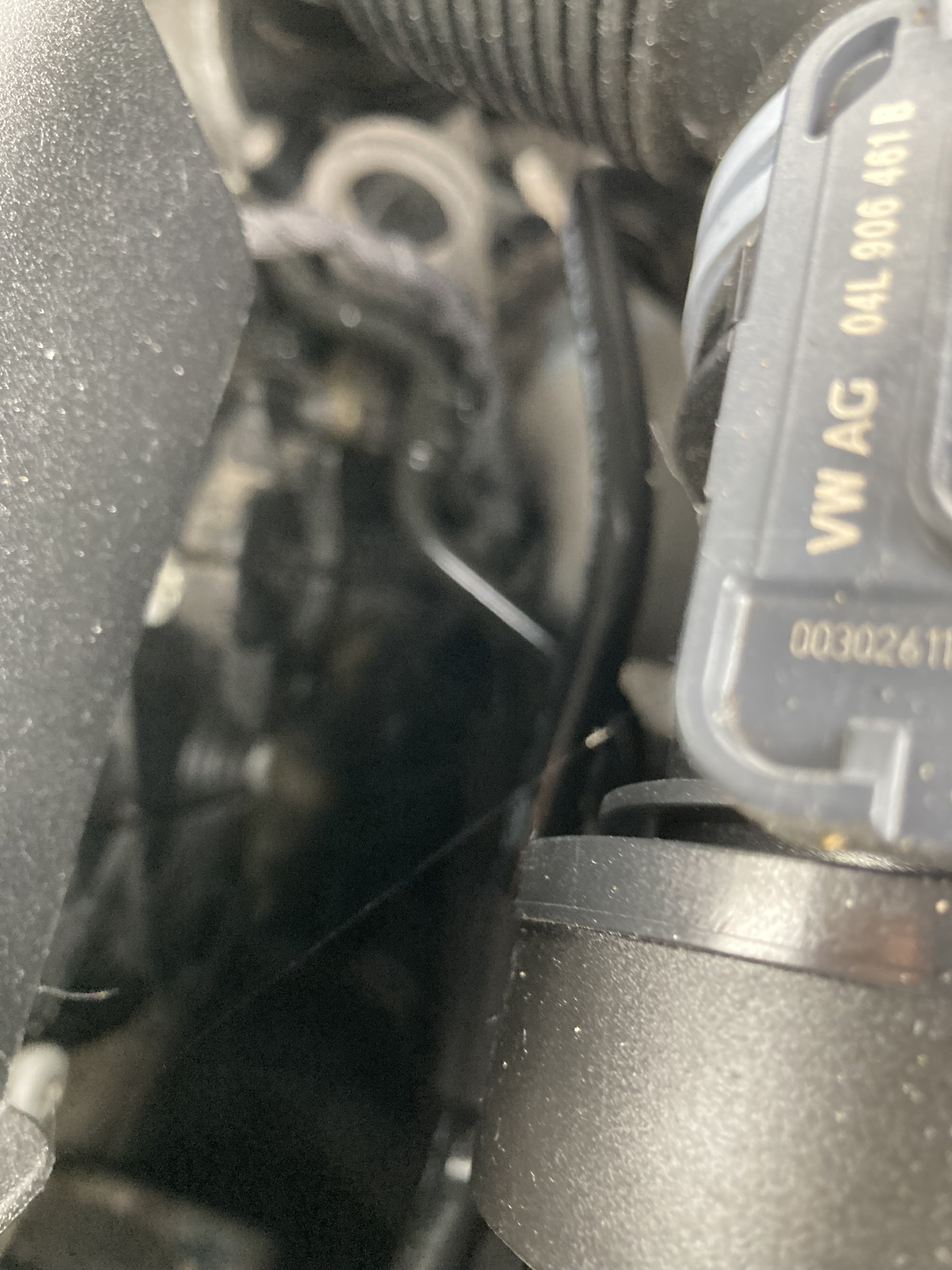

I’ve just checked under the bonnet after a very stop start trip around town and everything is as clean as a whistle that I can see . Still has the smell but I’m hoping that will fade eventually! Car is running better .

Update : Move had a new valve cover , injector washers/ring/njector valves , new leak off pipe and x4 injectors . A lot of money ! Presumably the smell of fuel will subside as any residual fuel burns off from the repairs ?

More info for you all . I had an oil change done a few weeks back and they said you have a leak but we can’t tell where from so you need a steam clean .Unfortunately, nobody in my area does it so I found someone near my work , which is a 45-60 minute drive away from home . I got that done , finally got my car looked at again only to be told that it needs another steam clean ! Going round in circles . So , I had to drive it to work last night for my shift , staying over , I’m now waiting to take it to the same cleaner as before , then a slow journey back home to drop off outside the garage again !

Hi , There is no pooling or puddles of anything on the floor . There is spray across the engine and pipes by the top of the cover and adjacent to the brake fluid reservoir and coolant expansion tank . I have been drinking it for a while with a smell I thought was maybe the clutch plate ! But it is this leak .

Hi. I have a leak of diesel or oil from my Octavia 1.6 diesel engine and I am taking it to get steam cleaned etc today before driving down to a garage for them to check the leak . Is it ok for me to continue to drive my car around ? I have been for quite a while with this burning smell, the garage has said it should be fine but I just wanted some other advice. No warning lights come on and the car runs ok . Thank you.
