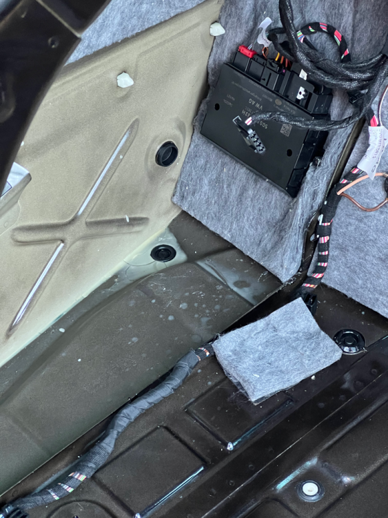

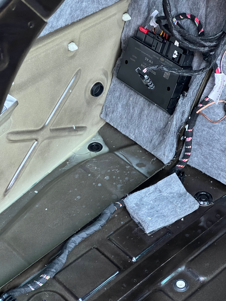

  1. UPDATE: After fitting a new boot seal this seems to have solved the issue (touching all the wood I can find)
  2. Has anyone used an OBDEleven on their Fabia and is there anything good that can be enabled?
  3. so more confused, I tried cleaning up the area around the tailgate seal and then getting a hose on the car and I can see water coming out of a seam to the side and slightly higher than the taillight, All I can think is it's either the tailgate seal or it's getting in through the grommets for the tailgate wiring, but stuffing a rag behind the grommets came out dry, so still fairly stumped and just hoping a brand new seal will fix it, the old one is very loose in places.
  4. I had another look today and I think it might be the tailgate seal, I think I’m going to order a new one.
  5. It's an estate but no sunroof. Where are the rear vents, I've had a look around and can't find any vents. I've just emptied a couple of watering cans over the rear of the car and not a drop inside (we still have a hosepipe ban here 😞 ) I'll keep checking around especially after we have rain. Thanks.
  6. OK, so after removing all the trim and the subwoofer I found a pool of water here, it's at the floor level as opposed to the bottom of the wheel well so I'm guessing that when I'm driving around it sloshes into the wheel well. Next question is where is it coming from???
  7. thank you, was having an issue uploading the image 😒 Now if someone can just remove my junk posts above, that would be great.
