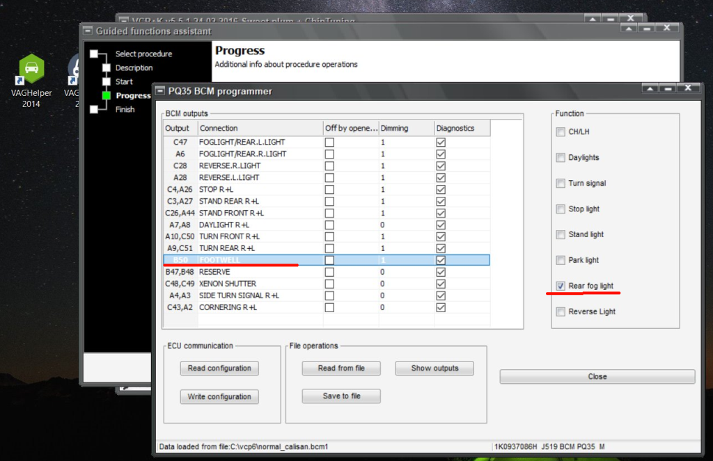

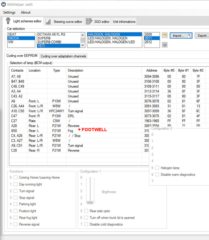

  2. When I connected to the car today using a laptop with Windows 7 installed, it did not give any read or write errors in the BCM. I was able to perform the necessary coding. My main goal was to separate the rear fog light on pin 50 of the T52b connector from the footwell lighting, and to activate and control it independently. However, I noticed that there were no connection terminals in the unused pins. For that reason, I decided to keep the footwell lighting on pin B50. I don’t think the rear fog light being dimly lit while driving will cause any issues. It will light up at full power when the door is opened. Additionally, when the rear fog light is on in foggy conditions, the footwell LEDs will also be at full brightness. Since it’s usually not foggy, this won’t be much of a problem. // This time I translated it into English with chatgpt.

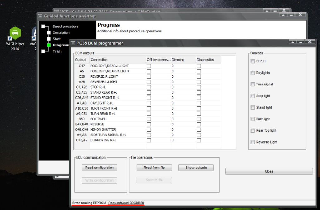

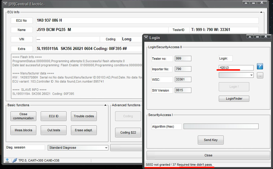

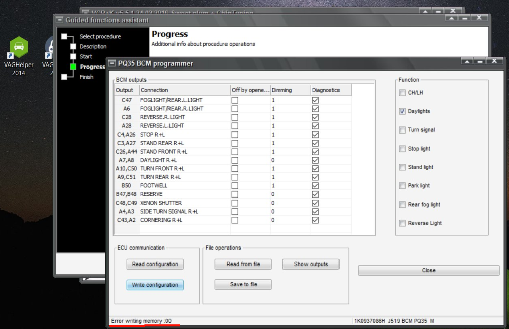

  3. Hello @Szogun, in the video I shared, I had to enter many places while searching for the pin assignment made with a different version of VCP in my VCP 5.5.1 version. As a result, VCP does not read the lighting profile and gives the following error. Also, I cannot print the file I prepared with VAGHelper. Then it gives an error too. But I can get into Coding $22. I did Byte 18 in 00, I did it in 1D (Yeti 5L), nothing changed. If Byte is not already 18 00, whatever lighting profile is selected takes priority. It does not take into account changes prepared with VAGHelper and saved with VCP. In fact, it is clearly visible on the screen where the lights are adjusted that the B50 has foot lighting. It would be enough to assign the profile I prepared with the existing VAGHelper_2014.09.10_0.0.1.18 and VAGHelper.X_2.0.0.7, assign the rear fog lamps to an unused pin and physically move them. I couldn't think of this point before I started poking around.:( The fact that Byte 18 is 00 was not fully understood and explained in many forums on this subject. I realized this was the case when dealing with VCP. Byte 18 must be 00 for subsequent changes to be valid! The reading and writing problem may have occurred after entering the Security Access Key below. Does anyone know what caused this problem? If I reset the BCM to factory settings, will it be fixed? // Since English is not my language, whatever Google translate translates... ;)
