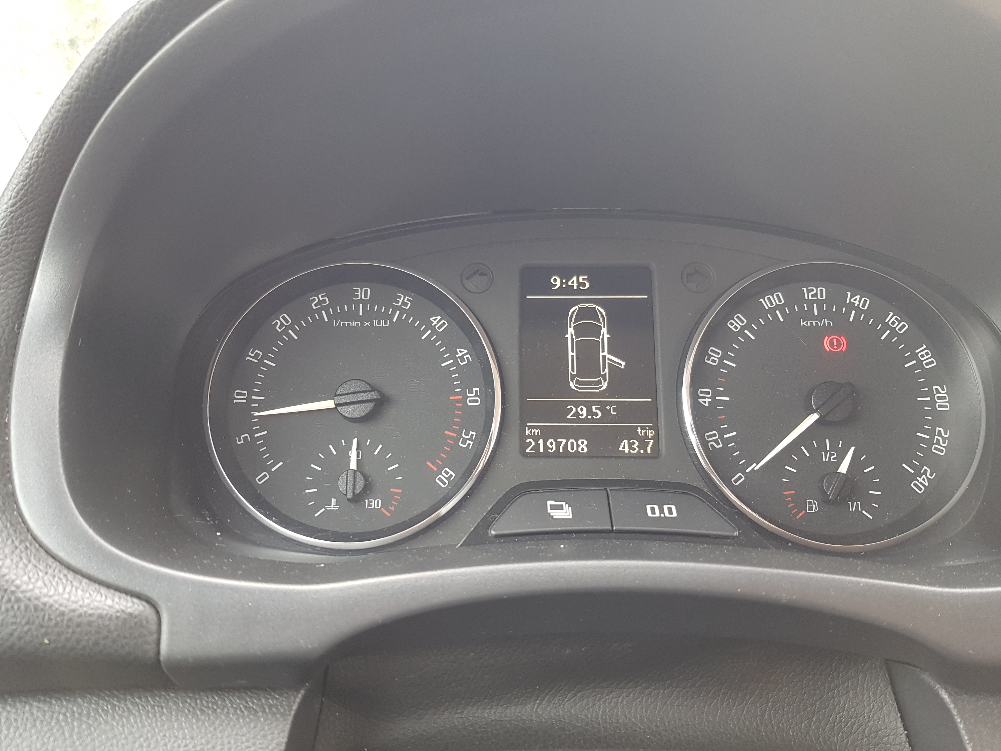

  1. Just to confirm, problem solved, engine heated up and still on 750 revs .....

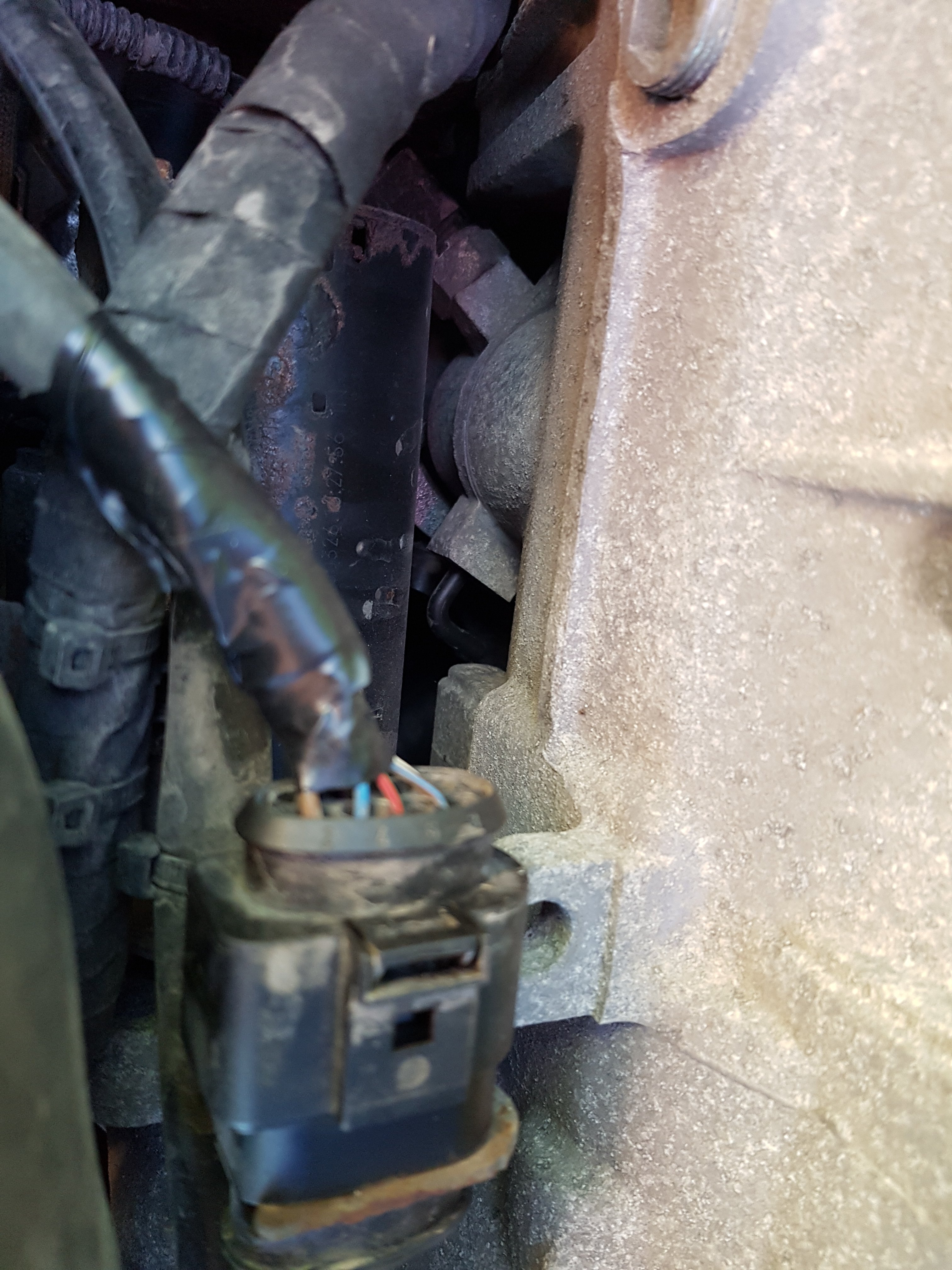

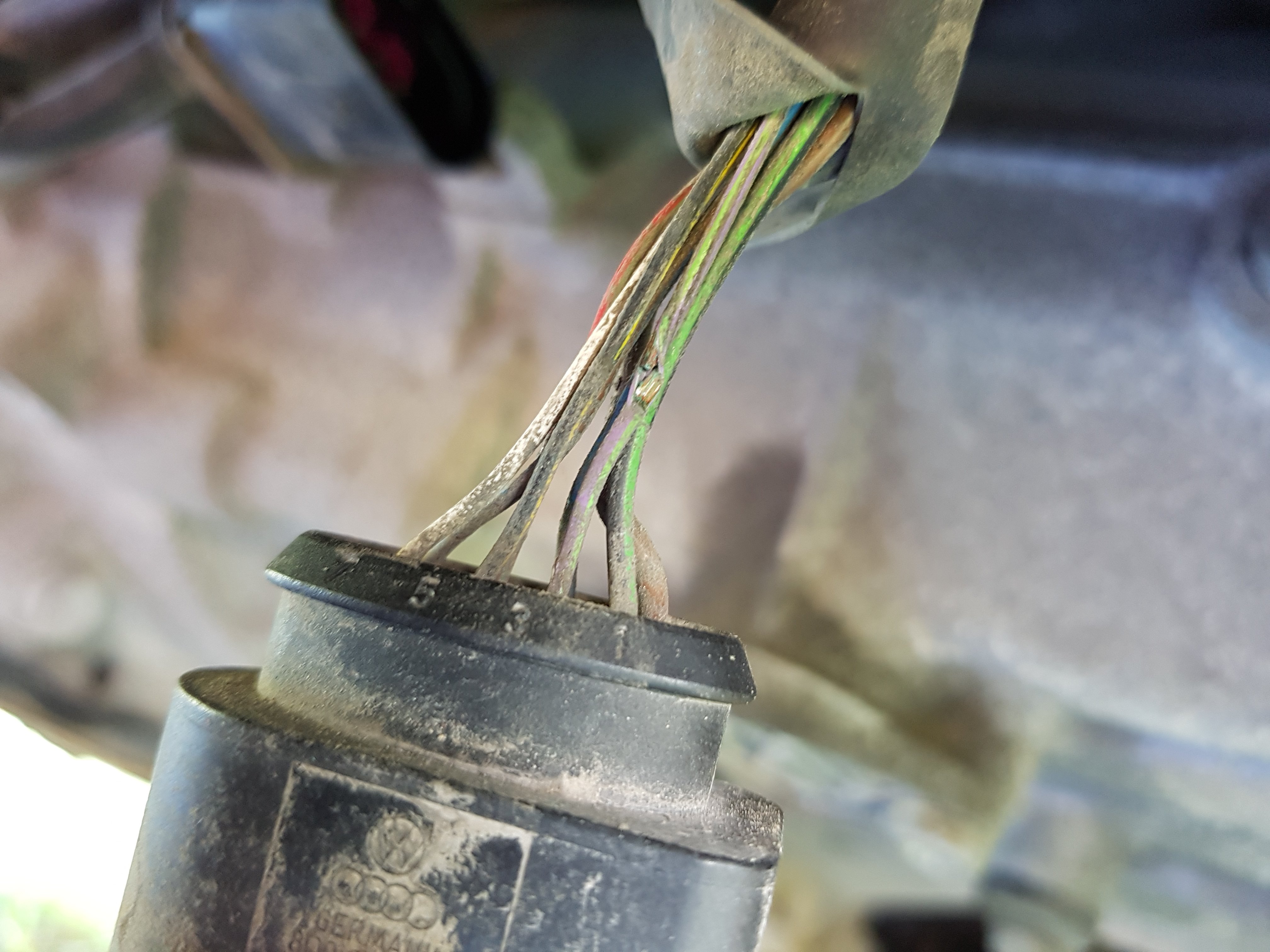

  2. Dear friends, today I managed to locate connector. It was under engine on same side as battery. After I disconnected connector I found broken wire on pin 3 as Wino assumed. I will post pictures. Did not tested car yet as I just finished this job but I hope it will be ok. I will post the results. And I can not find words to express my gratitude to both of you. You are great guys, thank you both

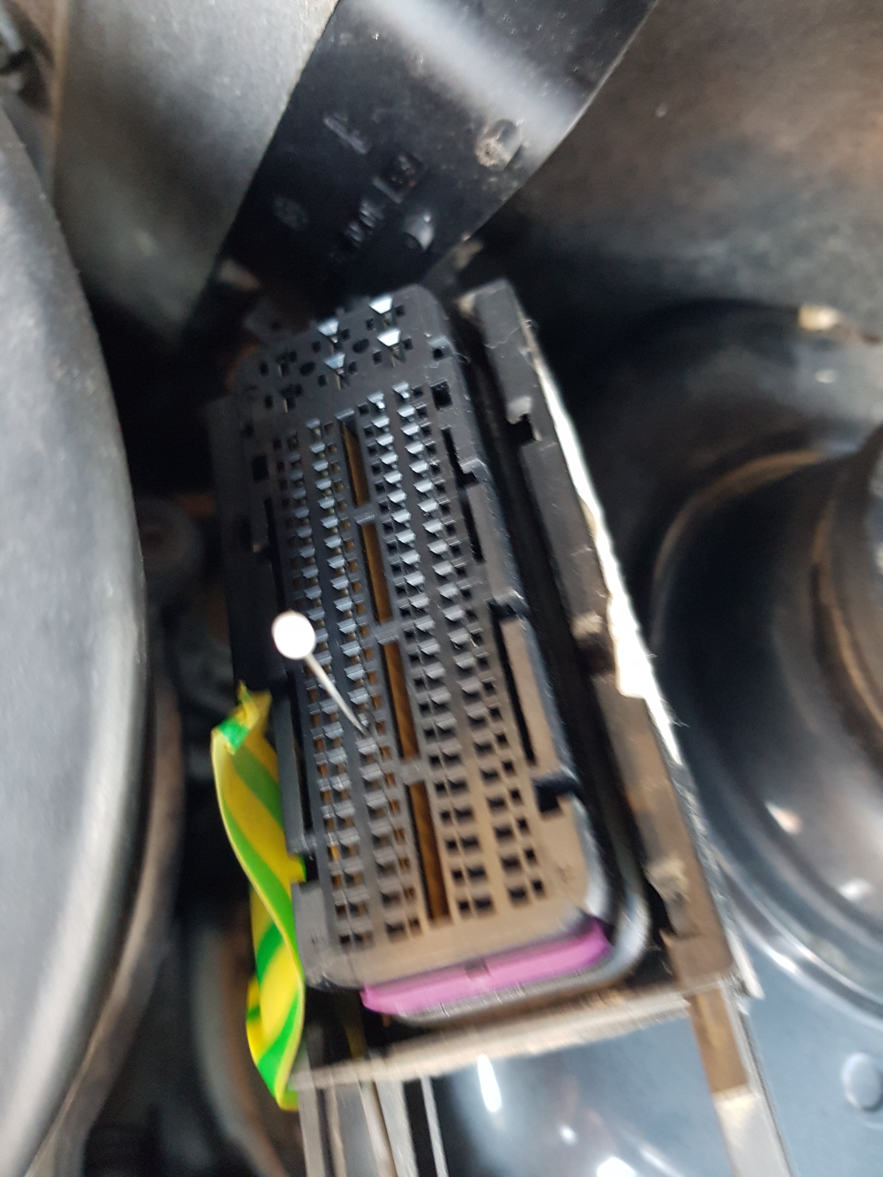

  5. Dear Wino, yesterday I managed to check this in a way you recommend. I disconnect ECU connector, upper one and found pin 65, mark it with needle. Other end of multimeter connect to red pin on alternator connector and there is no connection at all. Other connector you mentioned not sure I identified correctly. One I found on left side as seen from cabin has 13 pins and on it there is no connection with alternator connector. I posted some pictures.
