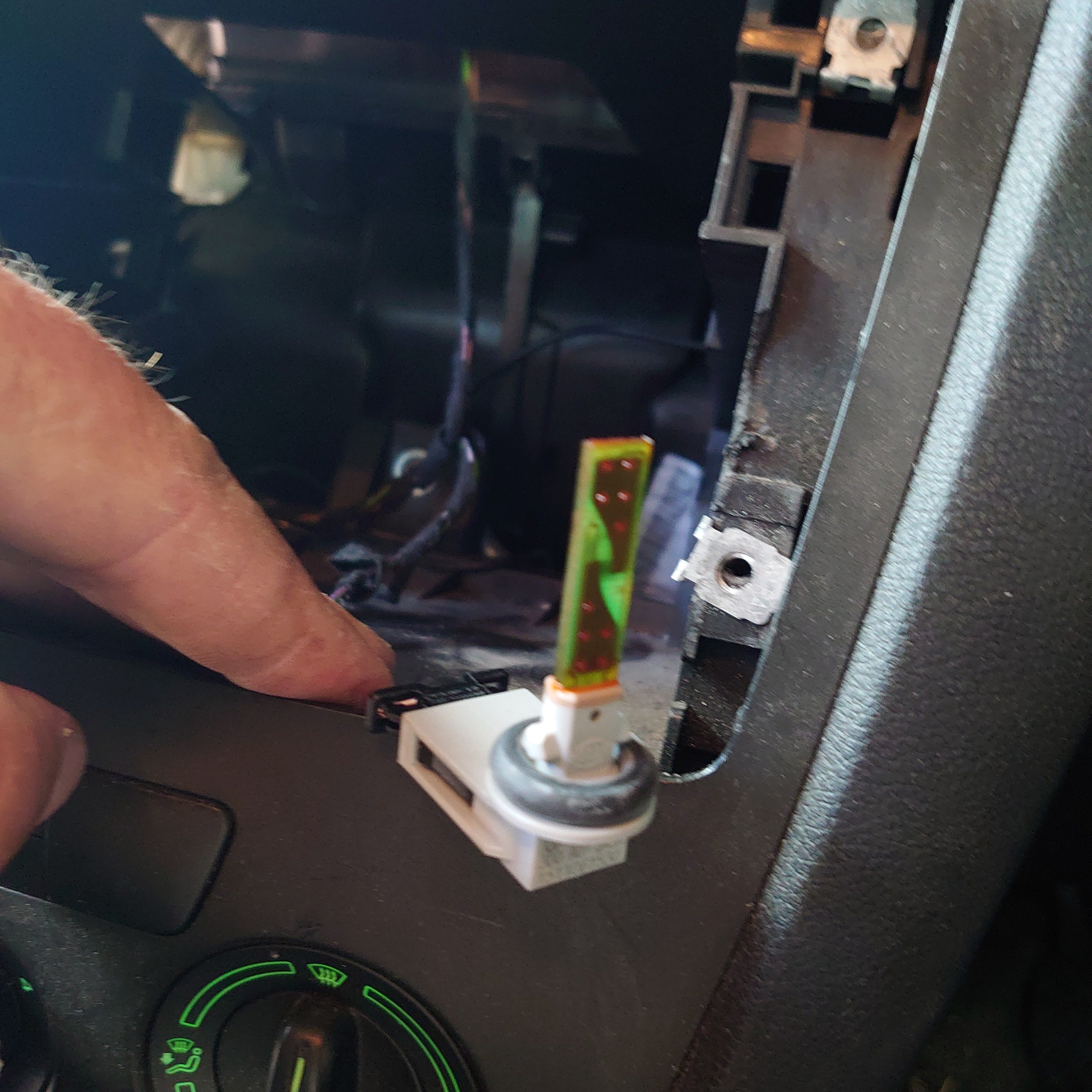

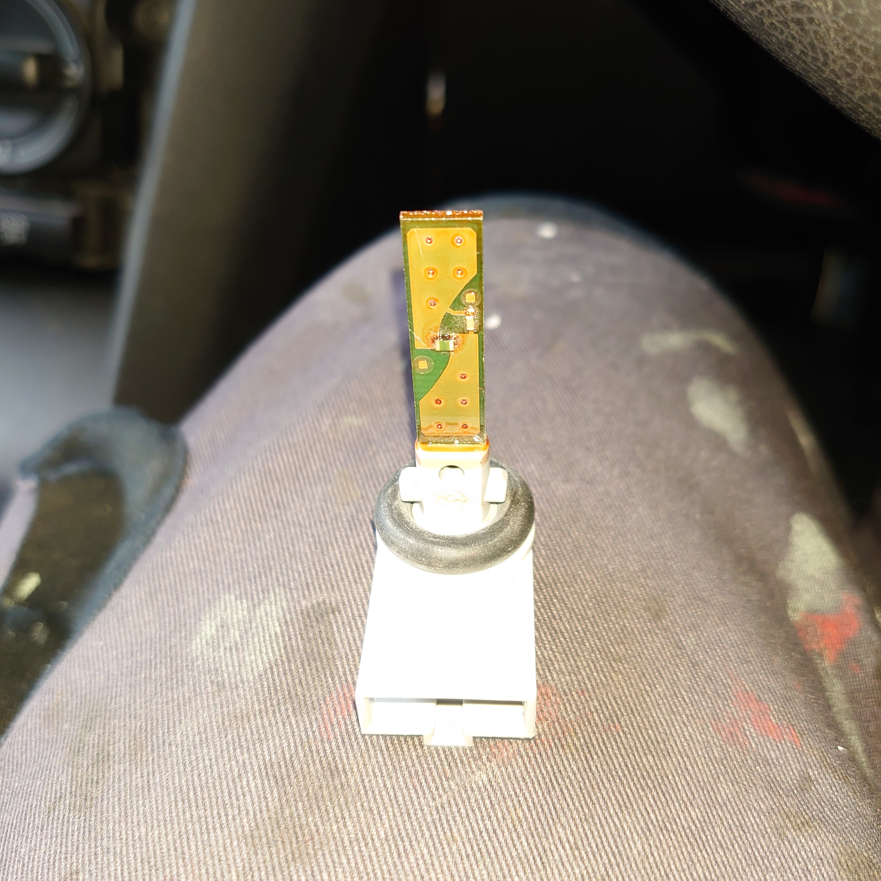

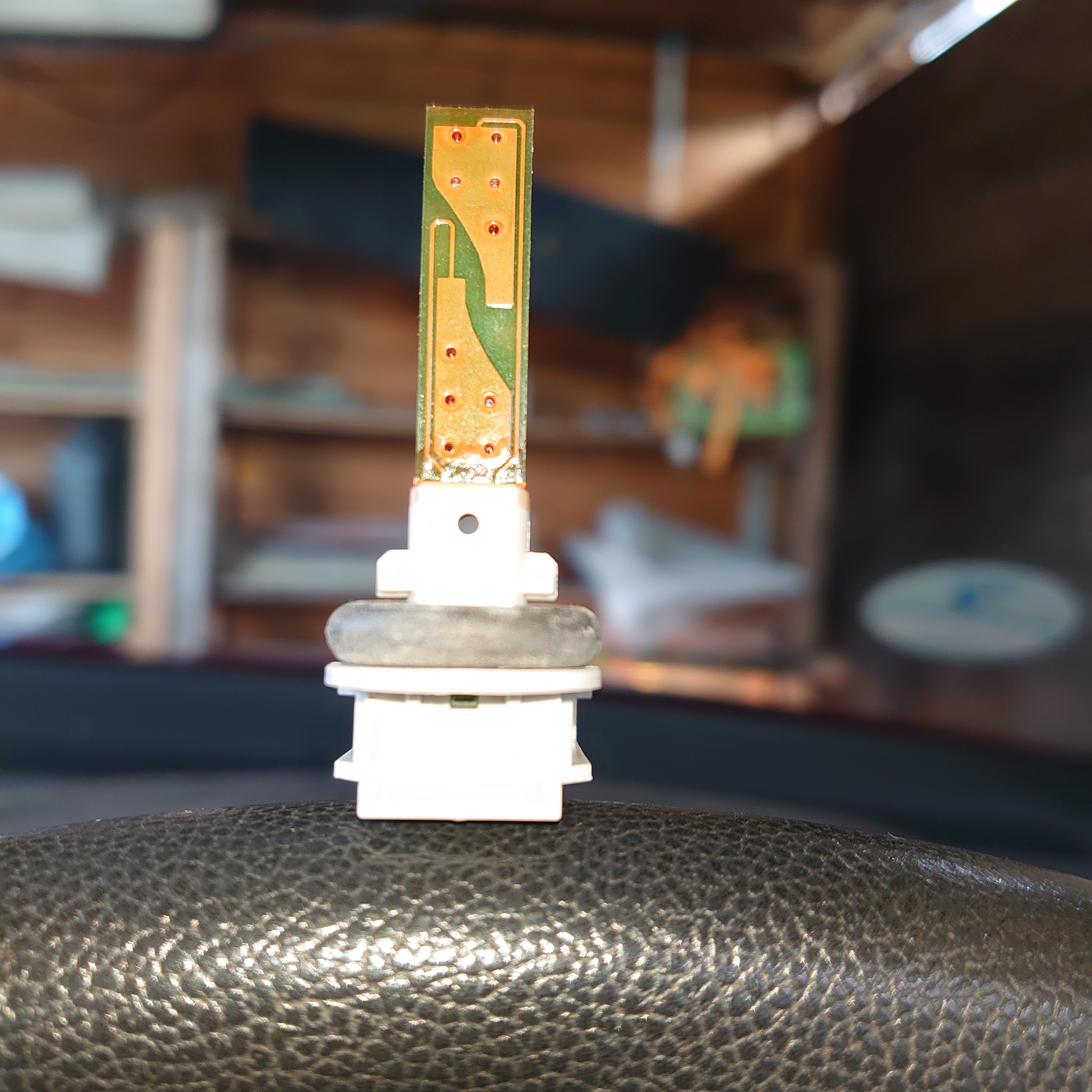

Google gives it as a internal temperature sensor . Probably why my heating is alway wrong just need to find where it goes . Thanks
Thank you ill have a look just not lot of room to see anything heres the other side . Thanks
Hi all ive just been changing my radio and have found this hanging to the right of the compartment. Can any one tell me what it is and where ir belongs as i cant see a place for it . Thank you
