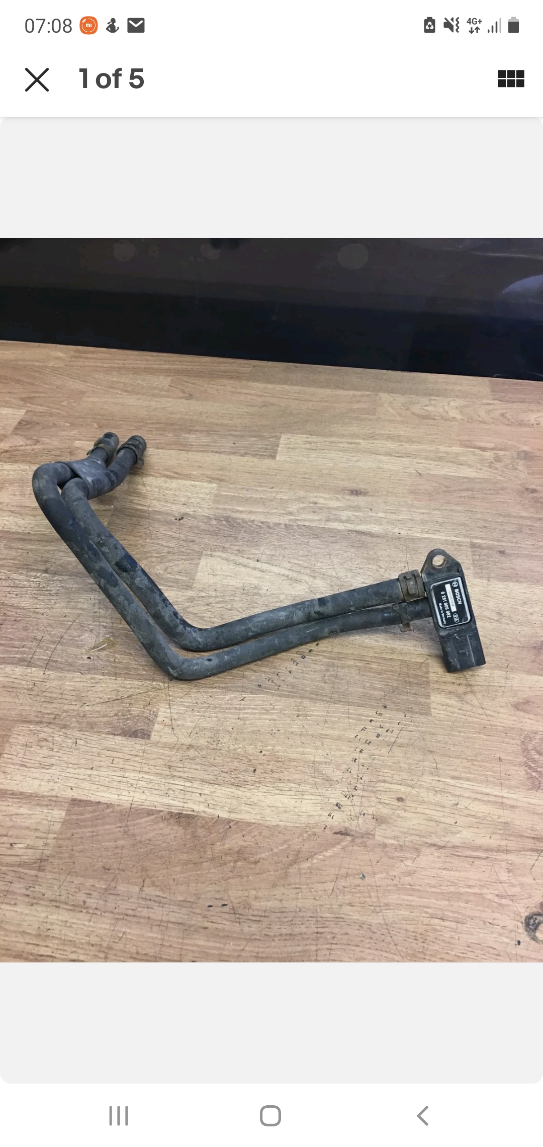

  4. Hi. I've replaced the brown sensor which is not accessible easily. I am still getting a yellow light on the dashboard. I attach pictures. Where does the black plug sensor go? Do i need to replace the orange sensor? There are two slots. My mechanic has said the diagram showing the DPF doesn't correlate with my engine? Any help or suggestions are much appreciated. Thanks
  5. Brilliant thanks. If I take that part number you mentioned to my parts place they should be able to order it? So the brown plug leads to the one I need to replace? Did you diagnose the issue yourself before fixing it? Thanks

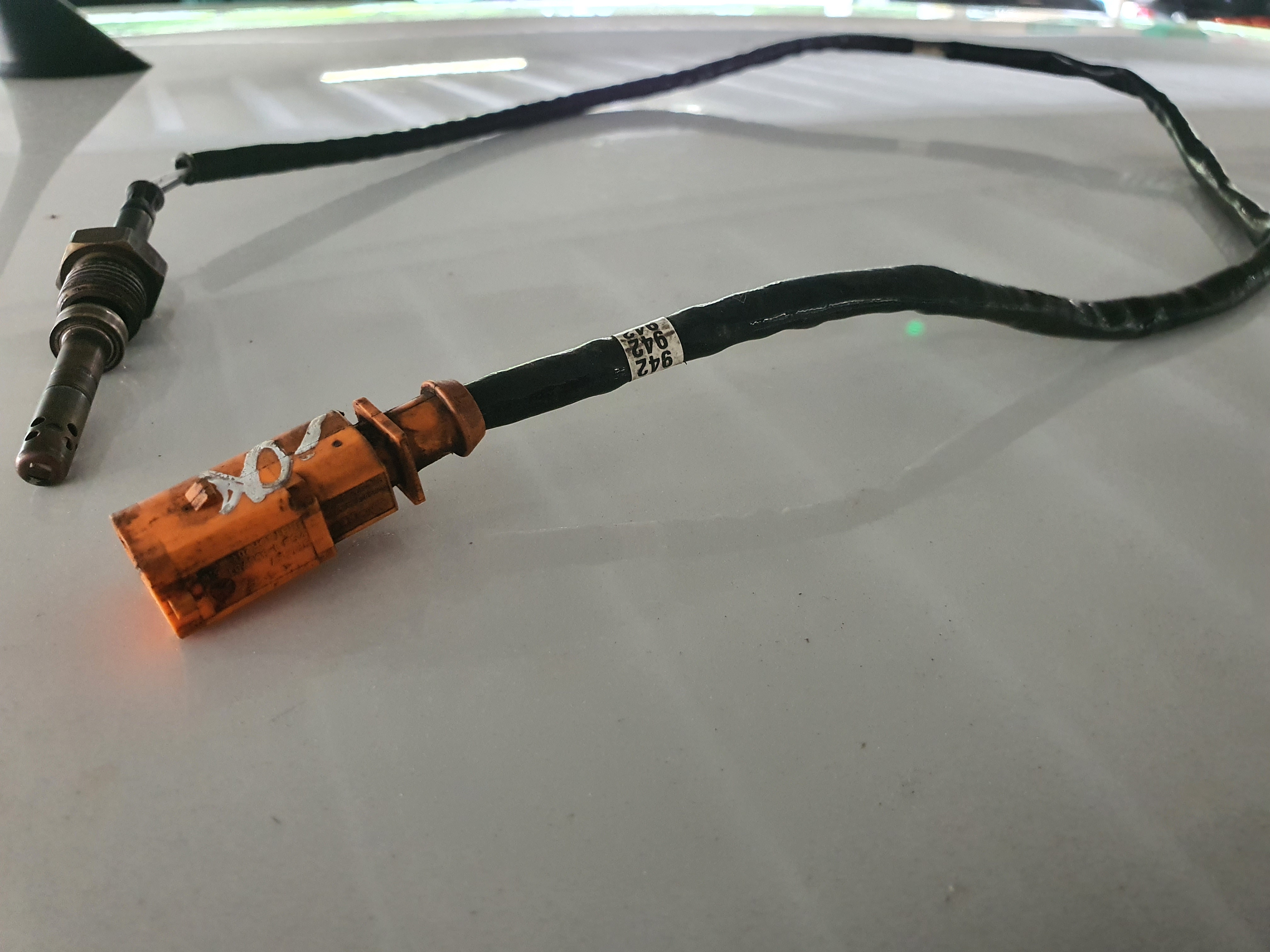

  6. Hi. I am having difficulty describing the sensor required to the parts place I usually get my parts from. They are saying there are three sensors, two by the DPF and one by the turbo. Now the one I have replaced pics earlier in the thread was the wrong one according to the autoelectrician. Does this brown plug number 3 sensor before the DPF replace this orange end one or go alongside it? I am asking as the parts place have my reg number and are saying the part I need is the exhaust gas temperature sensor. The autoelectrician says its the DPF temperature sensor. He says its very similar to the exhaust gas temperature sensor. If I put the part number in ebay as advised in previous posts something totally different to the above comes up. I am out of my depth here I know, I just want the right part so I know I have corrected all issues before selling it on. Thanks for your help everyone.
  7. Brilliant thanks. Will have a look and see if I can find it on Ebay.
  8. Thanks everyone. I'm just confused with the brown/black end of the sensor. The before DPF sensor 3 is that the above or the black end as mentioned in an earlier post?
  9. I've had a look on eBay, this is a brown end one fitting the description the autoelectrician gave me.
  10. With regards to the original sensor problem, I had an autoelectrician look at it and bring up the codes on his computer. Apparently it's the number 3 sensor DPF temperature sensor that is very similar to the sensor no4 that I have replaced in error. Its before the DPF. I can't find it on ebay and the parts place I have asked I'm apprehensive about as its £80. If anyone knows what it llooks like that would be great, he said u need it on the ramp it's a two pronged sensor. I'm wondering if it's the one already posted on this thread? Any help or advice is really appreciated. Thanks

  15. So if I am right, I will not know what part I need without removing the one that needs replacing? The scrapyard I have been to have given me the correct part but the garage across from me have said it has the wrong connector on it? I'm assuming the connector is specific to the car as has been advised above? Thanks for your help.
  16. Right thanks. Car wouldn't move this morning so now an injector needs putting in too. Apparently shouldn't happen in lower mileage cars.
  17. Thanks for your help everyone. Do I need a connector on this then? Or a whole new bit? My mechanic has advised to return this and when I go to the scrapyard have him give them a call.
  18. Good morning all. I was given the wrong sensor by the scrapyard I went to, apparently the sensor has a right angle bend so my mechanic says. So I've been on ebay this one is for a CAYA engine code. Mine is CAYC. Anyone know if it will fit please? Many thanks.
