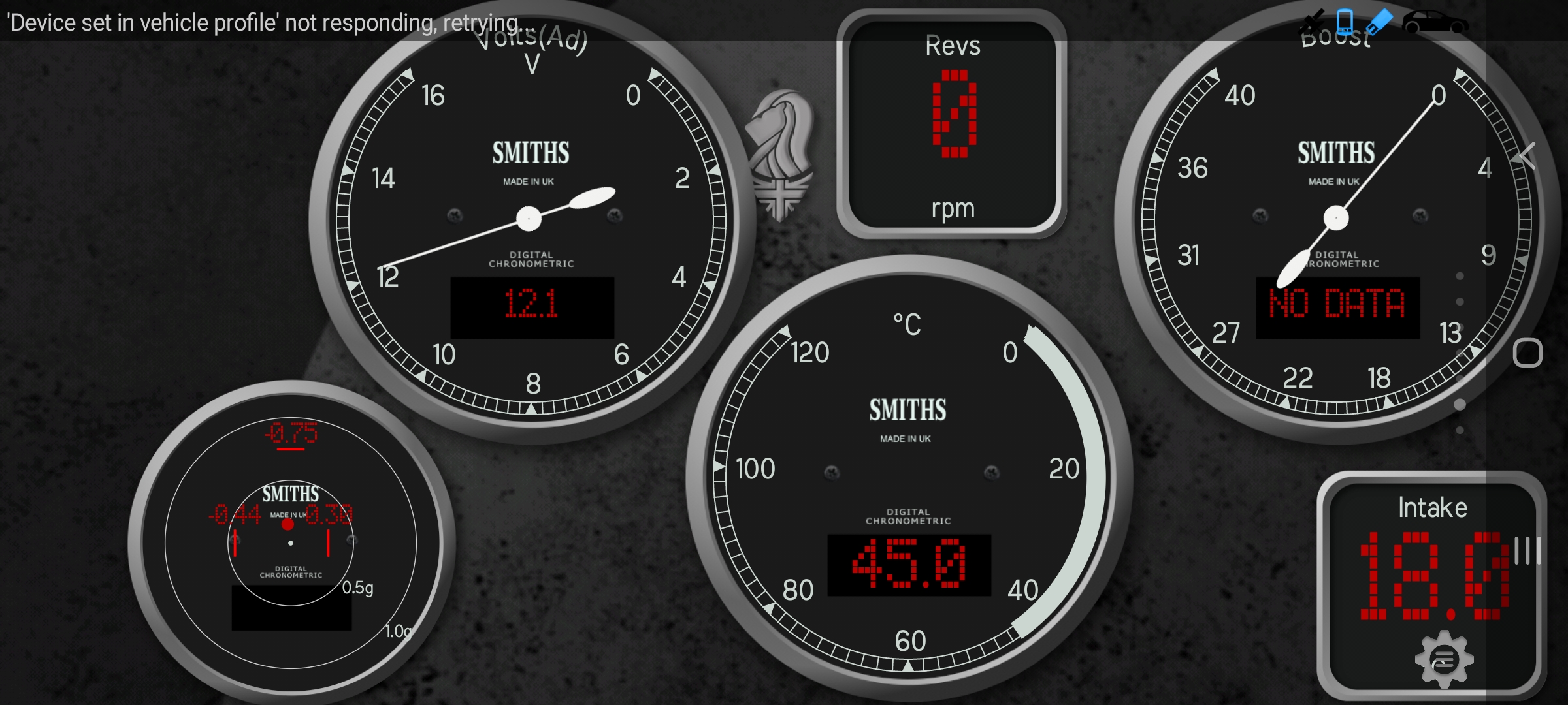

Torque Pro is an app you can get for your phone, on the play store and app store. I think its 4 euro iirc, well worth it. I have a few elm327 OBDII dongles hanging about. I use it in the mk2 to read Volts, Water temp and Boost. I have a vent mounted phone holder and have it so I can easily glance at it on occasion.
You can set warnings on it too.
If you couldnt guess, i'm a fan of it. Used to run it for water temp and volts in the mk1 but mainly keep it connected to the mk2 as thats what I'm driving 90% of the time now.
