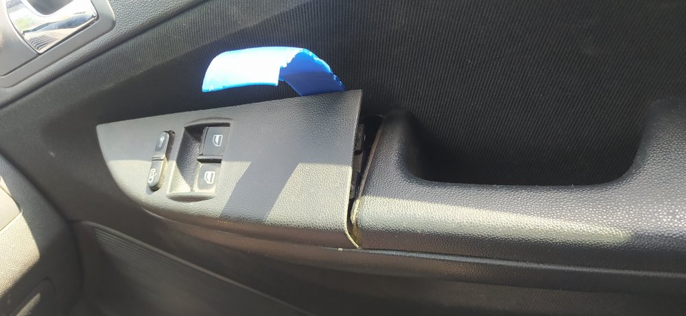

How to remove window switch
I've just removed it by cutting an inch wide strip of plastic, from a 5 litre oil bottle and sliding in from above. Attack at the gap between the door card and the handle\switch assemble. Took less than 20 seconds on my first attempt. My question is what size of the torx screws likely to be?
