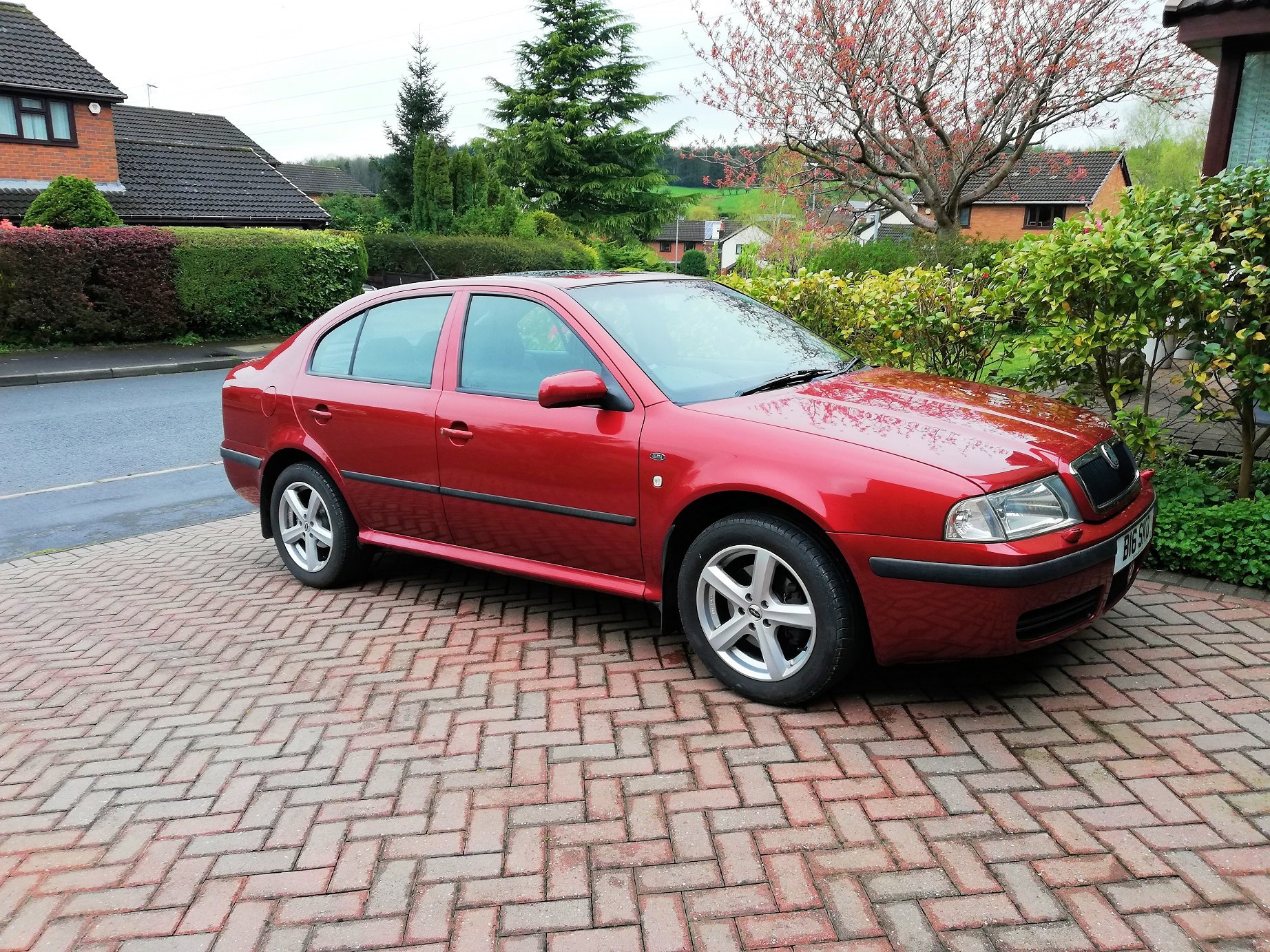

My car is running just fine having now done a few miles short of 212,000. I bought it from a local Skoda dealer as an ex demonstrator with 4,384 miles on the clock 22 years ago. The years have been passing for me too and I was 80 last year. Recently I put it in the hands of a local, highly recommended garage to have new rear disks and pads installed. They called me to tell me that on inspection they had found the N/S rear coil spring broken. It was no surprise. That one was its third and the O/S was wearing its fourth. I said they should replace it and they did. I soon noticed problems driving up the potholed hill to our house. There was a thump that sounded like the exhaust had a bit of free movement in it. I asked them to check it but was surprised when they said there was nothing wrong with it, or anything else. I decided that it was most likely that the new N/S spring wasn't as beefy as the one it had replaced and crawled under the car with a Vernier caliper to compare them. Just looking was enough to establish the difference. I'm not interested in beating the guy up, I just want to get things sorted so I phoned the local main dealer parts department. They were helpful but said the part was no longer available. The O/S still looks fresh and is labelled with two blue and two white. They told me the part number is IJ9511 15G. I know there is a low chance of getting hold of one but if anyone can suggest some coil springs that will be comparable replacements for the blues and whites, I'll get a pair. Thanks.
