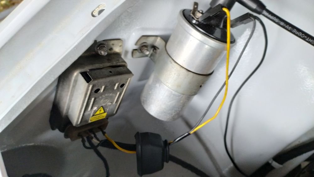

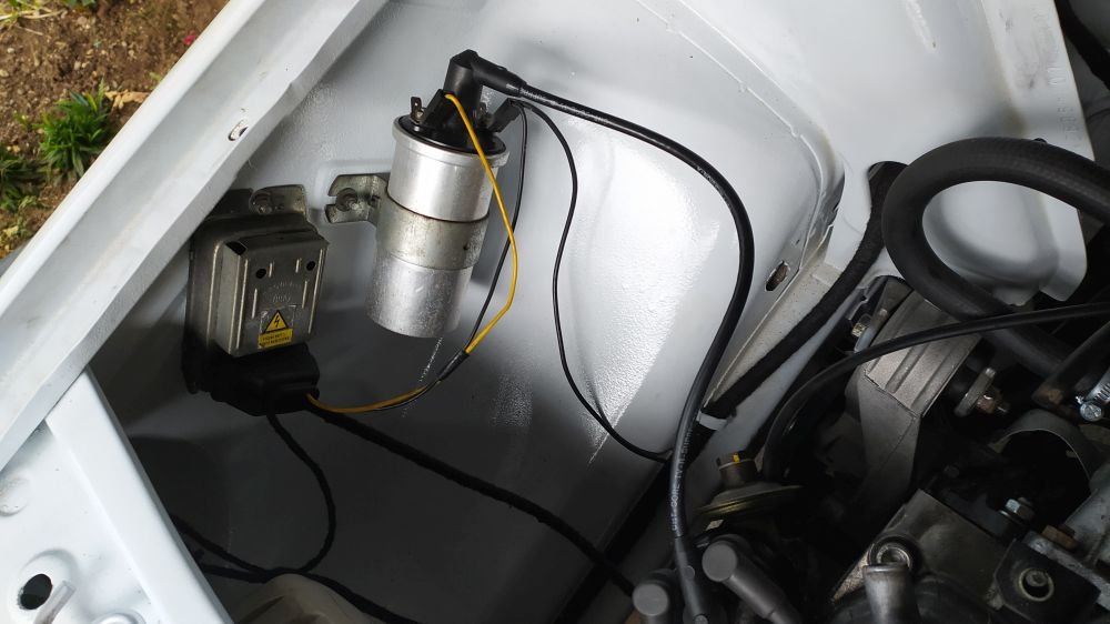

  1. Battery is 1 year old, 55Ah and it had this problem since it was new... in an ideal situation I would try another battery when I get my hands on it.
  2. I peeled back the insulation on the blue wire and the wires are great, I noticed when the wire is unplugged and ignition on it has 12v, as soon as I plug it onto the alternator it only has 1 volt?
  3. Took off the blue wire, rigged up another wire on that terminal and touched the battery 12v wire that goes on the alternator and it works, guess there is a short in the blue wire since the car also started pretty rough until the car started charging, doesn't happen if I don't hook up the blue wire. Going to run a separate new switched 12v to the alternator and problem solved then.

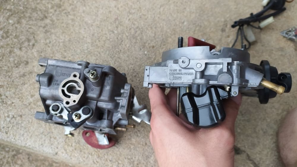

  6. Thanks for the info, I just find it weird because this never happened on my old Favorit and it was a really beat up and neglected one. I do feel like it is running a bit rich - black condensation from the exhaust and sometimes when I want to accelerate from a stop theres no response from the gas, kicks in like a second later.

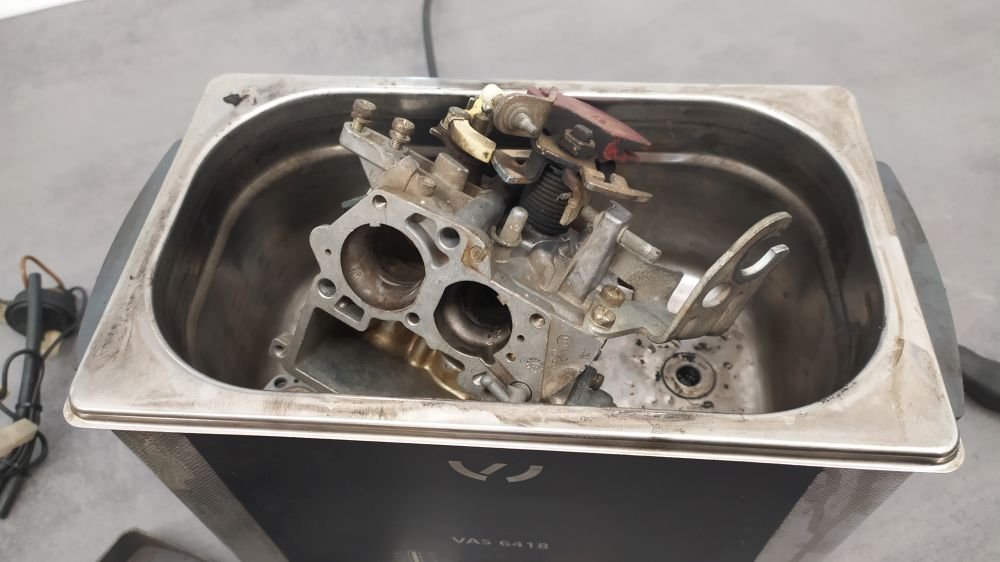

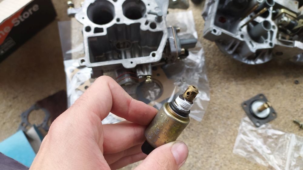

  7. So my Fav has been running good for a while now, drives good but I'm having a problem where it wont start hot, need to crank it for a bit and hold the throttle open for a few seconds and then it slowly starts up. I have replaced my carb base gasket again, got my hands on a metal plate one because the rubber ones just seem too sketchy to me. Also replaced the idle cutoff valve. If I drive it around and shut it off, it doesnt want to start up. Fires up cold no problem. Any ideas?
