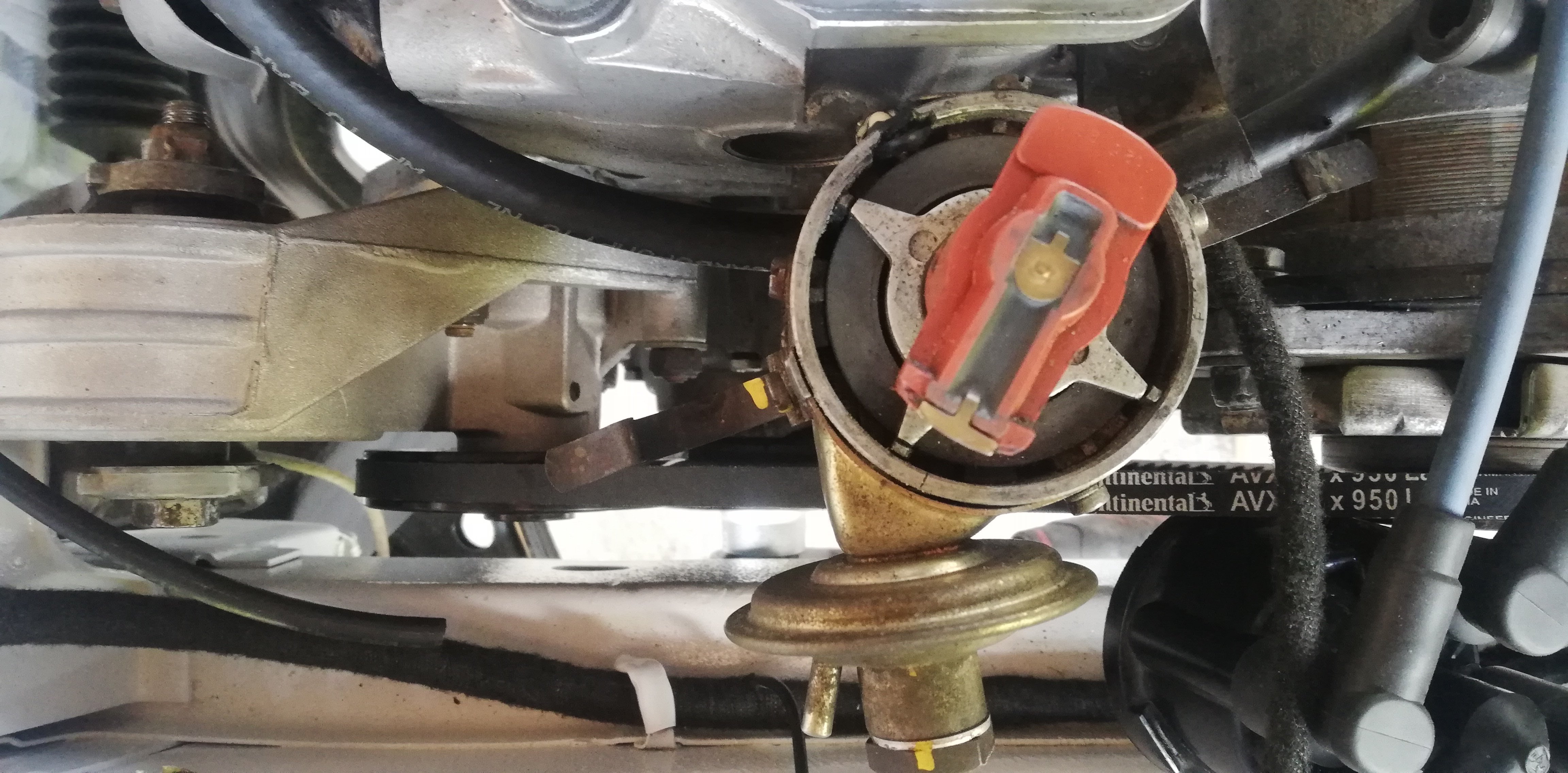

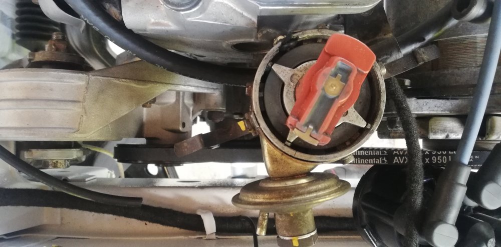

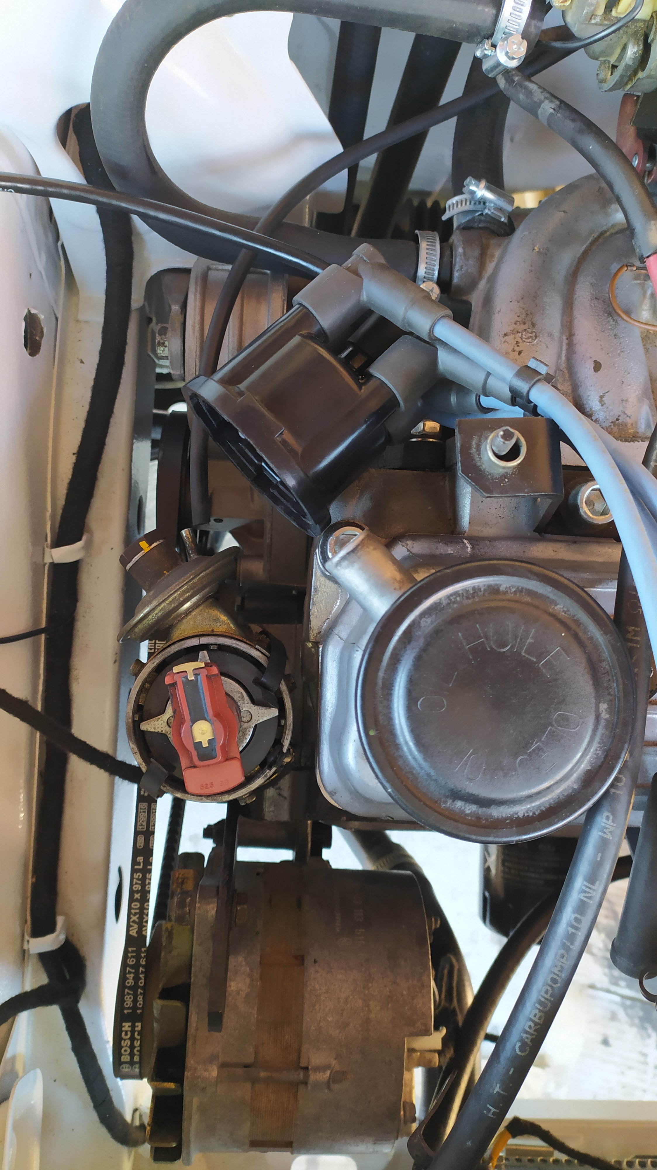

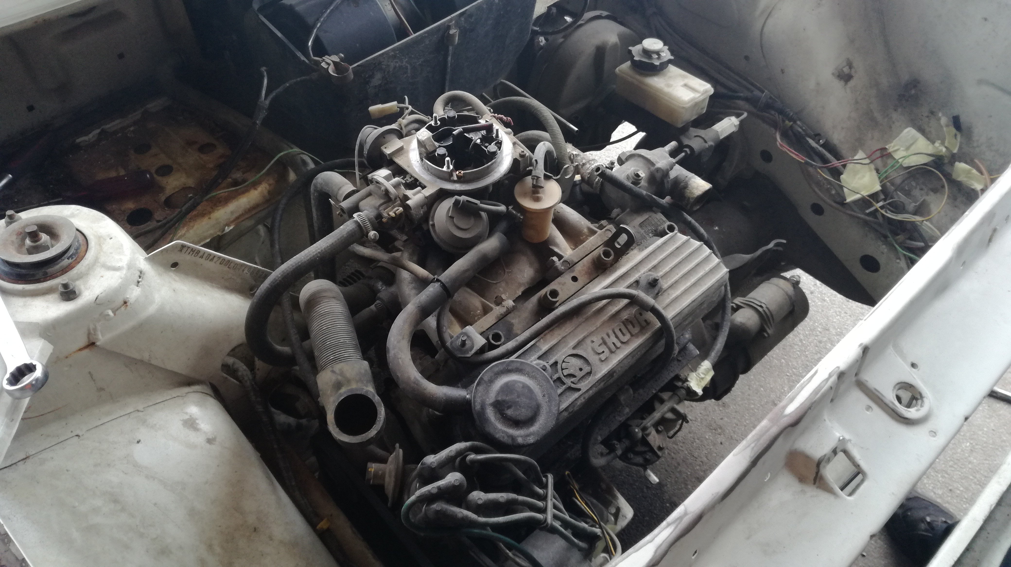

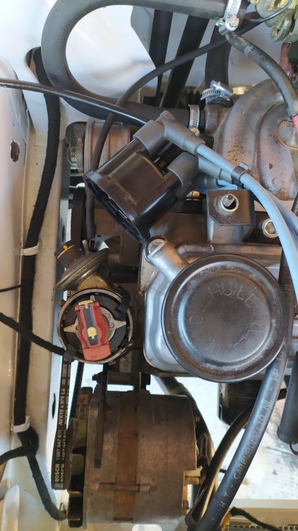

Hi everyone. I just put my motor back together after years of sitting, used to run fine but I wanted to regasket everything and I had to replace one cylinder. I didnt mess with the timing chain or anything but I did resurface the head, did the seats of the valves etc all of the good stuff. Now Ive put it back together and it wont fire up, it did sputter and backfire for a bit but now nothing. I pumped fuel with the manual pump and there is fuel, also took the feed from the carb off and when cranking there is fuel... but looking into the carb when cranking there is no fuel coming in? Also pumping the manual pump I could see fuel coming out the top of the carb for a while but now pumping manually does nothing unless I take the hose off the carb, then it starts pumping again. Also possible electrical issue? I think I have connected everything right, I put the distributor back on the way it was but even when the crank pulley is at 0 the marking on the distributor case is not aligned with the rotor arm? I do have spark. Thanks for any tips.
