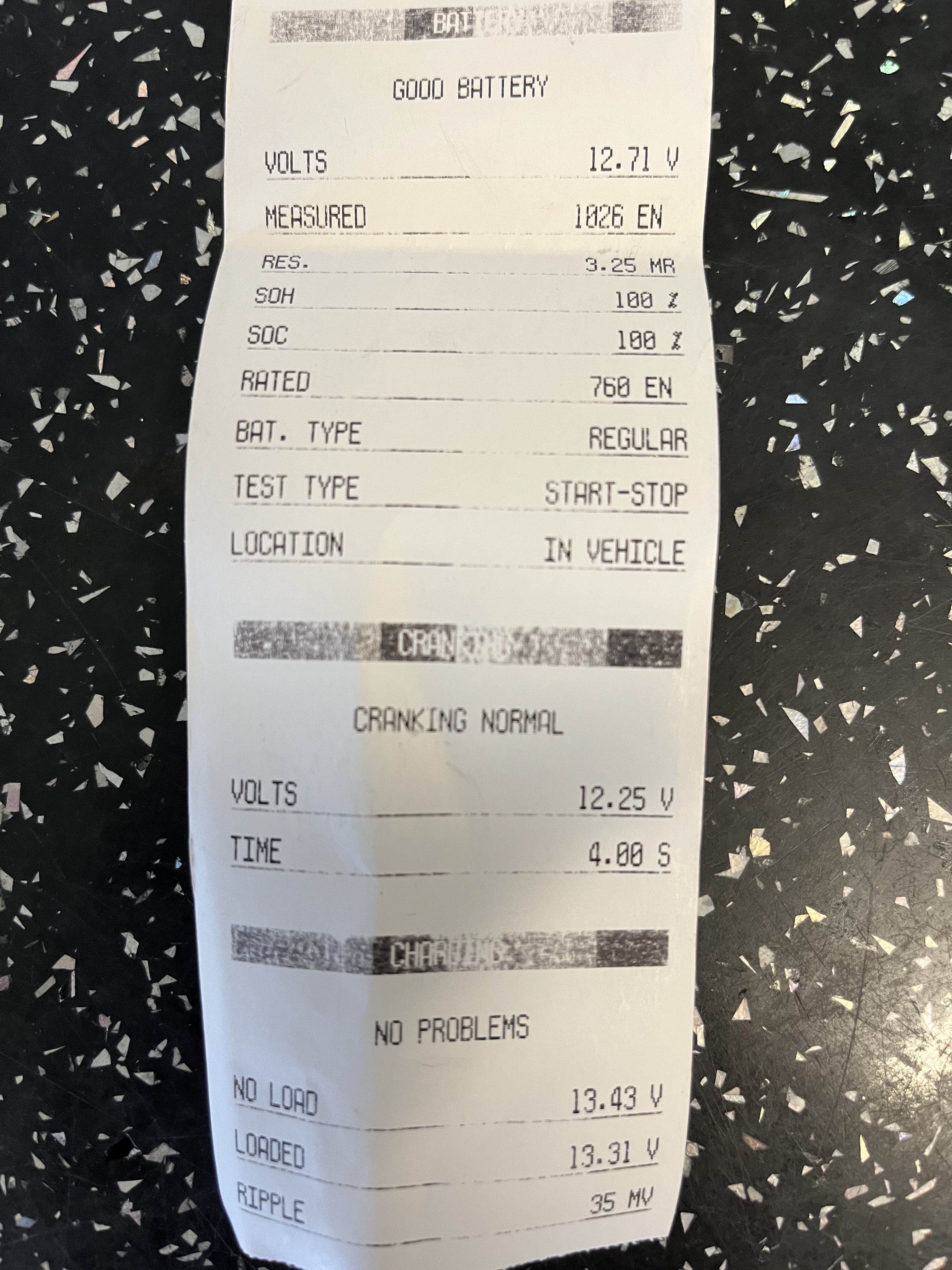

  7. I have a 1.6 tdi superb 2017. Starts perfectly when cold, but intermittently when the engine is warm, it will not crank at all. It will literally just make one click noise and then nothing. At this point the coil light will flash on and off. After about 30 minutes it will start perfectly. I am currently also turning off the stop / start as this was also not restarting the car all the time. I had a new battery fitted 2 months ago and in my mind all these problems started then. I have been back to have it retested and they say all is good. The report is below. Any suggestions greatly appreciated as it’s not an ideal situation for a taxi driver to be in.
  8. Sorry all for the delay in replying and thanks for all the help. Since my OP the car has performed ok, however I have been using the button next to the gear knob to turn off start stop each time I set off. Have also just got back from a driving holiday from Newcastle to Wales to Cornwall and back with no issues. However today it happened again when dropping off at Newcastle airport. Dash lights all seem normal, bower there was just a clicking noise. This is just instant and not the noise you get when a battery dies whilst trying to start. Also, the break pedal was very heavy to depress. Got a jump start, made it home and now starts as normal. The guy at the shop that fitted it, did connect a laptop and do something after installation. I have no idea what the previous battery was but it was fitted from new. Also just had a battery test report that seems to rule out the battery
  9. Sorry all for the delay in replying and thanks for all the help. Since my OP the car has performed ok, however I have been using the button next to the gear knob to turn off start stop each time I set off. Have also just got back from a driving holiday from Newcastle to Wales to Cornwall and back with no issues. However today it happened again when dropping off at Newcastle airport. Dash lights all seem normal, bower there was just a clicking noise. This is just instant and not the noise you get when a battery dies whilst trying to start. Also, the break pedal was very heavy to depress. Got a jump start, made it home and now starts as normal. The guy at the shop that fitted it, did connect a laptop and do something after installation. I have no idea what the previous battery was but it was fitted from new.
