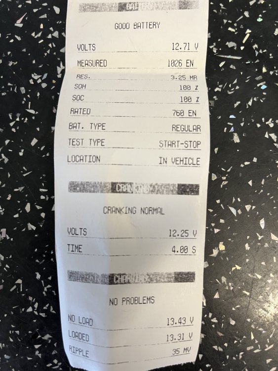

I had a new battery fitted 2 months ago and in my mind all these problems started then. I have been back to have it retested and they say all is good. The report is below.
Any suggestions greatly appreciated as it’s not an ideal situation for a taxi driver to be in.IMG_4562.thumb.jpeg.9add00b06f78b709be5aff34c50e40d9.jpeg
Any idea of the state of charge of the battery when the engine is warm?  Maybe its overcharging?  Was the new battery coded to the car when it was replaced?
Thanks for the reply. Yes it was coded and I don’t know about the battery being hot. However the problem is intermittent so I’m not sure if that rules out an overcharged battery. I’ve just spent a week driving around the country with no issue (even though this started before my trip), but now I’m back at work it seems to be happening every time the car has warmed up.
