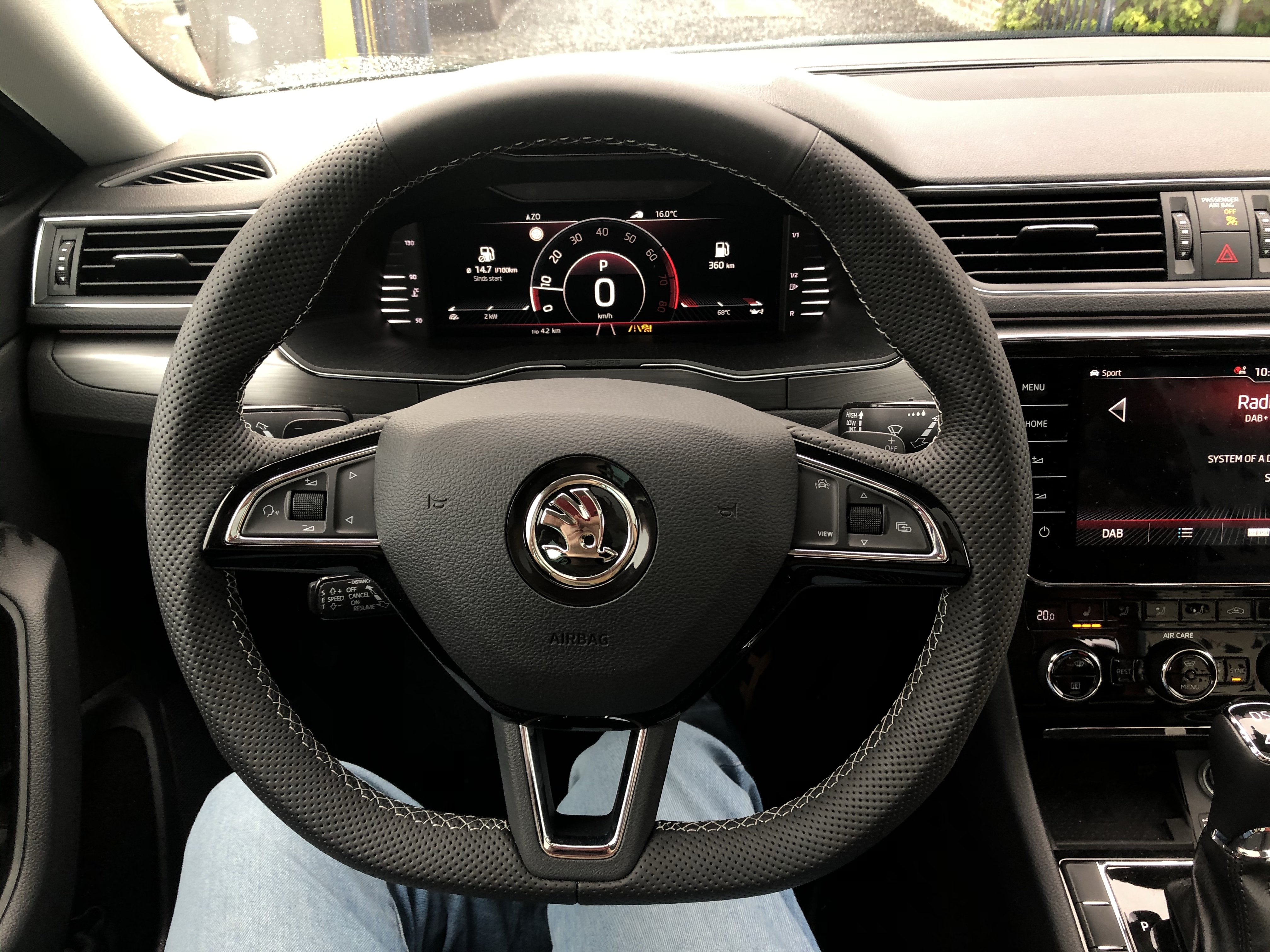

  4. How did you perform the update yourself? VCP or ODIS? And where do you get the files required? thanks!
  5. Whilst I can’t be sure about what is or isn’t missing in terms of coding on your car of course, the missing parameter for my coding was this: In control group 13, Adaptive Cruise Control, enable FPK_Functions via Adaptations. That was basically it for my car. Let me know if this helped you out @RomanB
  6. I’m wondering if somebody has come across this and knows the answer. I’ve got VCP at my disposal, but I’m trying to find a solution that doesn’t have me mucking about in all the different adaptions and control modules. If it comes to that, I guess it’ll have to happen. Anyway, on to the problem. I’ve had a Virtual Cockpit retrofitted in my MY2018 Superb. It’s been working flawlessly, with a single small hiccup. The ACC itself works as intended and keeps the distance it’s supposed to, however the display in the instrument cluster does not work the way it should. Whenever the car detects a vehicle in front, it will always display it as being at the closest possible option (it displays as if you’re tailgating), no matter what the ACC setting “underneath” the car symbol is. In other words, the car in front doesn’t get closer on the display as you’re approaching it, it’s either there at the closest possible display value, or not there at all. Anybody with a clue where I should go looking in VCP/VCDS to get this functional again? Thanks!
