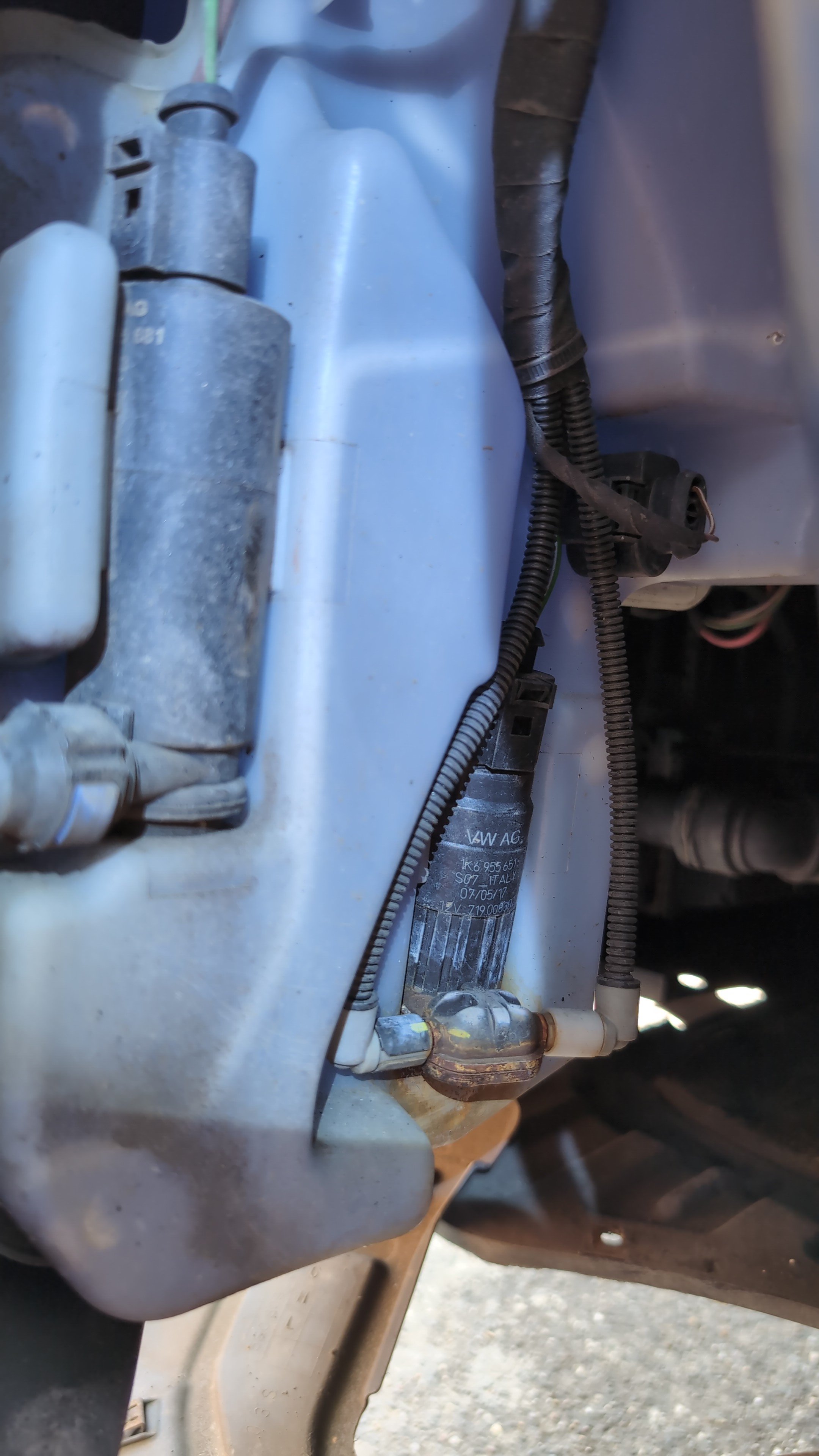

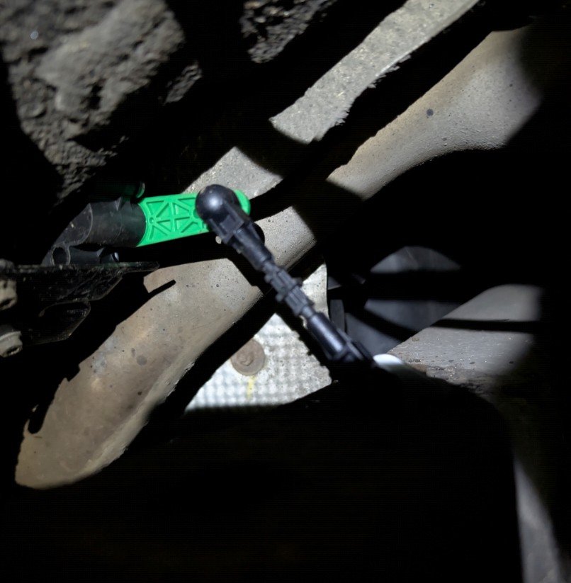

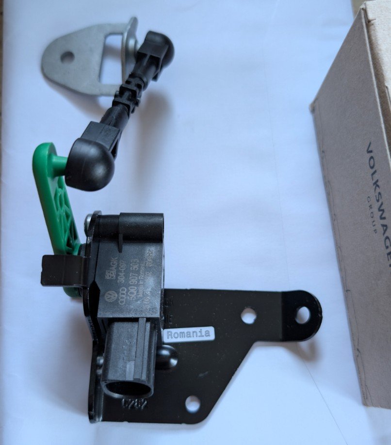

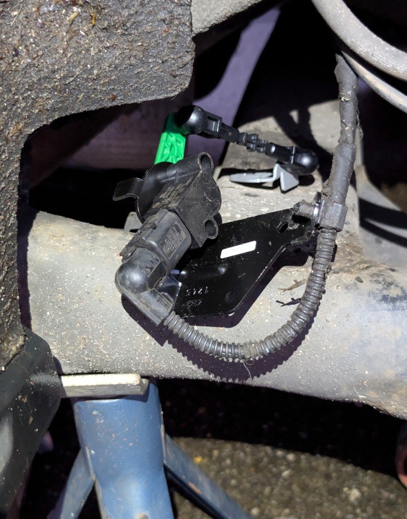

Update. . . . I managed to get to the local dealer and we were able to identify the part, it is the full assembly so I got it on order last Saturday, but the guy was new and couldn't work the till, so another chap called me on the Monday and as I had to pay on order they sent me a link and £242.40 was transferred, they called me two days later saying it had arrived. I picked it up today and decided as I'm now off work I'll get it fitted. It was a bit of a faff with the car up on one axle stand, but I removed the ns rear wheel, a short section of undertray and it made it quite accessible, using a stubby screwdriver and torx bit I got the old one off and the new one plugged in, bolted in place and the undertray refitted etc. A few pictures below. Notice it's a VW part, no wonder it was so expensive 😂 Started the car up, the headlights did their little dance up and down and no error on the screen, so a winner. The old one was seized up good and proper, but after 8 years and circa 108,000 miles I don't think it was that bad.

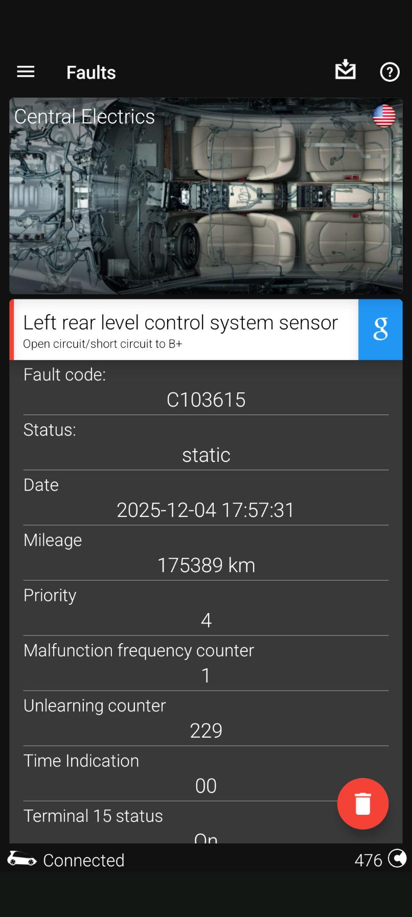

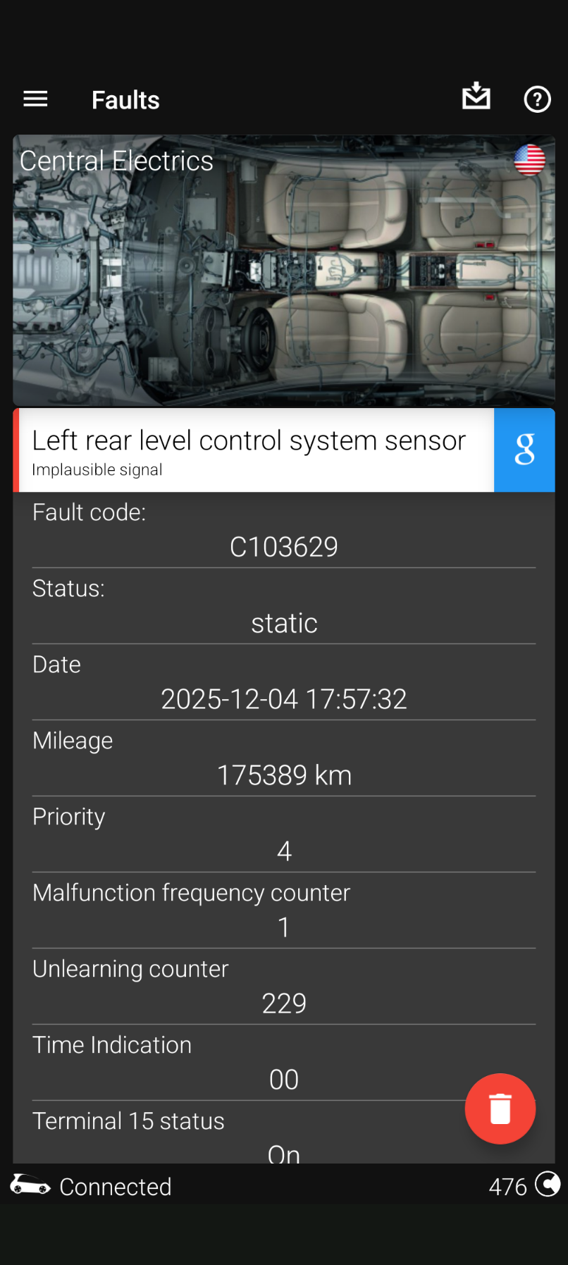

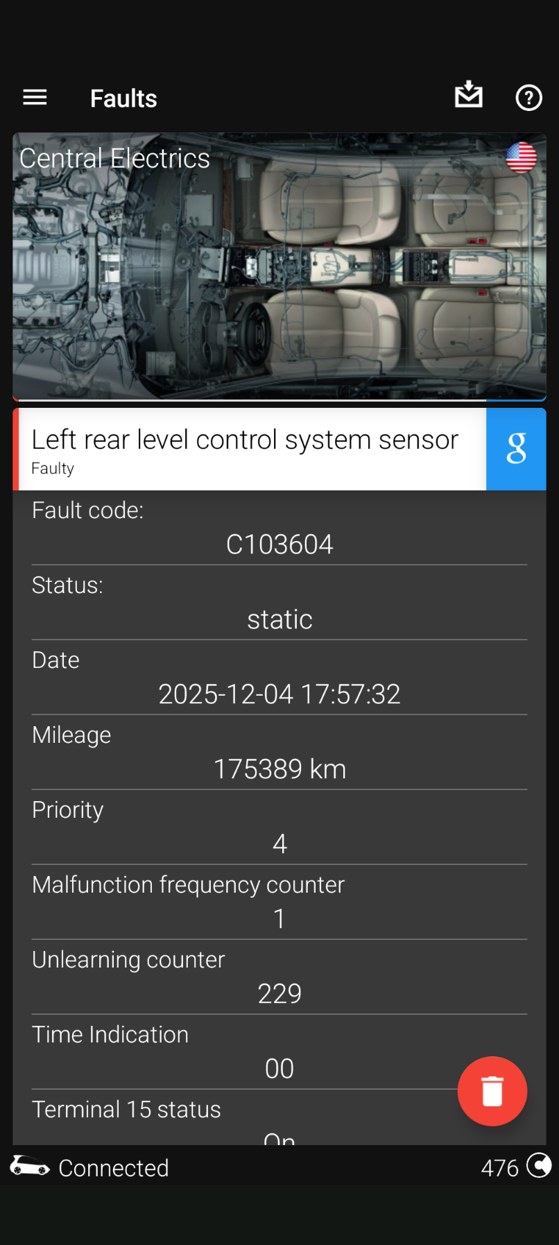

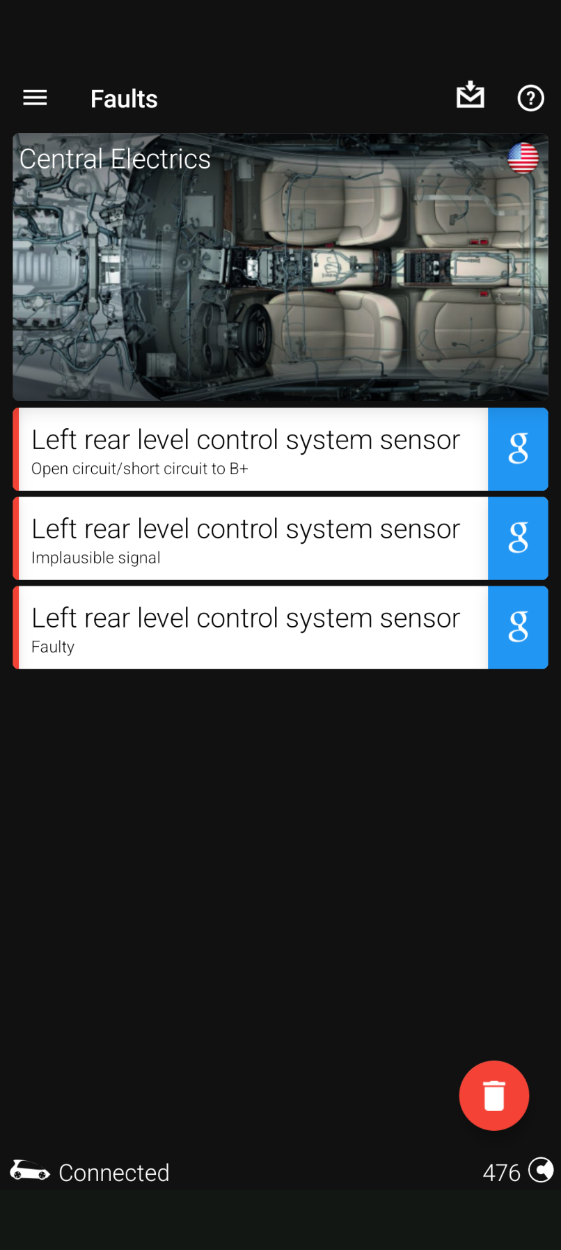

I've finally got around to plug in the OBDeleven and there were 10 faults, and unfortunately I reset the lot of them but this fault came straight back, in the central electrics section. I've added some screenshots as there's 3 faults and it seems to be a module or sensor that is grounding out. . . The task I think is going to be locating the part and seeing if I can get a replacement.

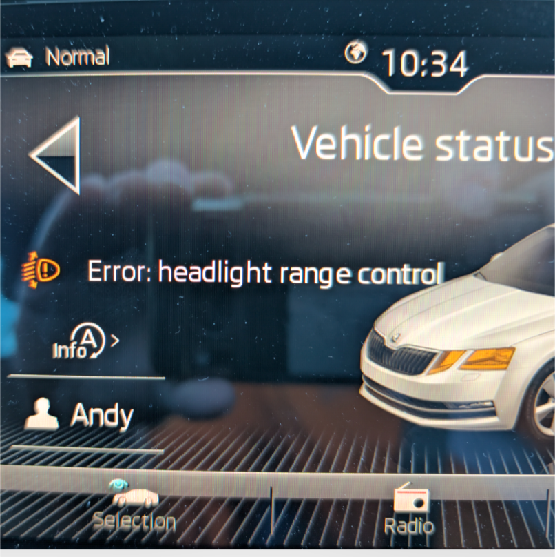

I've started getting this error message while driving and it will disappear after a few minutes then a little later it will be back again, has anyone else had the same issue? Is it easy to fix? It's on my 2017 Octavia estate 2.0D SEL it has the full LED lights Thanks in advance. . . .- Adjust speed at which headlights change to main beam

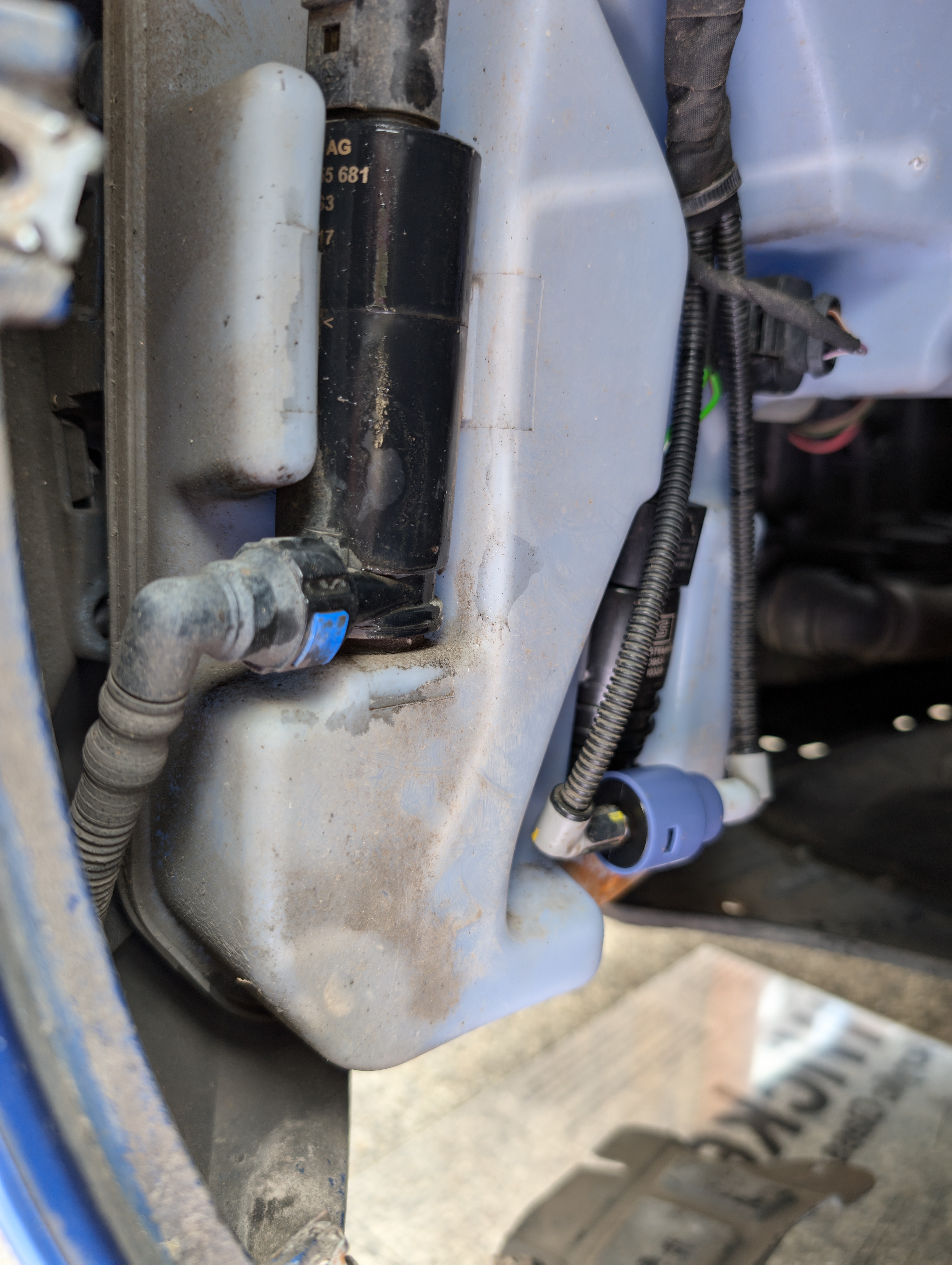

Quick update to say that the replacement pump from ECP has done the job, the front and back washers are both working again. The pump came with a new rubber grommet/seal fitted and I noticed that when I fitted the pump with the seal on the pump it didn't quite seat all the way down, so I drew it back out, took the seal off the pump, fitted the seal into the hole in the bottle, then fitted the pump into the seal and it was all nice and flush. I've added a picture and I'll be checking with ECP and the dealer for availability and price for the headlight washer pump in case that starts acting up. Thanks again for your help 👍- Washer bottle pump/s
