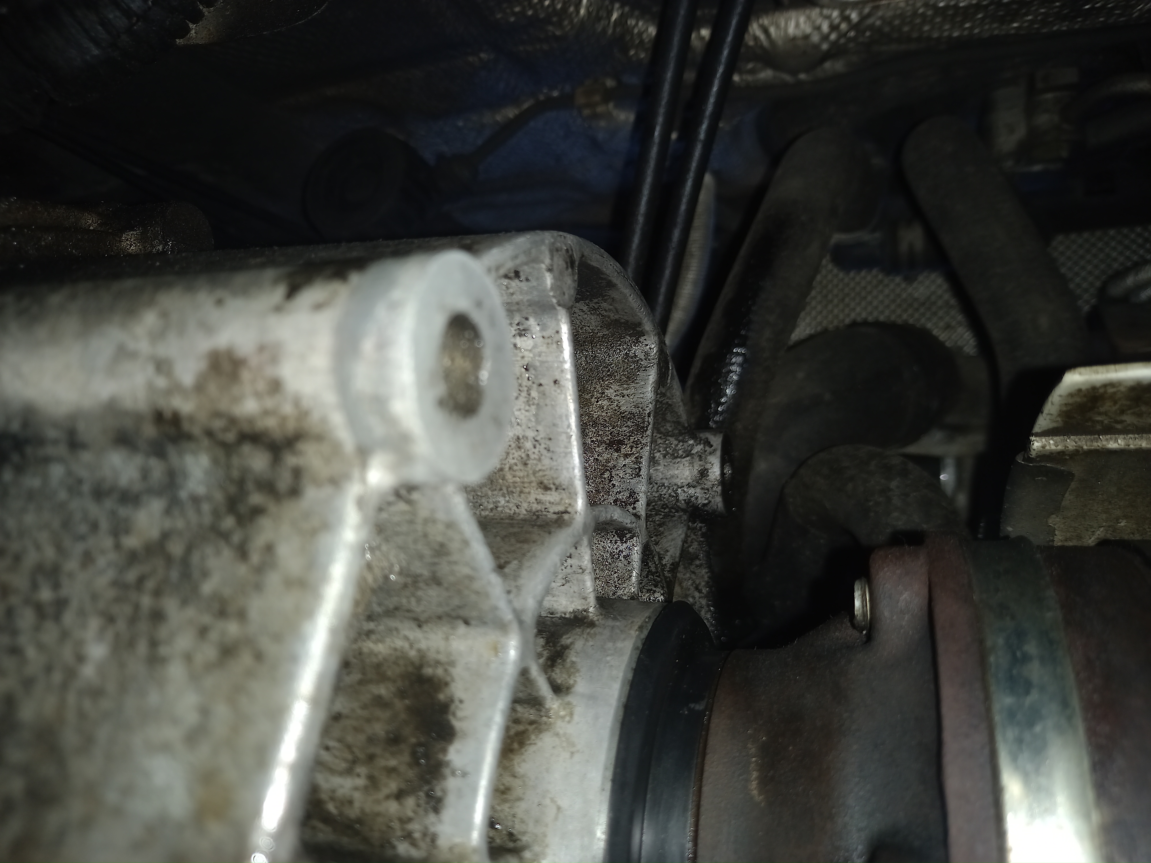

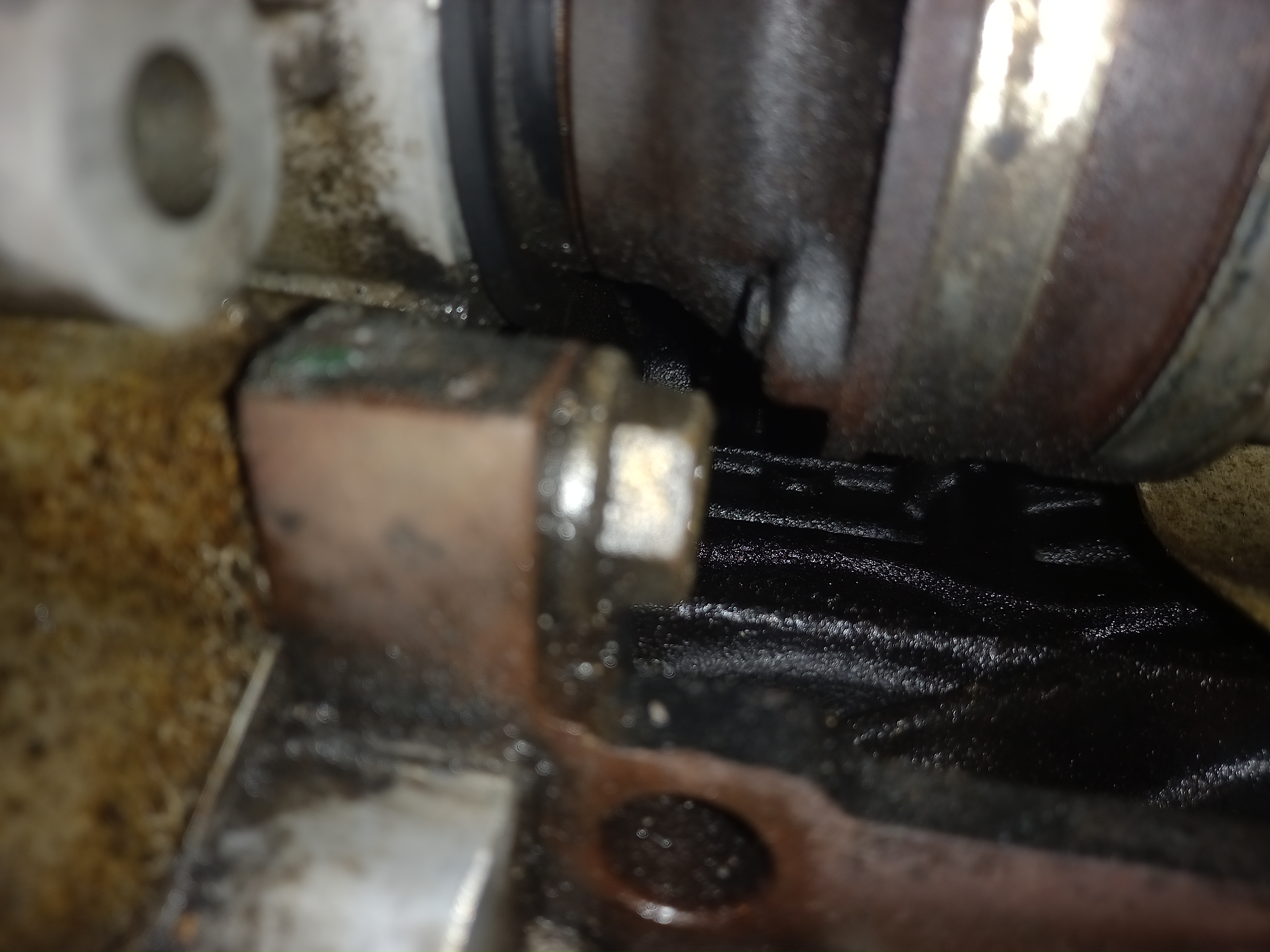

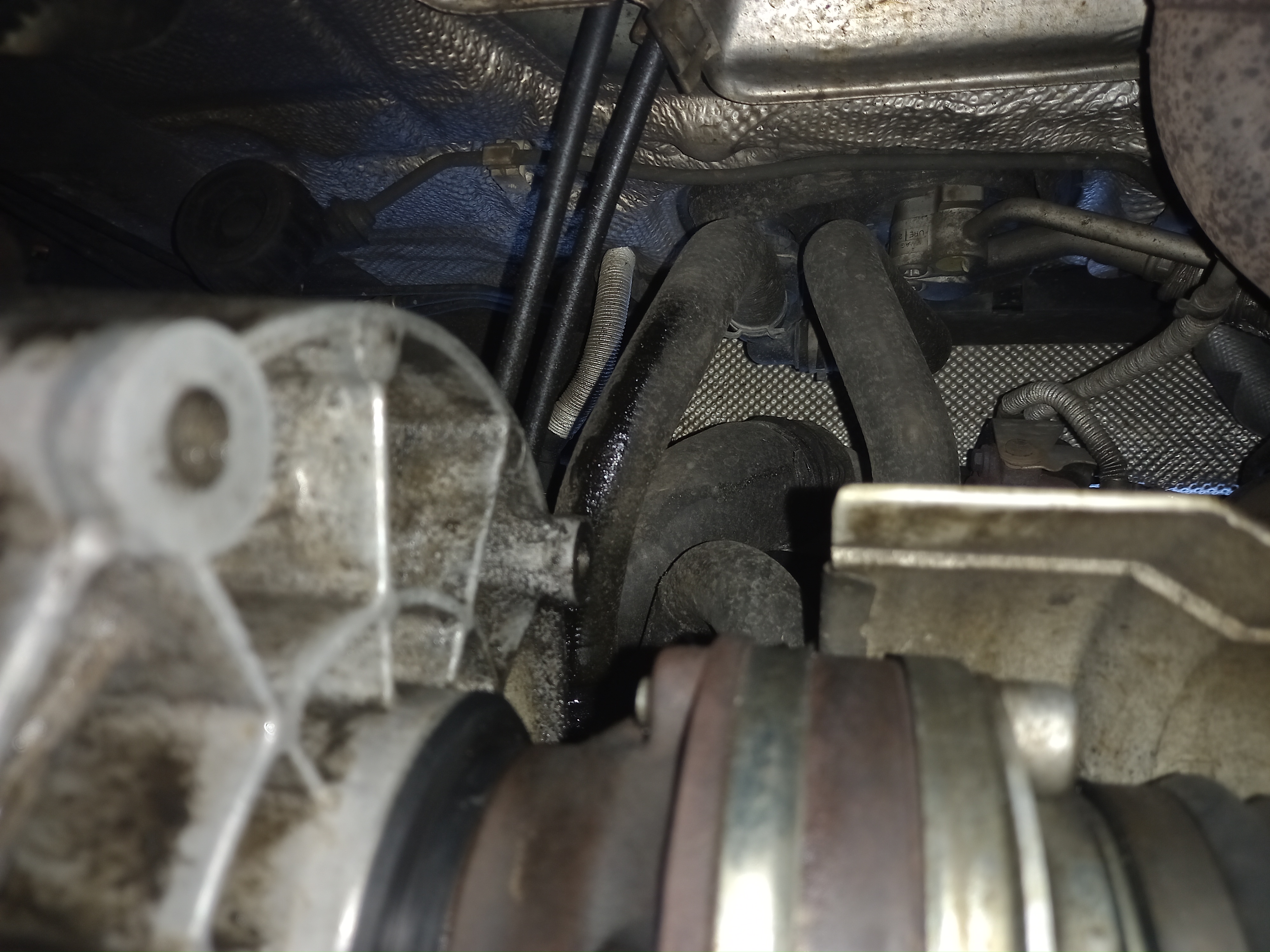

  12. Hi, I've a 2007 VRS Estate Diesel. It has a leak which I think is from the gearbox as the oil seems too clean to be from the engine. Driveshaft oil seal is my only thought, but I am no mechanic. There was some oil further down and around the driveshaft, which I've cleaned off. Any ideas welcome. Wyn
