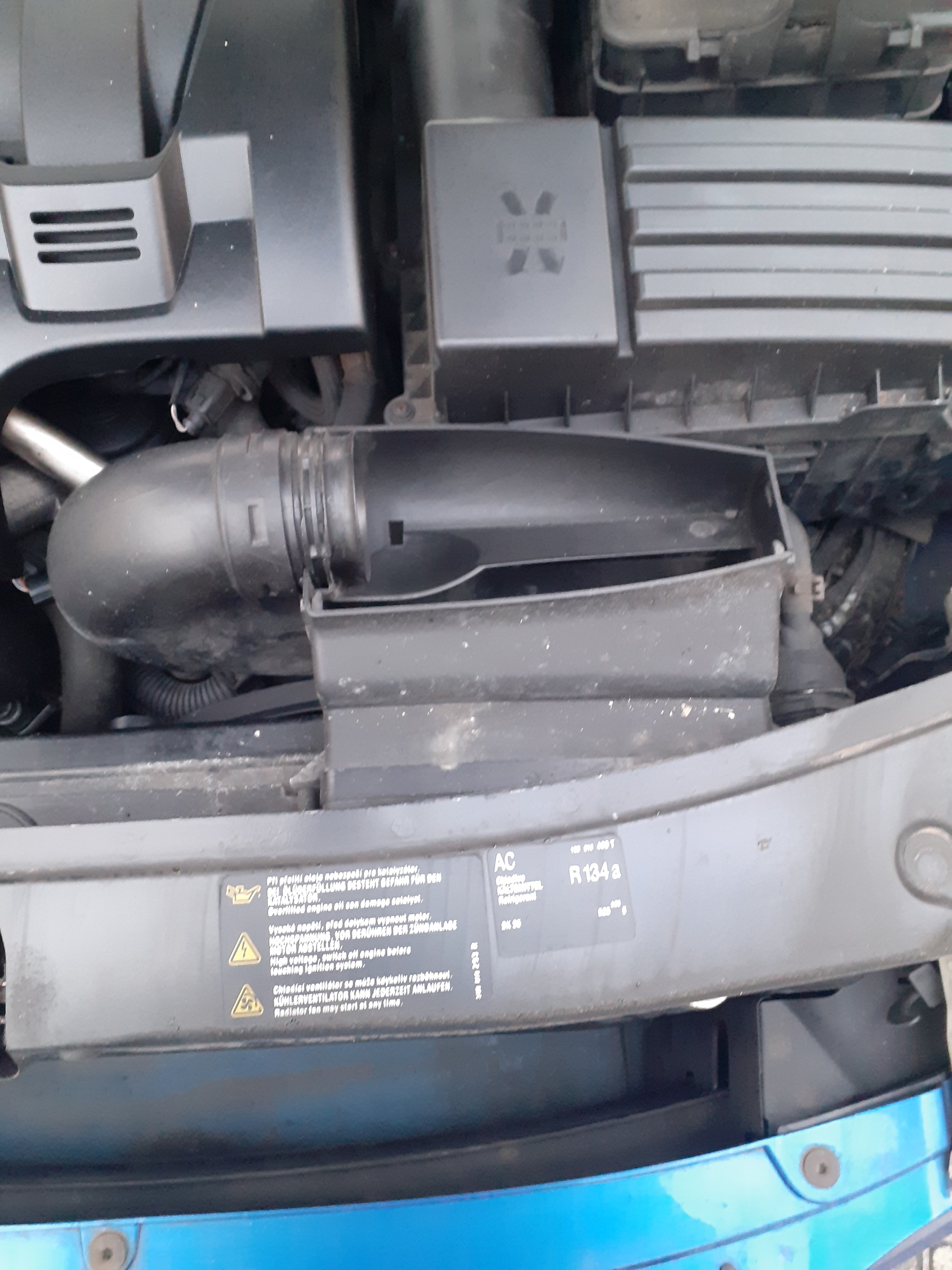

  18. Hi I'm hoping you can help me. ? Something is missing in the photo. Do I need it ?
