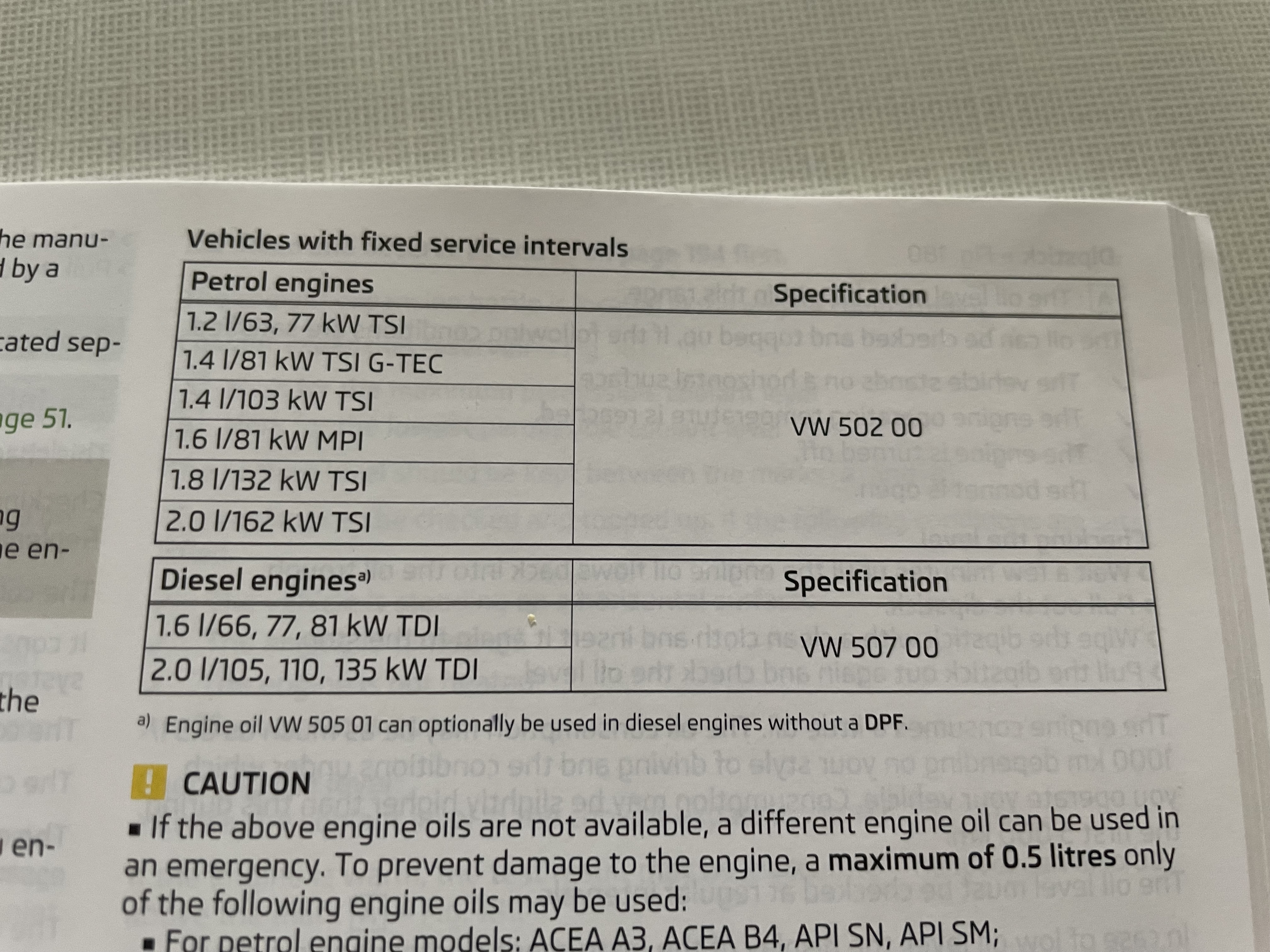

  7. I should have had a closer look in the handbook:
  8. Sorry if this has been asked a thousand times, but do I really have to use Long life oil? The car will annually doing 6,500kms so I plan to service it every 12 months. Should normal Castrol Edge 10w30 be ok? Or should I really use Castrol Edge 10w30 LL?
