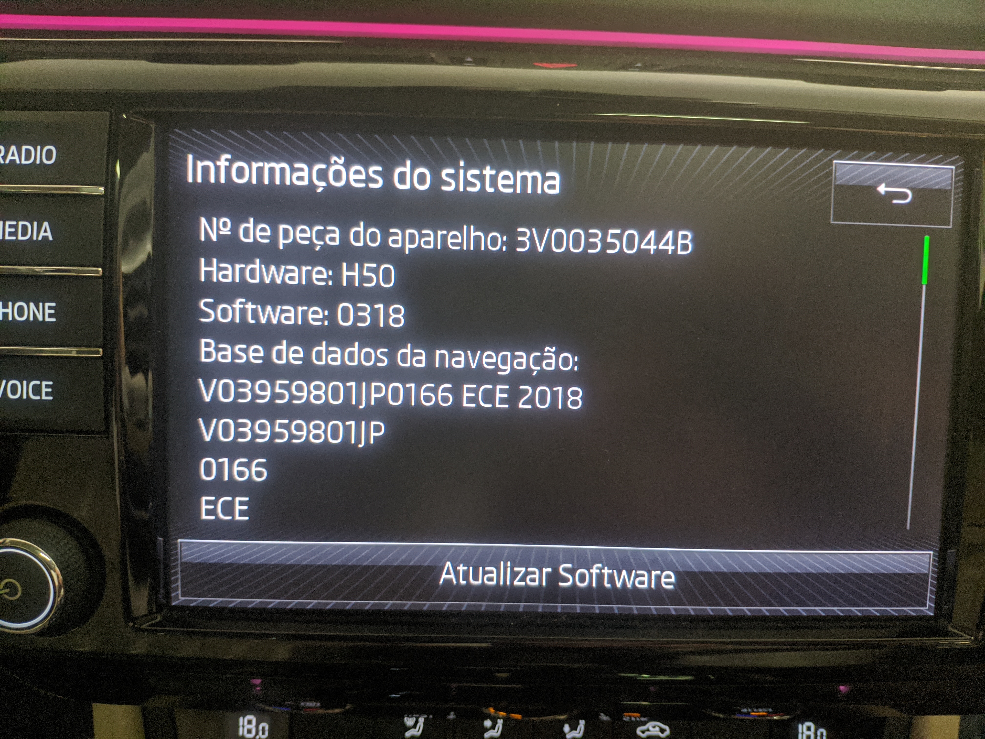

  1. Did you decompress the file and copy the contents of the resulting folder to the SD? Using slot 1?
  2. Yes, you are... That's not how you update the firmware. For that, it depends on the unit, but usually you have to press menu key for some seconds until the option to update appears...
  3. You must decompress that archive and copy the contents of the resulting folder to the card
  4. Sorry if I'm posting in the wrong thread, but I have a Superb 3 and would like to update the Columbus mib2 (I'm having problems with android auto)
