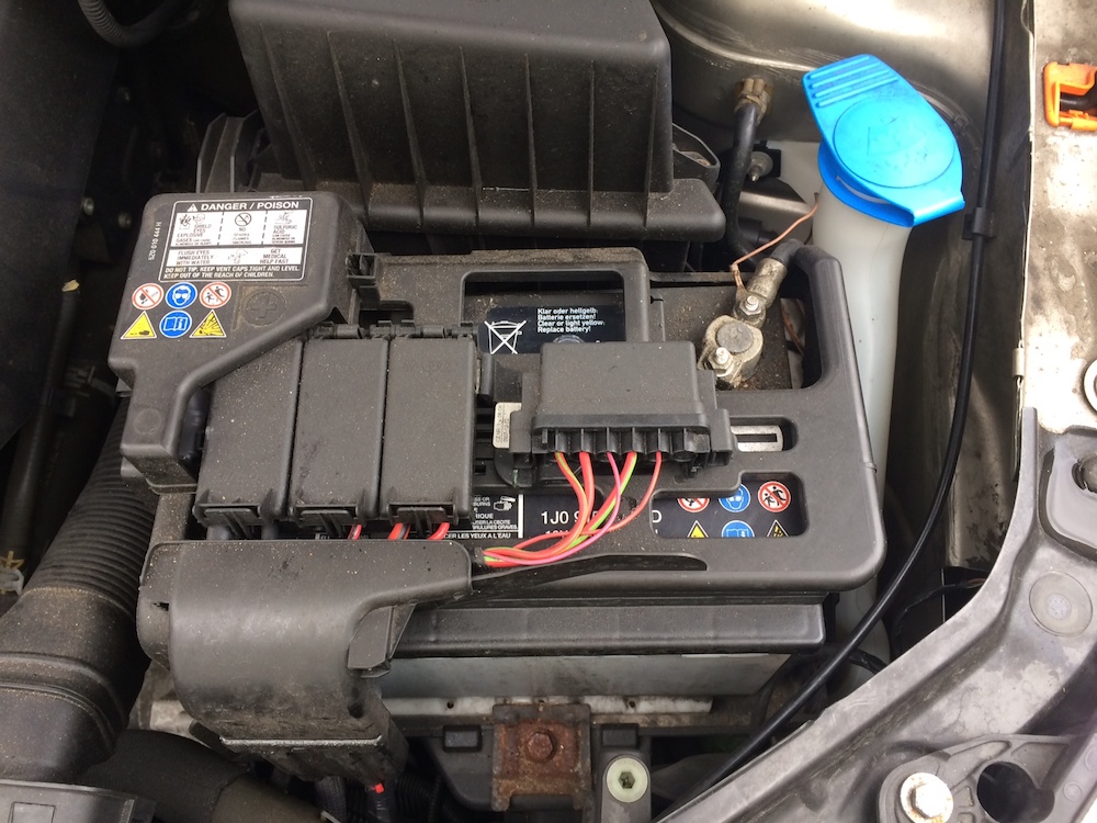

  2. Excuse me for the late response. This is a random photo from the internet. My battery is an Exide Premium 64 Ah. The terminals are clean and is no problem with them. The battery with engine - 12.6 v The alternator with engine running - 14.4
  3. Can you draw in this picture where should i take a look? Thank you!
