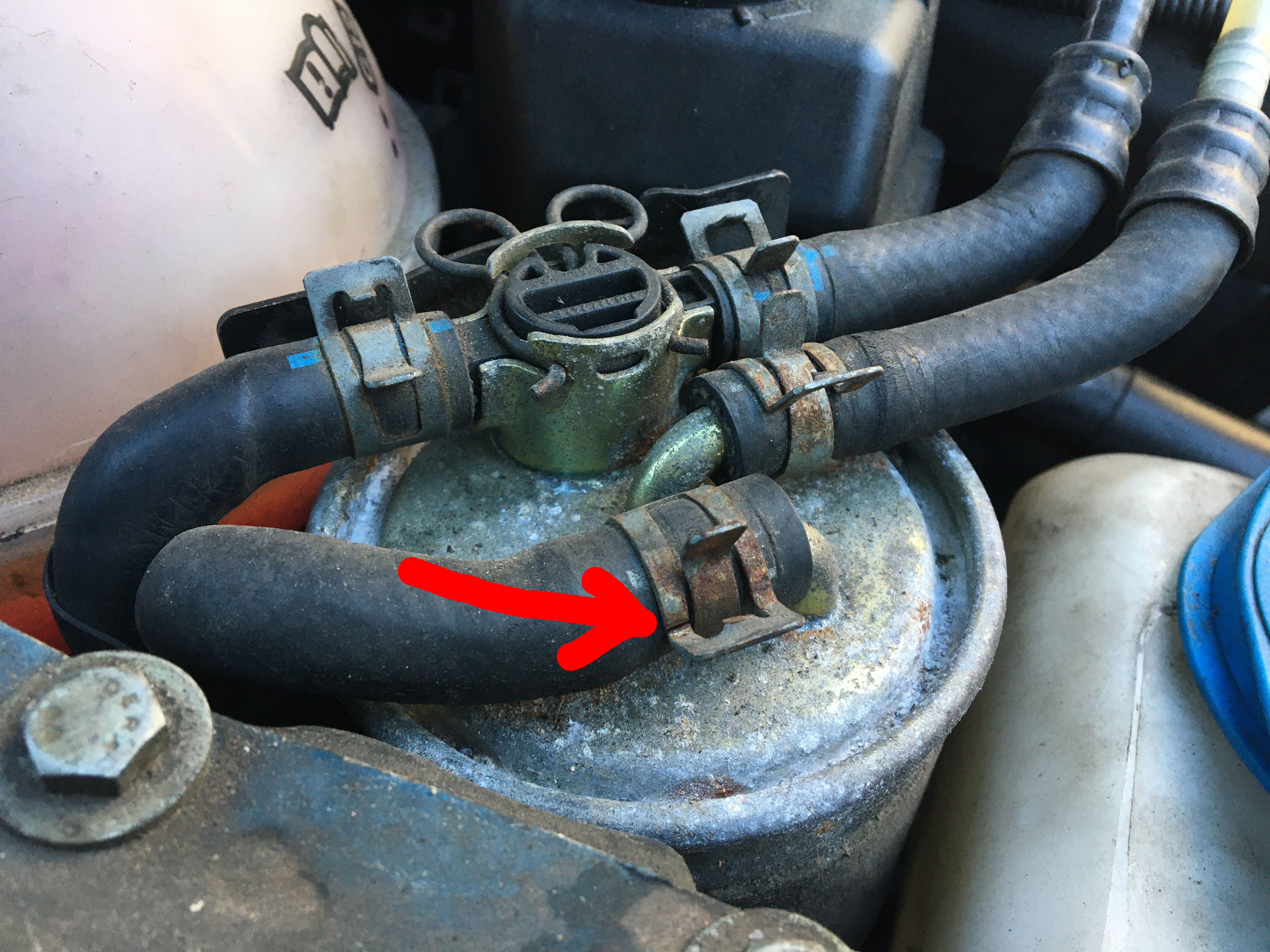

  4. For anyone else reading this, turns out the Haynes manual actually recommends replacing the original clips with worm drive clips 'of the correct size'. So I guess either works
  5. Brilliant - have ordered one. Thanks a lot!
  6. Just about to replace the fuel filter, but I noticed one of the clips has sheered at some point (photo attached). Does anyone know the where I can find a replacement? Thanks!
